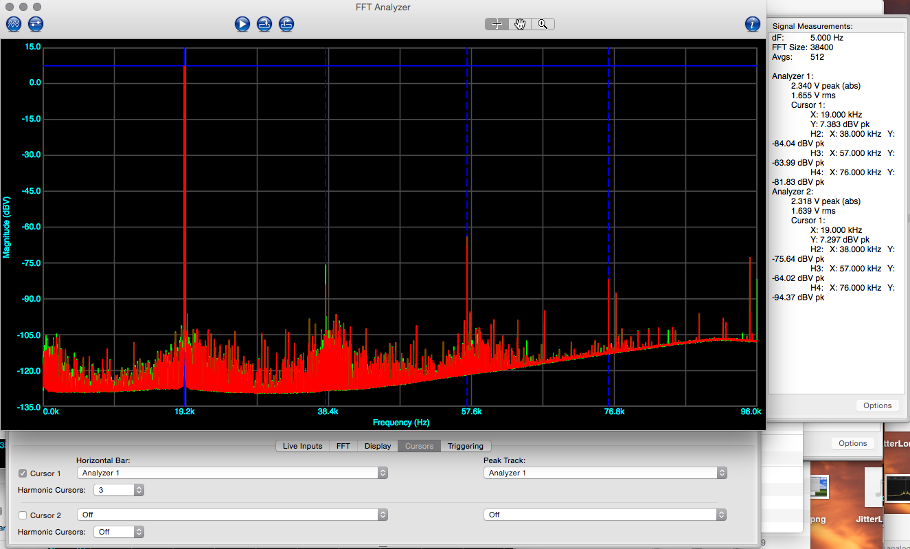

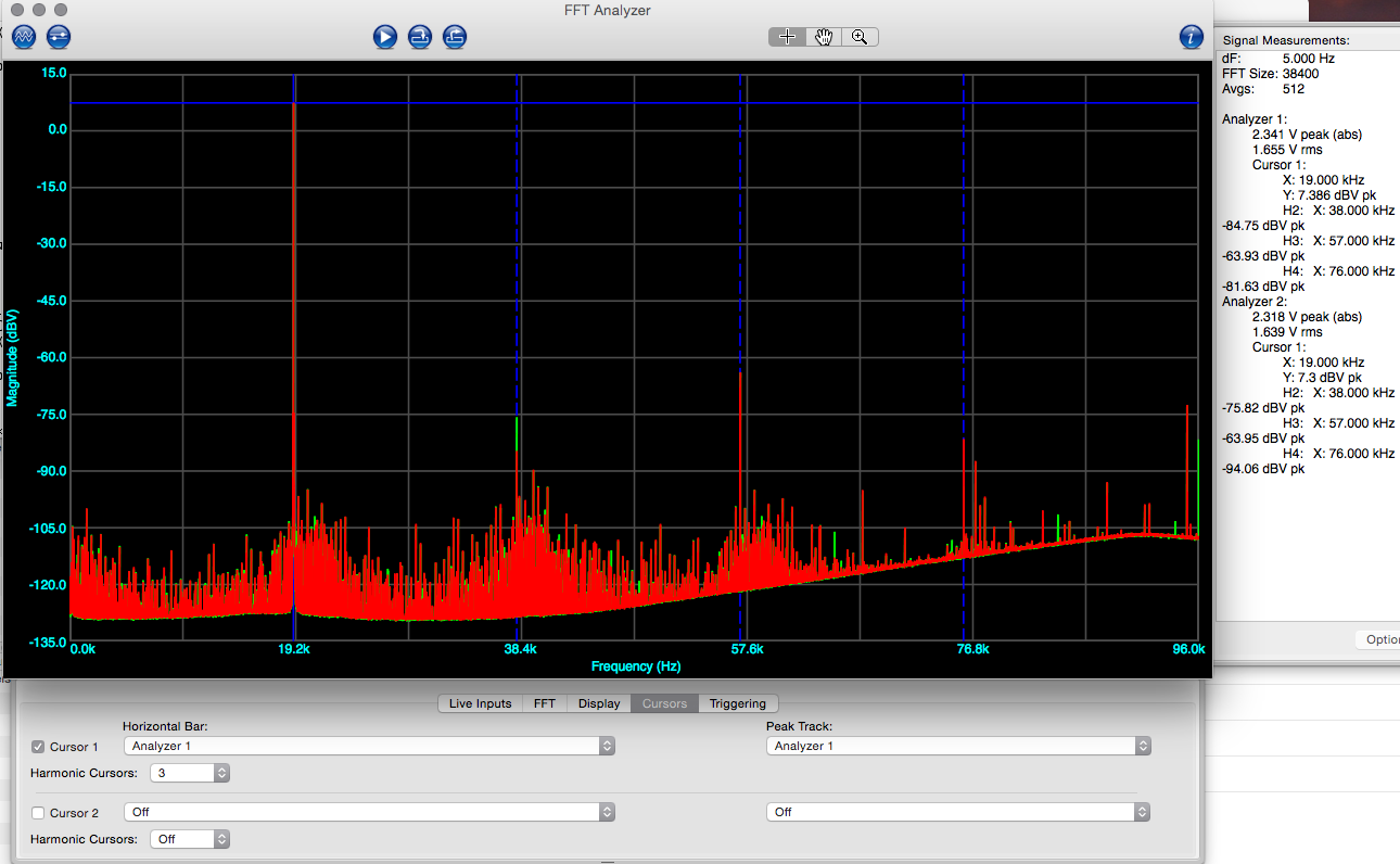

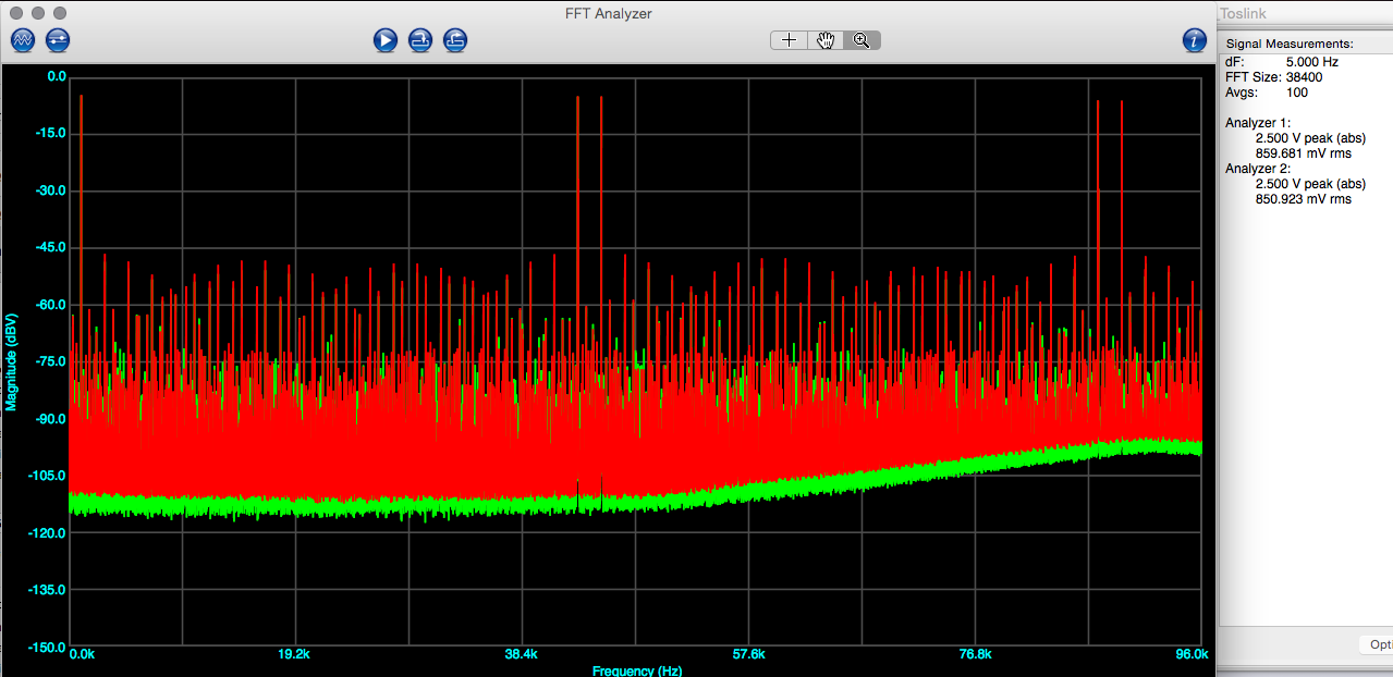

The second test is a 19K test tone. Again no calibration, this was just set to the same level as the white noise.
Same order of appearance as above.
MB1 is a bit cleaner in the audio band than Søren filter. The MPSRO shows the obvious image at around 24kHz which is not present in filters with steep roll-off for anti-imaging. It's also has a lot more junk in the audio band. It's worth noting that the worst case additional junk is around -80dB on the test tone.

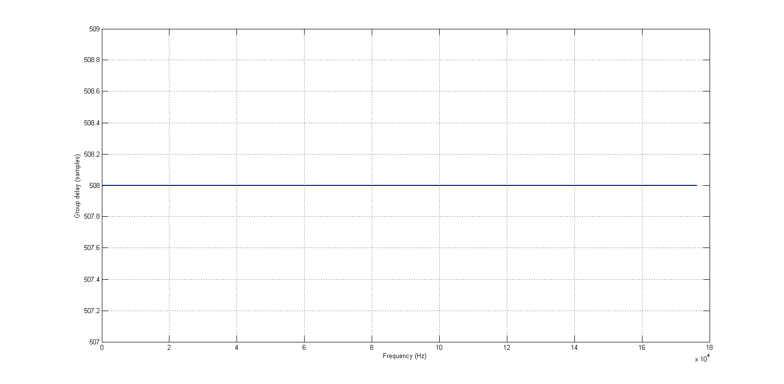

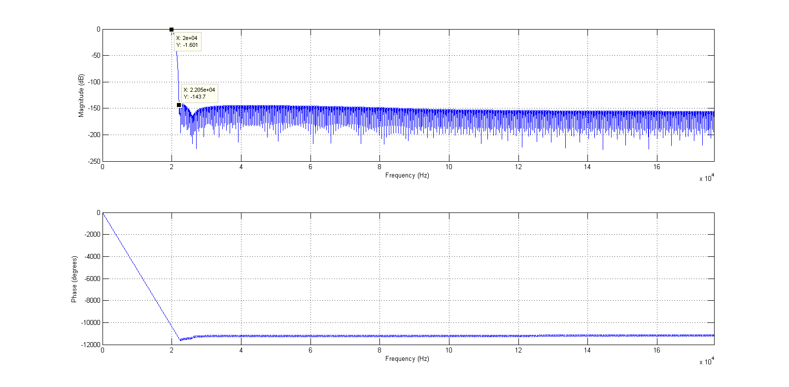

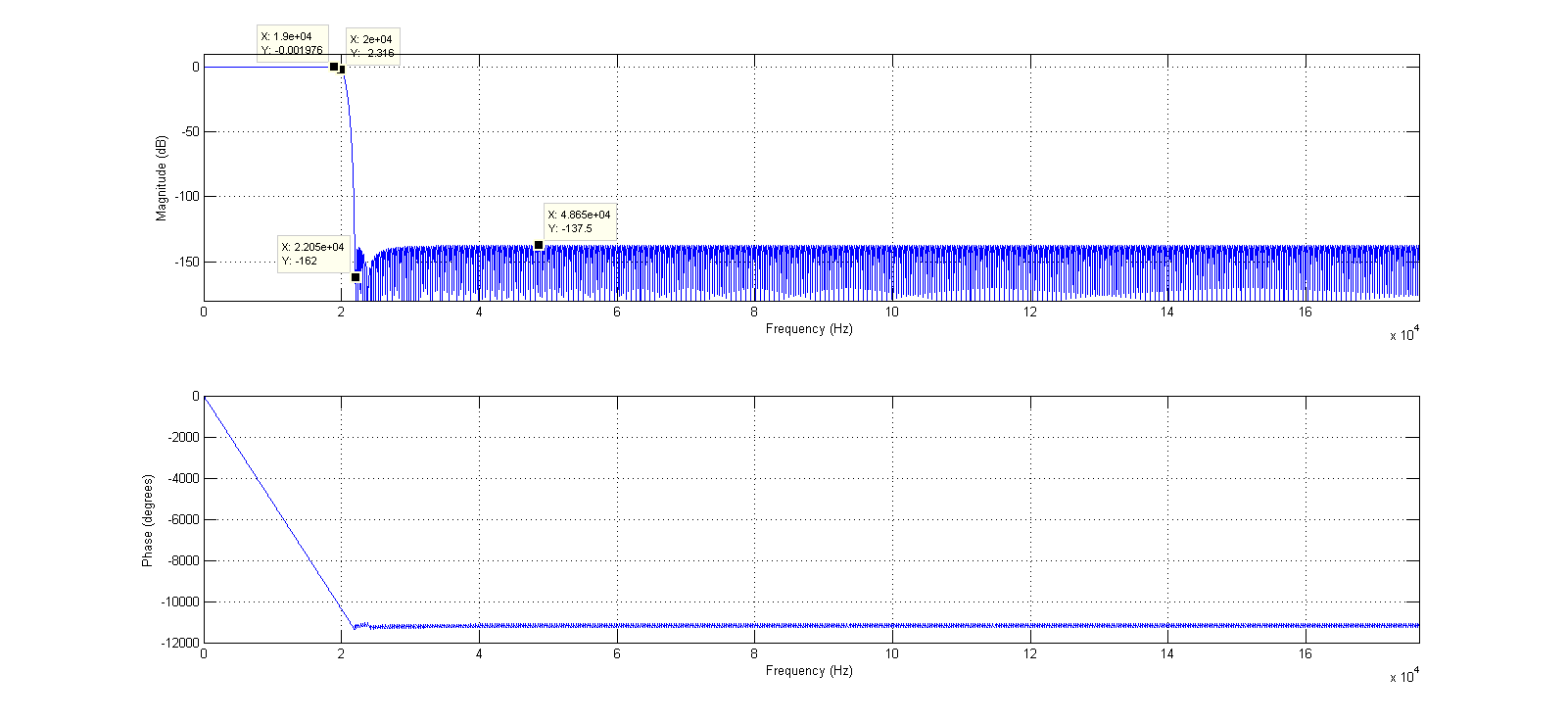

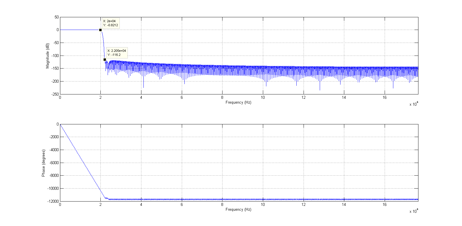

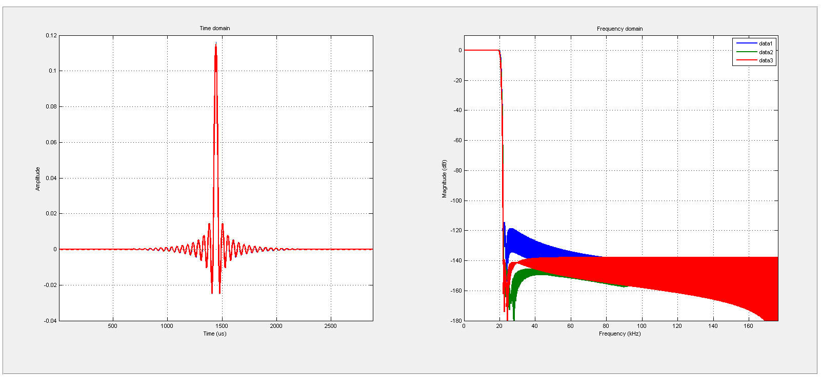

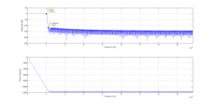

These 3 filters are all steep. They are also symmetrical i.e. they have equal pre and post "ring" around a pulse.
MB1=nuttall - data1
MB2=Taylor - data2
MB3=Cheby(chev) - data3
In the pulse plot, all three are actually in there in one and the same plot.

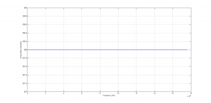

Group delay over frequency (derivate of phase) is constant for all three filteters - only one shown. These should have excellent time coherence or as usually expressed "phase correct".

Thanks to Mikael B for designing these filters which he says are all text book filters with a little tweak with windowing.
Filter thumbnails left to right - MB1, MB2 and MB3

Ok so those filters are basically brickwall filters (so called "windowed sinc"), using 3 different windowing algorithm.
This is the simplest possible LP filter design you can do with FIR.
The final shape (steepness and ripples "floor") is dictated by the chosen window.
Similar design to what Soren originally did use, but with more taps which allows for steeper slopes with the same ripples floor...
Attached is an example you can play with (choose different windowing algorithms and generate to see the resulting curve, and also maybe change the filter frequency).
Those that work well in this context are Nuttall, Blackman-Nuttall, and Blackman-Harris.
I don't have Taylor and Chebychev windows in rephase so cannot try these, but I can add them for the next version.
Funny thing is that people wanted a shallower slope and no preringing, but now the steepest linear-phase (ie tons of preringing) filter is preferred ;)

Of course measuring and listening are two different things ;) It was partly to see what was happening on the outputs and how close it matched the filter curves.
I still like the slow roll-off / little ringing better for listening.
