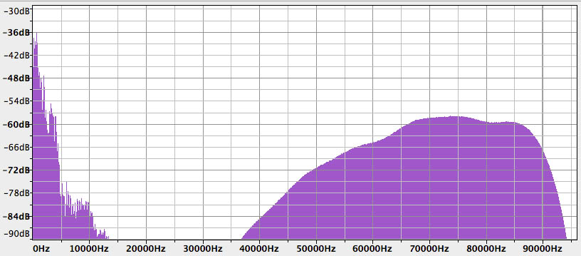

In my opinion the passband for the higher sampling rate (88,96 and up) FIR1 filters should also only be something up to 20kHz while the stopband can be at higher frequencies than for the 44/48 case. At least I would wish such a filter set as option.
I think the main benefit of the higher sampling rates is that it makes live easier for building nice filters (as well for recording as for playback). All of my high sample rate recordings, I have looked at, have no content above -90dB from 18kHz, or at most 22kHz, on upwards.
... unless they are (or seem to be) converted DSD recordings which have a (noise) signal reaching higher levels above 35kHz again:
