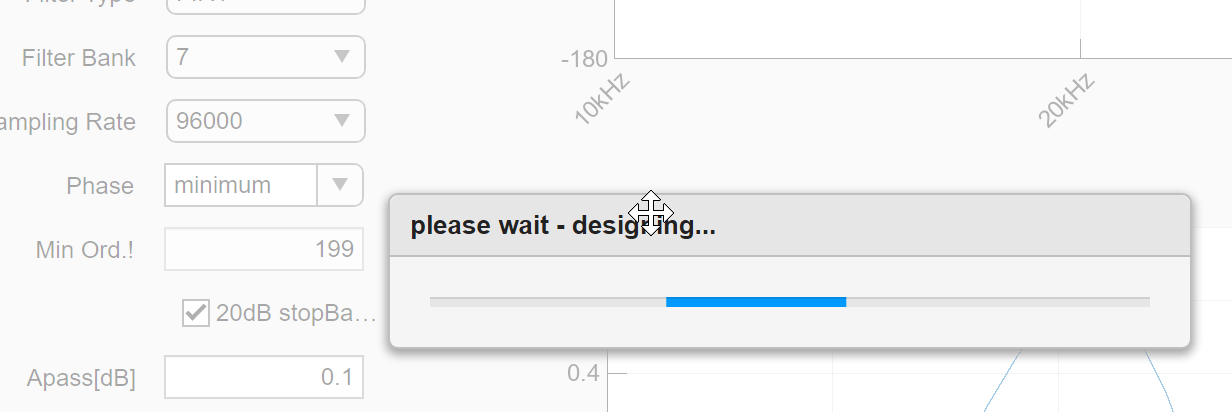

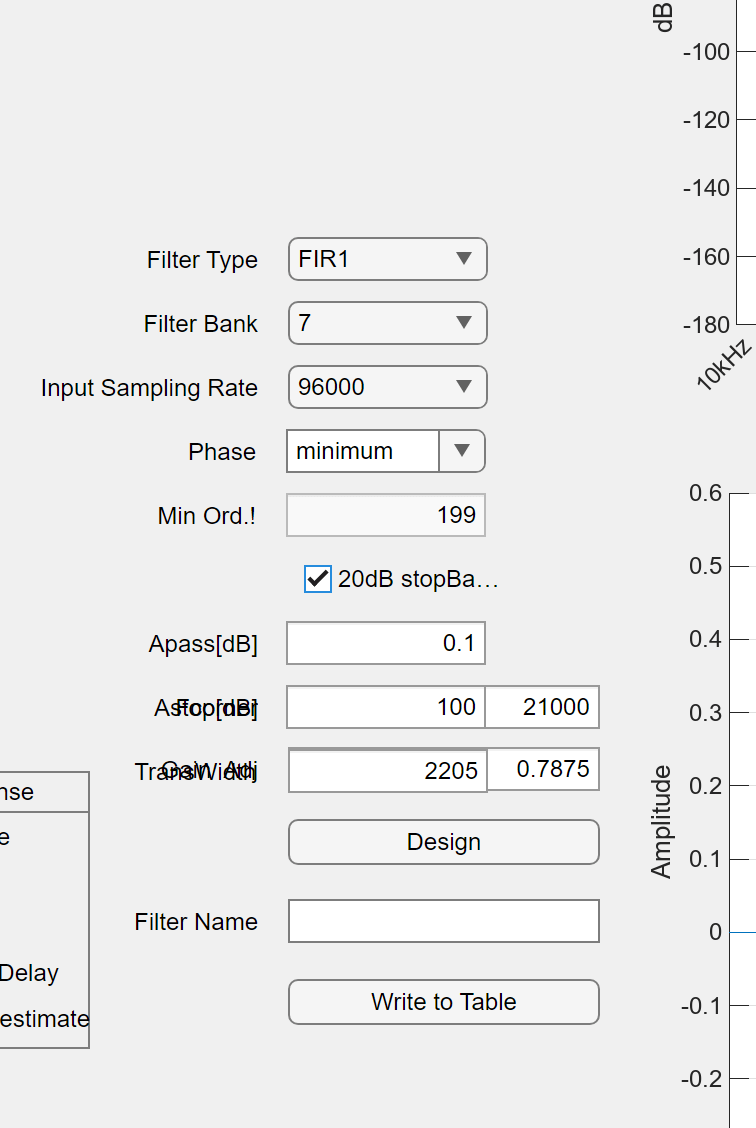

Trying to make som minimal og mixed mode filters just hang when testing here. Have to end the process.
Also, text seems kind of funny :)
Running win11 as a virtual machine from my macbook. That is win11 arm64 version. Could be a problem?
Maybe I can try on another instance? Have some more virtual machines running on my server.
