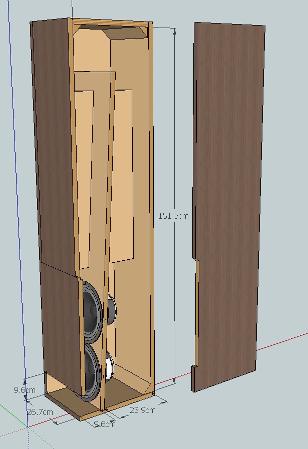

Fiddling with Hornresp - Peerless 831759
Or this one with a window O_O

Great pictures, looks good,you really got it right now!
I have only glued square frames of 3/4" x 1" of hardwood(Oak) to mount a frontally placed access lid on, never tested a side lid or rear for a T_TQWT due to the possibility for air leaks as the pressure is high immediately behind the drivers.
b:)
b:)
Yeah, I've discussed it with she who must be obeyed and it seems the general consensus is we prefer the ones that don't have a window, and in the end, I'll probably beef up that area around the access door in the front to more than 1cm of lip. I may just double-layer the front.

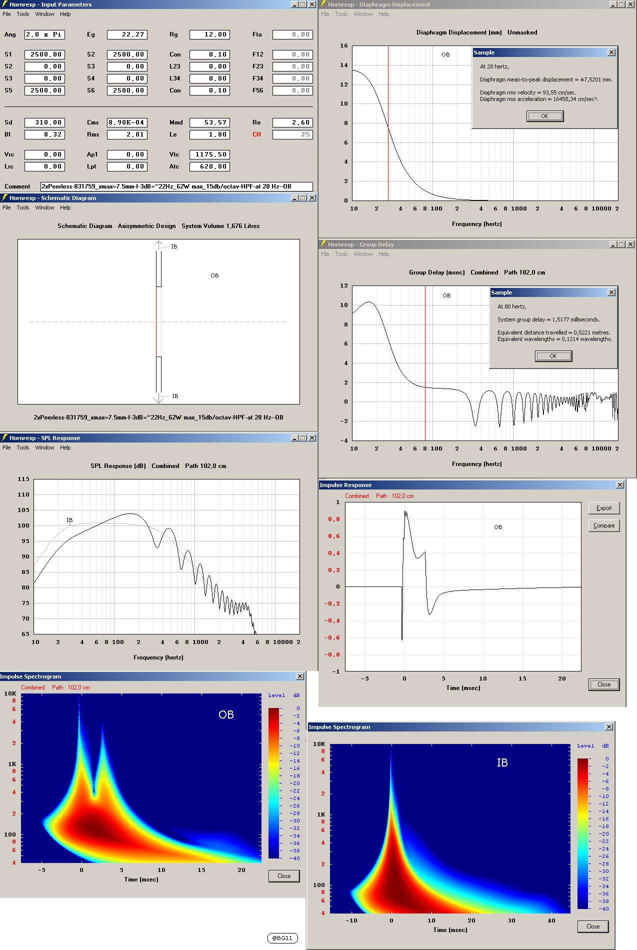

Added a few new simulations showing the effect of using damping material in a T-TQWT . The passband FR is as for the earlier HR plots but above ~80 Hz the MJK simulations are more reliable and shows the impact on off-band FR and the resulting superior IR that comes with introducing damping material in the air path,IMO: always necessary for any Hi-Fi quality speaker.
b:)

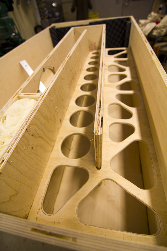

After a few days of listening and trying various amounts of acousta-stuff, I've settled on a fairly light stuff that goes about 30-40% of the way up from behind the drivers to a little past the first brace.
I am very much in love with this design. I can't thank you enough for all the help Bjorno, I had no idea these drivers had this level of smoothness and power in them.

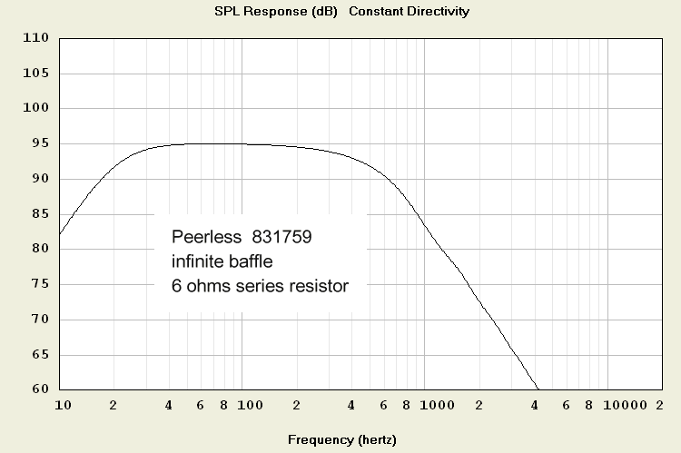

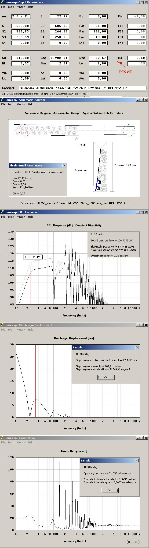

Submitting a new simulation using only one driver:
b :)
b :)
Thank you very much!

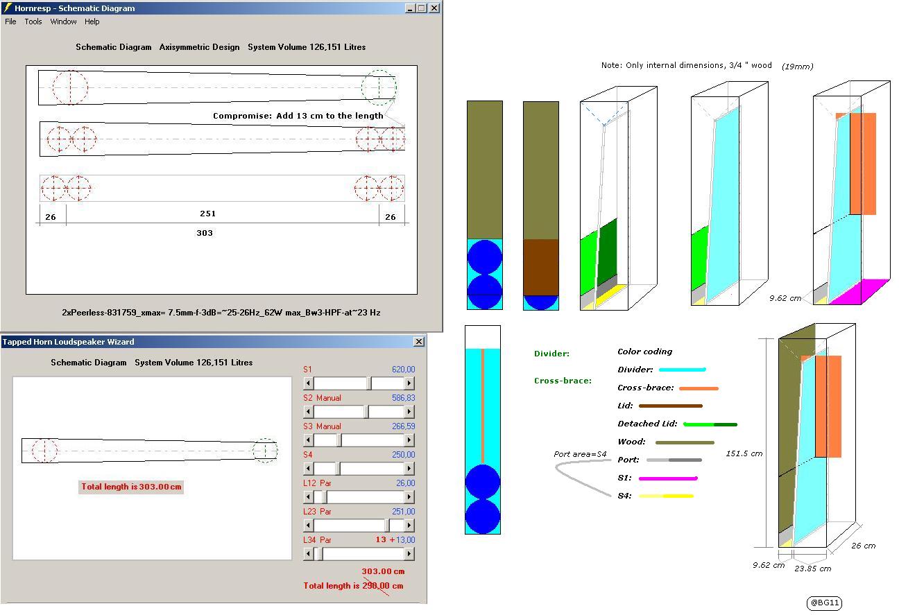

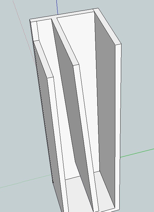

Ok, I've been staring at this for a while now, it would appear that the volume is a little more than half of what the old one is, but the length is about the same? Am I thinking about this correctly?

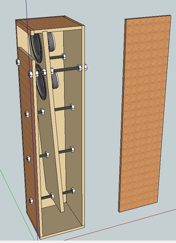

Also, since this one will be thinner, would it be bad if I folded it around itself to keep it stable? (pic, dimensions wrong, just idea)
Yes the length is same but the CSA:s are halved when using only one driver.
It's a good idea to fold like you did especially for subs that are to be placed laterally in a room....looks better and not that conspicuous compared to a large main sub.
b:)
