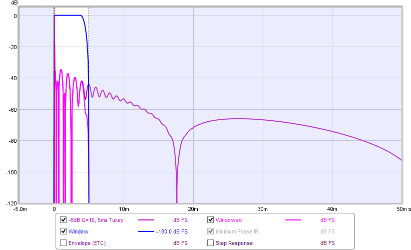

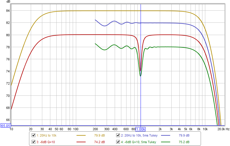

Here you go:Thanks for posting what you discovered. I think that your argument would have much more weight if you also posted the impulse response for the signal with the dip. Can you post that?
You can see two distinct elements in the decay of the IR. The very slow decays are those of the 20 Hz high pass, the faster oscillation superimposed on top is from the dip. I also had a look at a response with a 200 Hz high pass, effect on the 1k dip was the same though of course the HP decay part happened correspondingly faster. I've attached a wav file of the IR in case you wanted to play with it, format is mono, 32-bit signed PCM, normalised.
View attachment 20hz to 10k with 6dB dip.zip
I'll have to respectfully disagree with you on that. If an impulse response really were zero outside some bounded time (i.e. it had compact support) it would have a Fourier transform of infinite extent (or to be more mathematically precise, the FT would be an entire function) - just as a dirac does. There is always some truncation going on when a measured impulse response is windowed and that inevitably takes a toll. It is easy enough to show the effect by creating an artificial IR, I produced one for a speaker with a perfectly flat response between 20Hz and 10 kHz (-3 dB) and one for the same speaker with a 6 dB, Q=10 dip at 1 kHz. I then applied a 5 ms Tukey 0.25 window post peak and plotted a 256k FFT for each (48k sample rate, so lots and lots of zero padding). Here are the results. The 6 dB dip is now a 5 dB dip with a ripple. No amount of zero padding is going to recover the original responses above 200 Hz, the only way to reduce the ripple in the windowed responses would be to use a much smoother window taper, but that would correspondingly reduce the resolution with which the dip is resolved and make it look even shallower.
Despite their ripple, the plots look enormously better than they would if I had used an FFT that only spanned the 5ms window duration, of course, and the centre frequency of the dip is accurately identified. Perhaps that is all you are claiming? Any one of a number of parametric methods would do a better job of recovering the original signal of course, in this case with only 6 poles in the response and noise at the numerical precision of the signal a dozen points would likely do the job (but not zero ones ).

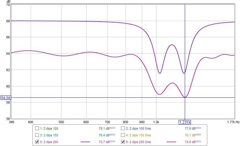

Now that you have also posted the impulse I think I have a better idea of what you did in your experiment.
Here is a repost of the frequency response from your original post:
Here are my thoughts:
1. The ripple is just a consequence of using the Tukey window and not a consequence of the dip (I think you inferred that). I'm not so sure that a narrower window will eliminate the dip. Did you try other windows?
2. The partial resolution of the dip is a result of the window width used. You used a dip having Fo=1000Hz and Q=10. The bandwidth of that peak is: BW=Fo/Q = 100Hz. The 5ms window that you used is only supposed to resolve features that are 1/5ms=200Hz or larger. It's no wonder that the dip is "partially" resolved, e.g. you get a slightly wider dip that is only 5dB deep. Also, the plot of your impulse and windowing clearly show that you are excluding part of the ringing resulting from the dip, which would likely remove some of the info about it. All in all it seems that the peak is recovered better than it is "supposed to", and there is more "detail" in the shape of the peak than if you just connected points spaced 200Hz apart, which is what (I feel) others have suggested in this thread and the "Uniform Directionality" thread that spawned this one.
It took me a little while to figure out what I was looking at in your impulse. I have never seen a plot of one that uses a log y-axis (e.g. SPL). Since the impulse will oscillate about zero and can do that even at short times, there will be those nulls like what is seen at about 17ms. Was this intentional? I'm curious about it. Also, what software is that? REW?
I used a log axis as it makes it easier to see the truncations that occur when an impulse response is windowed. There are two factors at play here, the effects of truncation and the effects of FFT length, it is worth dealing with each separately.It took me a little while to figure out what I was looking at in your impulse. I have never seen a plot of one that uses a log y-axis (e.g. SPL). Since the impulse will oscillate about zero and can do that even at short times, there will be those nulls like what is seen at about 17ms. Was this intentional? I'm curious about it.
Truncating an impulse will produce ripples in the frequency response and will alter the response somewhat depending on what has been removed. The ripples can be reduced by using windows which taper more smoothly, but correspondingly more of the original signal is modified by such a window so the frequency response is more significantly altered. What the frequency response plots show is the response of a system which has an impulse the same as the one that was obtained after the window was applied - since that response has been forced to die away more quickly, it of necessity has a shallower and slightly broader dip at 1 kHz, since that is the kind of dip that would give the windowed response.

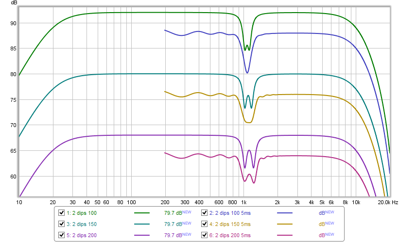

So, with the theory out of the way, what does that mean practically. Windowing (truncating) the impulse response alters the sample values and discards those outside the window. The windowed signal will have a different frequency response than the unwindowed one, depending on how much information we have discarded - if the original signal had sharp changes in its frequency response, those would have corresponding slowly decaying features in the impulse which will have been modified by the windowing, resulting in them being less sharp in the frequency response of the windowed signal (windowing the time response corresponds to a form of low pass filtering of the frequency response). We can still locate those frequencies with high precision, however, by using a long transform (zero padding), we just won't be able to see how sharp they originally were.
If the original response had lots of sharp features, the effect of windowing may blur them to the extent that those individual features become smeared together and can no longer be distinguished. So how close do they need to be before they merge into one? That depends somewhat on the relative sizes of the features, but for features of similar sizes blurring occurs at separations below the lower frequency bound of the window width, i.e. 200 Hz for a 5 ms window. Here are some plots for two 6 dB Q=10 dips separated by 100 Hz, 150 Hz and 200 Hz. The first dip is at 1.025 kHz in each case.
Looking in more detail at the case with 200 Hz separation, the second filter is at 1.225 kHz and the bottom of the dip in the unwindowed response is at 1.223 kHz due to the effect of the nearby filter. In the 5 ms windowed response the minimum occurs at 1.231 kHz, so the centre frequency of the dip has been resolved well, just 8 Hz from the unwindowed value.
Overall then, applying windows typically adds some ripple to the response; it has a low pass filtering effect, which will blur sharp transitions; feature separated by less than the lower bound may no longer be distinguishable, but the frequencies of isolated features and those separated by more than the lower bound can still be resolved with good frequency accuracy.
