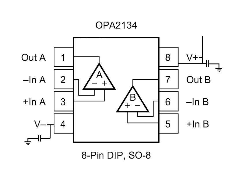

First - can two channels share the same virtual ground (I assume that's what it is at the bottom) and +/- rails?
Second - doesn't the virtual ground circuit need capacitors or something? http://tangentsoft.net/elec/vgrounds.html

No, the vground taken from the centre of two batteries doesn't need a capacitor to stabilise it in this design, because, unlike a headphone amp, it's not driving a particularly reactive load, so from a DC perspective, the potential at vground should never move far enough from the centre to be a problem.

No.. but the opamp needs them not the batteries. Most people leave them off, or show them in the corner of the schematic for simplicity sake. Use 2x0.1 uF decoupling caps close as you can at the DIP pins.

On that note: do I need to put the 0.1 uF caps between the op-amp supply pins and ground no matter what I do with the supply/ground? I have the caps (non-polar MKTs) and I certainly don't mind putting them in, but if I use the TLE2426 rail splitter and for some reason it doesn't need the caps, then I don't want to do anything pointless.
EDIT: Is this how it's done? (attached image)

When using TLE2426 in a low current situation, it is acceptable to use it as shown, with a largish (220uF or bigger, I usually use 470uF) capacitor before the rail splitter.
However, in situations where more current will be drawn, it is necessary to add 2 more capacitors, one from the positive rail to the vground, and one from the vground to the negative rail, and because these capacitors are essentially in series, they must be fairly large, say 330uF or larger.
In this situation, the additional capacitors should not be necessary, but the decoupling capacitors mentioned above will be. The diagram you have shown is correct - the distance from each power leg of the opamp to its respective capacitor should be as short as possible, and ideally soldered directly to the leg, although having it in an adjacent protoboard hole should be sufficient. The leg of the capacitor going to vground can be as long as necessary.

It has two purposes - to lower the impedance of the battery supply, and to supply current quickly - essentially, these are the same thing. Since a mic preamp will, typically, be delivering into a high impedance (the input of an amplifier, or the line in of a PC/recorder), current demands are very, very low. Consider that, with a typical opamp, maximum output swing would be about 2V below the rail to rail voltage - so, running from 18V, delivering into a 50 kOhm input, this requires less than 0.4mA of current.
In this case, size is relatively unimportant, but you should select a low ESR cap. This circuit would likely perform fine with no cap there at all, but a good, low ESR cap of about 220uF should have the circuit performing optimally. Combine this with good 0.1uF decoupling caps (NP0 ceramic is ideal, but you're not likely to find one in this high a value, so use what you've got), and it should sound great and be perfectly stable.

I wouldn't worry too much about batteries being unbalanced in that preamp circuit. Starting with fresh batteries the current draw is balanced so....not a problem here as with some other circuits. The opamp can deal with uneq V's esp with the output being very low swing (tens of mV). it's really a non issue.
Just use 2 batteries and add the ceramic 0.1uF caps (generic, not NPO)
