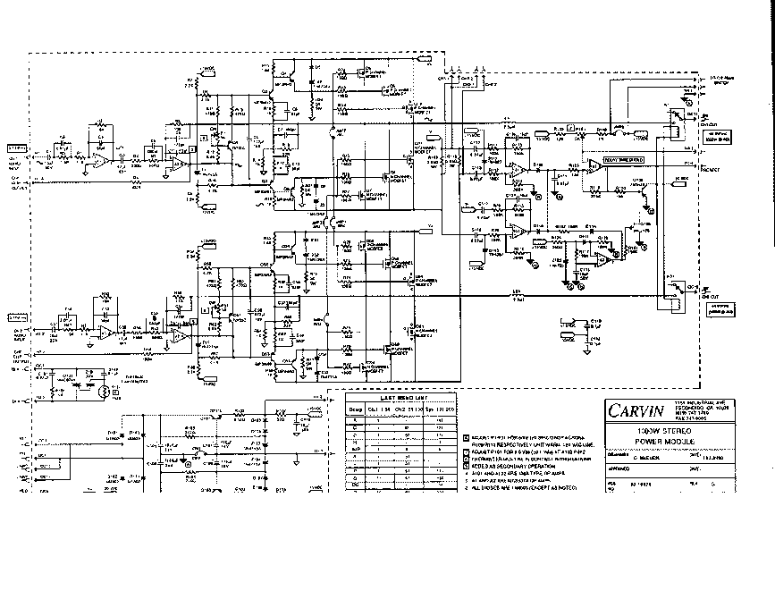

In a related matter I am repairing an old Carvin FET 1000 Amplifier, I am using IRFPXX and IRFP9XX parts to replace the output stage devices which are all fried. I did not have the original manufactures part number as the OPS was apparently already replaced once and the tech obviously replaced them with IRFPXX devices.
I did notice that the Ron Spec was notably different between the IRFPXX and the IRFP9XX. Is this going to be an issue in performance. Sounds like their might be some crossover distortion issues, correct? Perhaps this is why it fried in the first place?

I bought this amp off EBay for $80. The OPS in both channels were fried. They had IRFP9240 and W33N20 as complements. I called Carvin and they said the original parts were14D20 and 20N20. So apparently someone had already repaired the OPS with little luck. The Guy who sold me the amp said it was working fine and one day he tuned it on and it just shut off. He did mention that he also bought it used. I have several of these amps; since Carvin no longer makes them I figured I cold make use out of a spare for parts if not anything else. Would be nice to get it working.
I have posted the schematic. The drivers on channel one are shot as well I have enough replacements to change them all, and I will.

I cannot expand your thumbnail to any magnification to see detail, but it looks like a simplified version of an Electronics Now design minus a predriver cascode and using a chip front end instead of the discrete. The original design used 240/9240 and I would hazard a guess that they would work better than the 'industrial' FETs specified. The design can achieve reasonable results depending on the GBW/quality of the front end chip.
