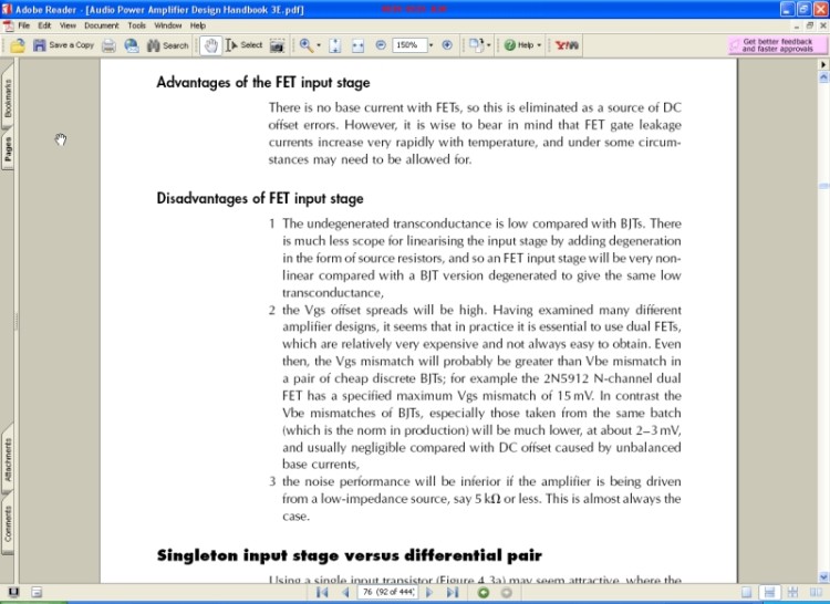

As long as people are making comparisons does anybody want to comment on the use of mosfets in input stages? They where very popular with Nelson Pass for a while, but much (not all) of his new amps have jfet input stages. I know they suffer from high gate capacitance so input impedances of 10k – 45k (depending on mosfet ) are needed to prevent high end roll off.
jerluwoo, I largely agree with what your book says.
Might you be able to give us a link to it, so we can read more of it?
Might you be able to give us author and title at least?
MOSFET inputs for op amps are popular when the very highest input impedance is desired. But this is totally unnecessary for any audio applications.
MOSFET noise is much higher than JFET of BJT.
JFETs will have lower noise than BJT when driven by high impedance. This is important for the built in amp of a condenser microphone, or it can be with a moving magnet phono cartridge, or even a guitar pickup.
JFETs will still have a higher mismatch than BJT.
There is some appeal in using JFET inputs, to get lower order, and even order distortion.
But this issue is far from resolved in my mind.
