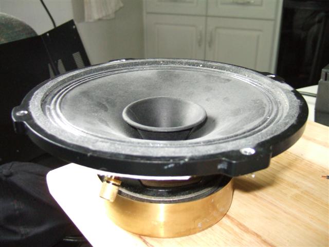

I have these 2 supravox bicone 93db. I have tried these in a qwtp and blh. It is hard to describe why; but these drivers have been gathering dust for some time.
I will give them another go, this time on open baffle. The qts. are .8 so from what I have read, this should work well.
I am constraining the baffle size because of my room-13'x14' to 24" x 36" approx.
It will be a 6 corner baffle using the "edge" open baffle design program. The baffle is a bit unusual with the driver placed close to an edge.
Should be fun with minimum expense.
