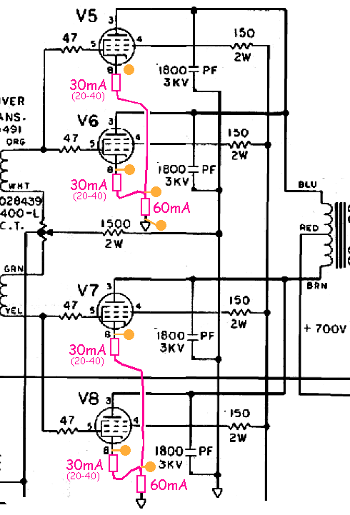

seeing as no one has anything else to offer info wise on what to do in terms of bias setup on a Ps 300 i guess i'll just have to hope that 6550's will survive.
In an effort to avoid any accidents.

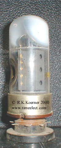

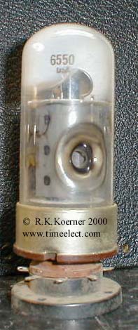

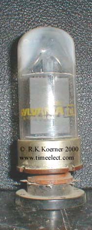

There's a bucket load of info on keeping 6550s alive, mostly around keeping the glass under 250C. An IR thermometer is suggested by some (and now cheap to hire as every electrician should own one).
The problem with this amp is threefold : Fender pushed the 6550s well past their official ratings back when US mains power was 110VAC. To the point that they're "specially designed and selected": that is, no longer standard 6550s (apparently GE 6550A is the factory part). I'm guessing they're idling at somewhere near 40W per tube, waay outside 6550 specs. (should be 600V/300V/50mA@-40VG1 not 700V/340V/???@-42.5 w/ ???>50mA! )
Next, you've got one, single pot to set the bias on all four tubes. If they're not all matched (or one screen resistor catches fire) you're screwed.
And now the mains in the US is often nearer 120VAC (by all reports). So your dissipation goes up again.
Did I mention carbon tracking yet? Your not planning on using this in a hot, sweaty bar by any chance?
No wonder there's a mythical 30 step plan for something that should take two minutes (once you've worked out whether the distortion switch causes more or less bias current).
Best thing to do with this amp is to reduce the B+ (and apply the immortal amp mods) or find some 50W "6550"s in a matched quad.

the amp's owner is resisting all suggestions for mod's to his amp and mention of reducing B+ almost made him have a fit.(seems to be after every ounce of output he can get)

Good thoughts - there's buckets of info on talkbass on setting up SVTs. And finding suitable tubes...., the Ampeg SVT works under similar conditions with new production 6550s. Bias it for class AB, ca 30mA / tube , for ~25W max dissipation.
i'll have to check out "talkbass"
bb5000 if i bias it that level it wouldn't be making the 300 watts it supposed to, or is the 6v6 driving the x-former phase splitter making up the difference? sorry for the question this is a little unfamiliar territory for me as i've not worked on an amp like this one before so i'm perhaps overly cautious with everything.
The 6V6 SE stage and the interstage transformer is there as a low impedance PI solution (I've built a similar solution in the Weber AB200 amp). I guess that the idea is providing class AB2 capability. I think that Ted Weber designed the AB200 to be used like that, but tragically he passed away just as the design was released, so there's no one to confirm it.

...if i bias it that level it wouldn't be making the 300 watts....
In an amp that reaches class B, bias setting has nearly no effect on MAXimum power.
Your car engine had an Idle Screw (now an ECU function). Twiddling that has no effect when you press the pedal to OFF-idle and to Wide Open.
Bias matters for heat and the first Watt. A cold idle bias will sound hoarse on soft sounds. Tubes don't do this as bad as transistors. A 300 Watt stage amp is rarely judged by its ability to whisper nicely.
well i guess i'm mistaken i thinking that improper bias in a push pull output stage can at one extreme can cause crossover distortion and reduced output and at the other extreme excess clipping and exceed plate dissipation and subsequent tube failure.
is this not correct?
also in the case of the PS300 the current balance setting is to compensate for asymmetrical clipping or do i have that wrong also?
Are you referring to the bias balance pot ? Set level, then balance to achieve even idle current /minimize hum.. I think that the key here in biasing is to allow maximum voltage swing without redplating (hot) or class B operation (cold).. using a scope and a dummy load (a big one) would allow you to see what's happening and measure output power etc..
