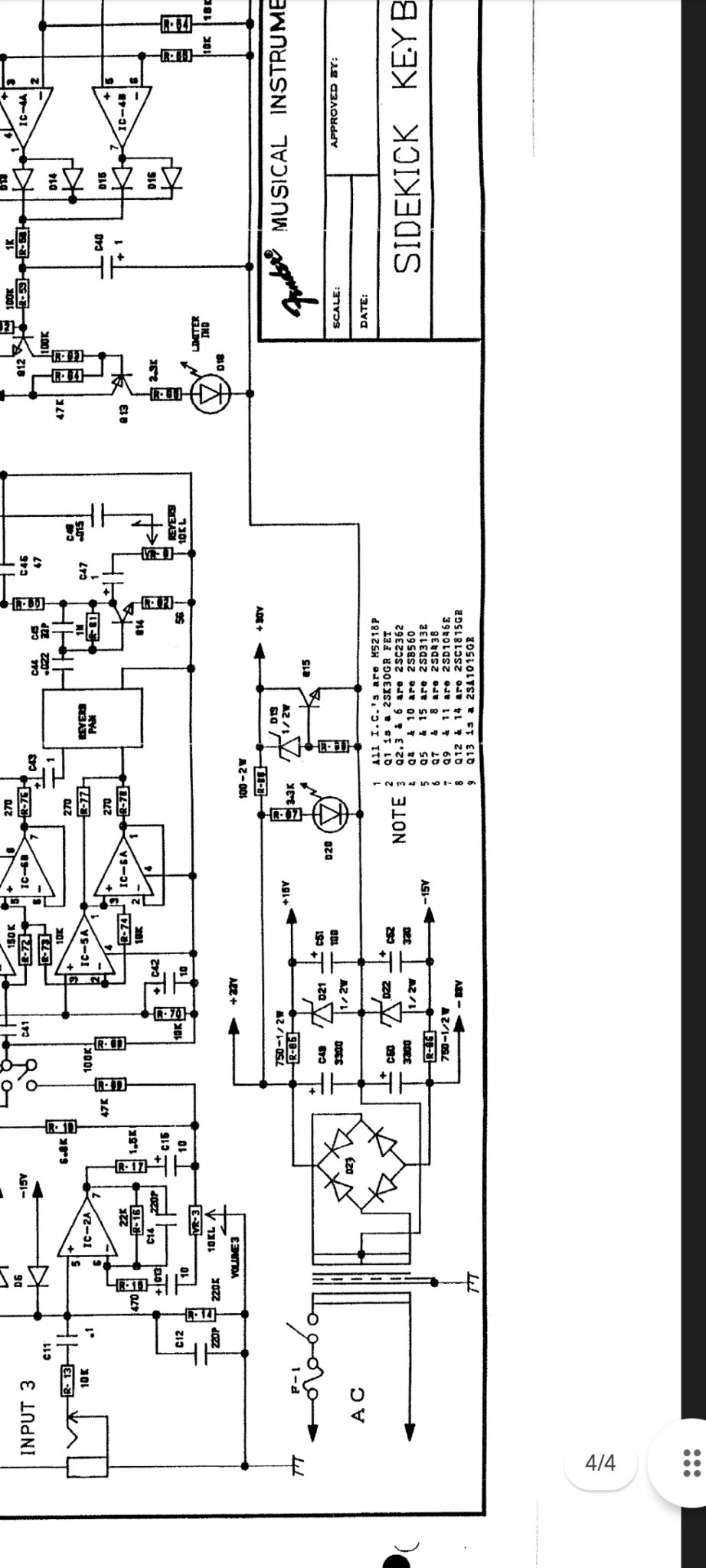

Hello guys, a friend of mine asked me to fix this amp, so the problem is basically when you turn it on it will immediately sound/produce/hum that sounds exactly when you have a output transformer bad, so the reason to this been someone changed the 750ohm resistors with 150ohm. I checked the schematic and the amp and i don't see to many other suspects, but since its a model im not familiar with, i wanted to see what you guys think? Thanks a lot
Here its how it goes so when you turn on the on switch immediately you hear the loud hum (so you have to turn immediately off since it sounds hurtful to the amp like a lot of current going in other terms shorted, speaker immediately sticks to bottom), its the type of hum that you would get if a bad output transformer on a tube amp or at least its the only time before i have seen something similar, due this being the problem you don’t have any chance to read nothing, amp was good to my knowledge after someone miss change this resistors what 750? They are labeled as R85 and R86, so before anything just by watching the schematic you can see it is indeed a 750ohm NOT a 150ohm so I would assume the diodes (d21/d22) are gone too, but my question i guess its more oriented in the case of , in a tube amp this immediately means shorted output so you basically know for sure that you have to change that (op) and then hunt the problem that caused this, but now in this case i know for sure that the only thing different are those resistors, i know for fact that the last person” couldn’t “ find the schematic so he went by the color he saw, so im the guy correcting this mistake and since normally i dont do SS i wanted to be sure by asking here since fender shares a lot of mistakes and problems in this specific area in a lot of model amps, also speakers work fine.

is it the KRX or the Sidekick 60?
there's a few versions so unless we know for sure it's hard to follow along...i just had a look at a KRX schematic and R85 and R86 are 10K's so you need to share a few more details.
loud buzzing noise on the output, could be a supply diode, could be an output transistor, could a bad cap....at this point there's not enough known to make any sort of determination of what could be wrong.
Hey thanks to reply, its one version that only says “keyboard 60” but looking at the schematic of the sidekick matches, thats the one im following, im planning changing since i got all parts handy and ill desolder anyway, let me know what you guys think

no the ones i'm talking about are C51,52the caps you suggest are the 3300ufs ?

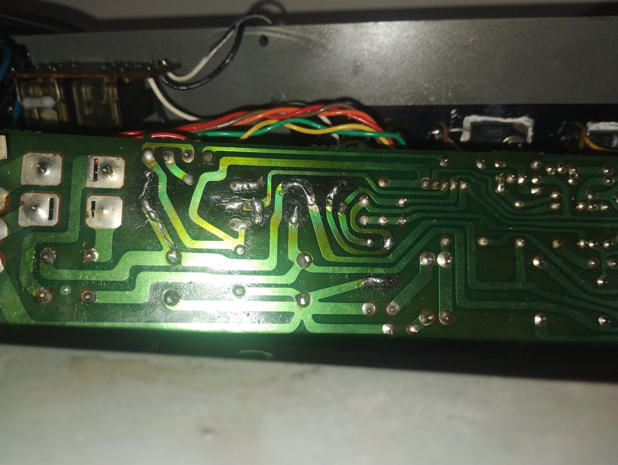

Hey, yeah Tarzan no “stupid” gunshooting components, turk ill change all components involved as i listed, i just pulled c49/50 and one of them is completely dry, if you shake it you kinda feel the mass banging like a ball inside, the other one dry too not as bad but dry, im almost done in replacing bad components, then the readings and then hope to be well and working again, ill keep informed
Hello, so i finally put my hands in this and so far this is how its going, so i did change all the components listed filter caps were completely dry you can even feel the mass banging inside, anyway
i disconnected the PT and tested, it’s reading 32/33 VAC each blue cable so the PT its ok, however i do have the same problem when i turn on the amp, i did change all the output transistors and drivers also, i have two questions 1/ if i disconnect the speaker can i measure inside without anything going wrong or burning i mean i don’t want to get into more trouble that i already have i took this amp and a HDR as a favor but never again taking someone’s else half job because i do feel hesitant since i really don't know what this amps have seen, anyway as i said the hum its exactly as when you have a bad output transformer, also at this point, do you guys suspect from anything else or am i missing something ? thanks for the help again.
You have blown power transistors.
You replaced them but they must have carried other parts the grave
1) connect amp through lamp bulb limiter until it tests good.
Use a 40 to 60W filament bulb, no LEDs, CFL, etc. You need that red hot tungsten wire in series.
