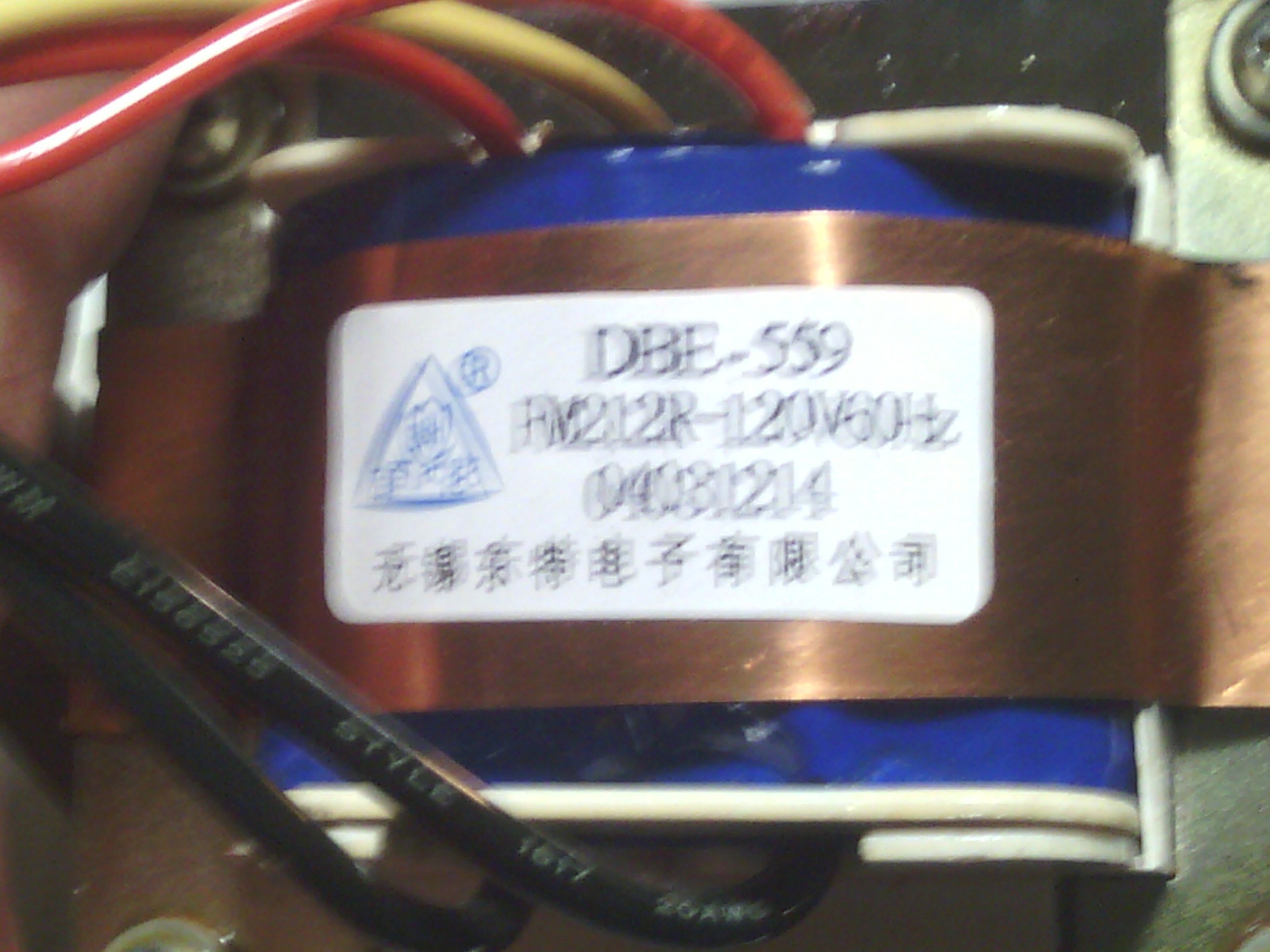

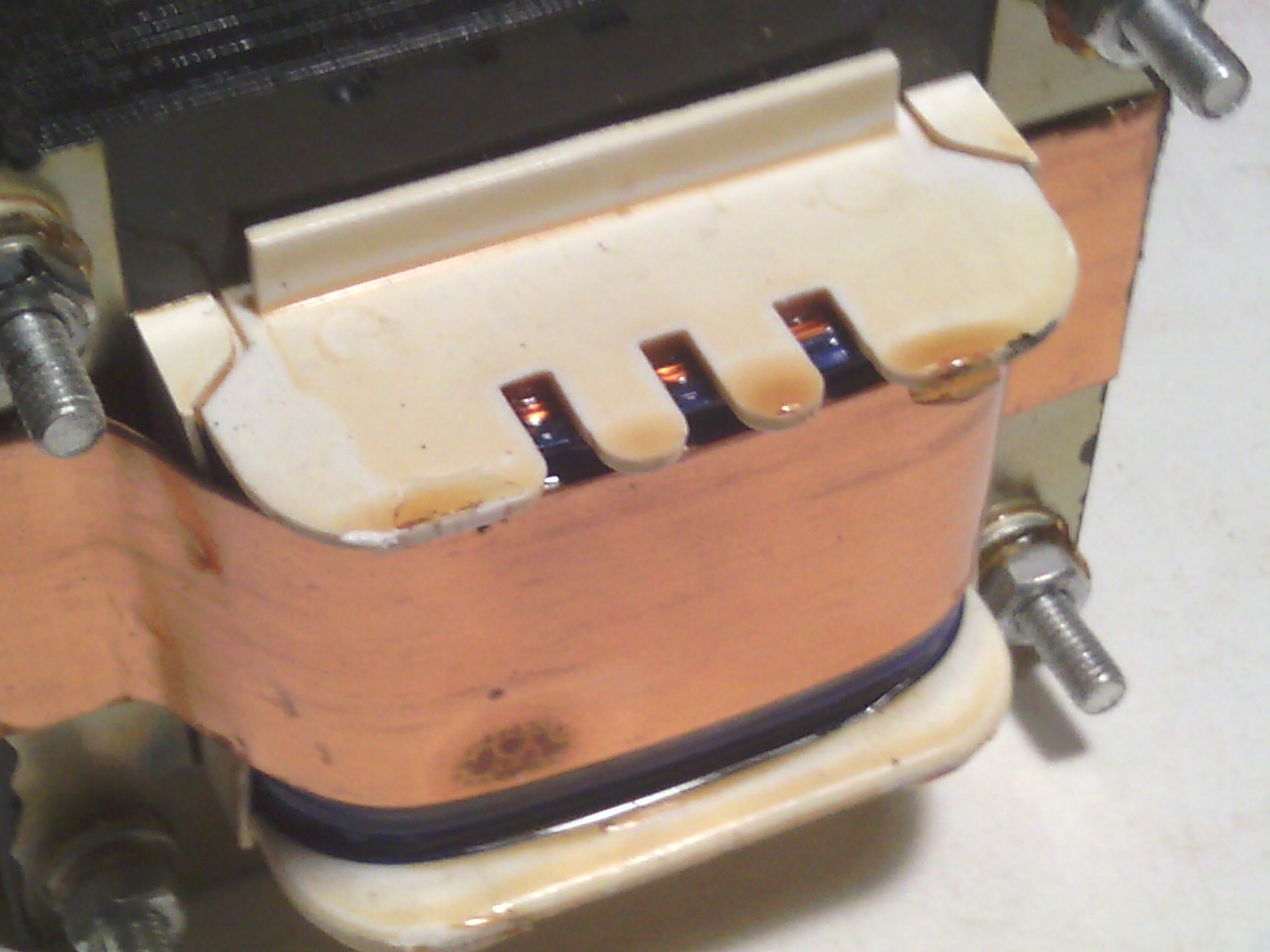

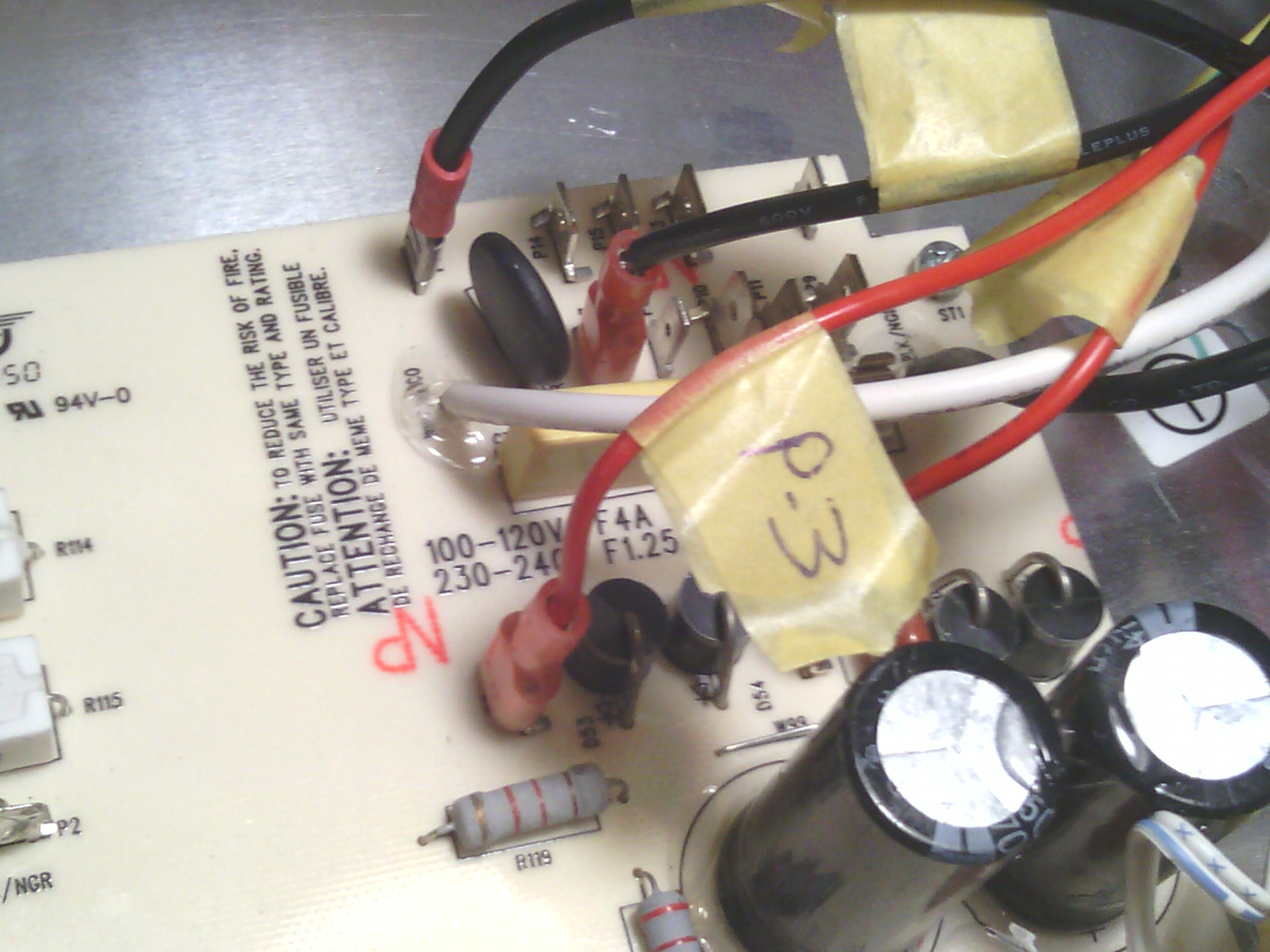

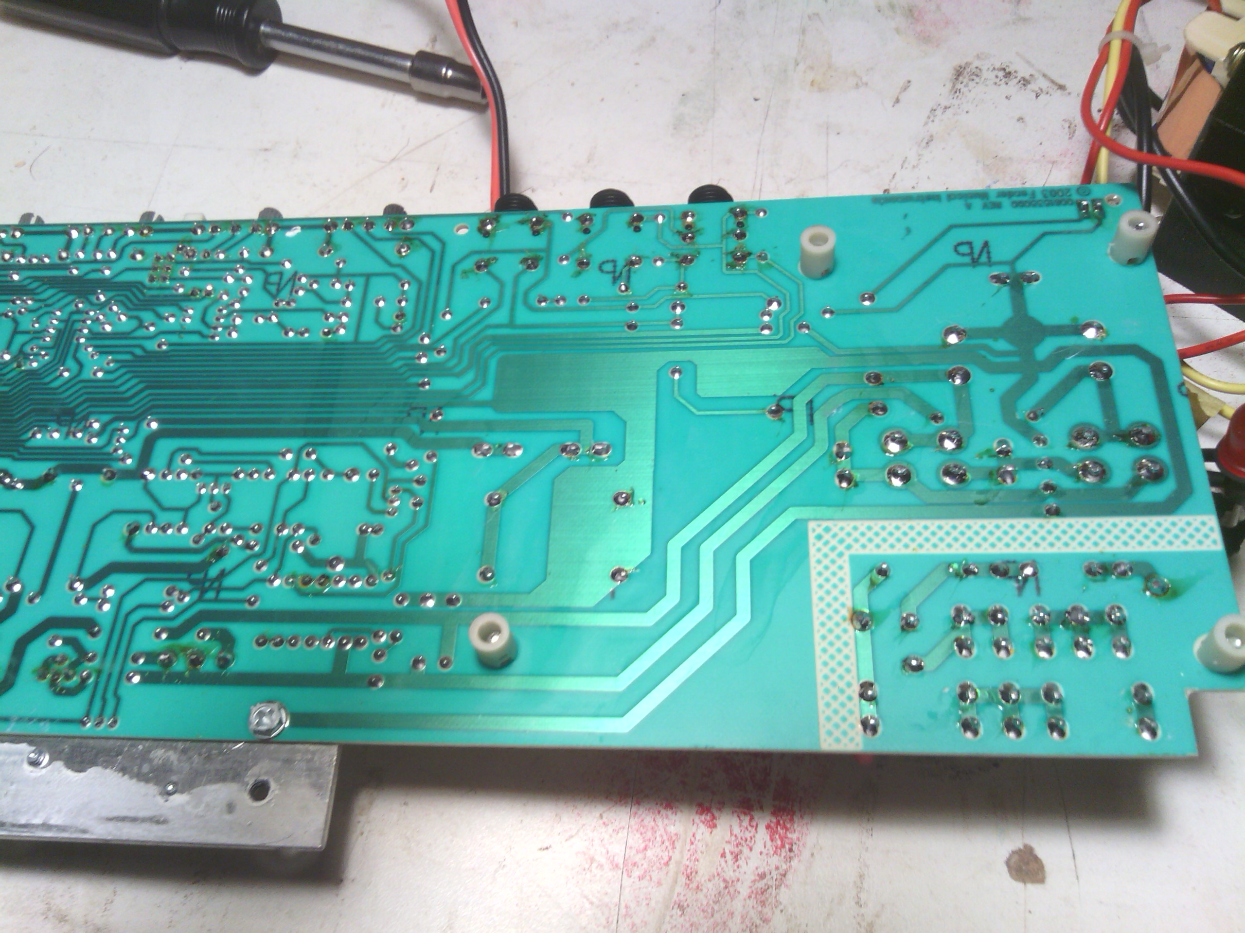

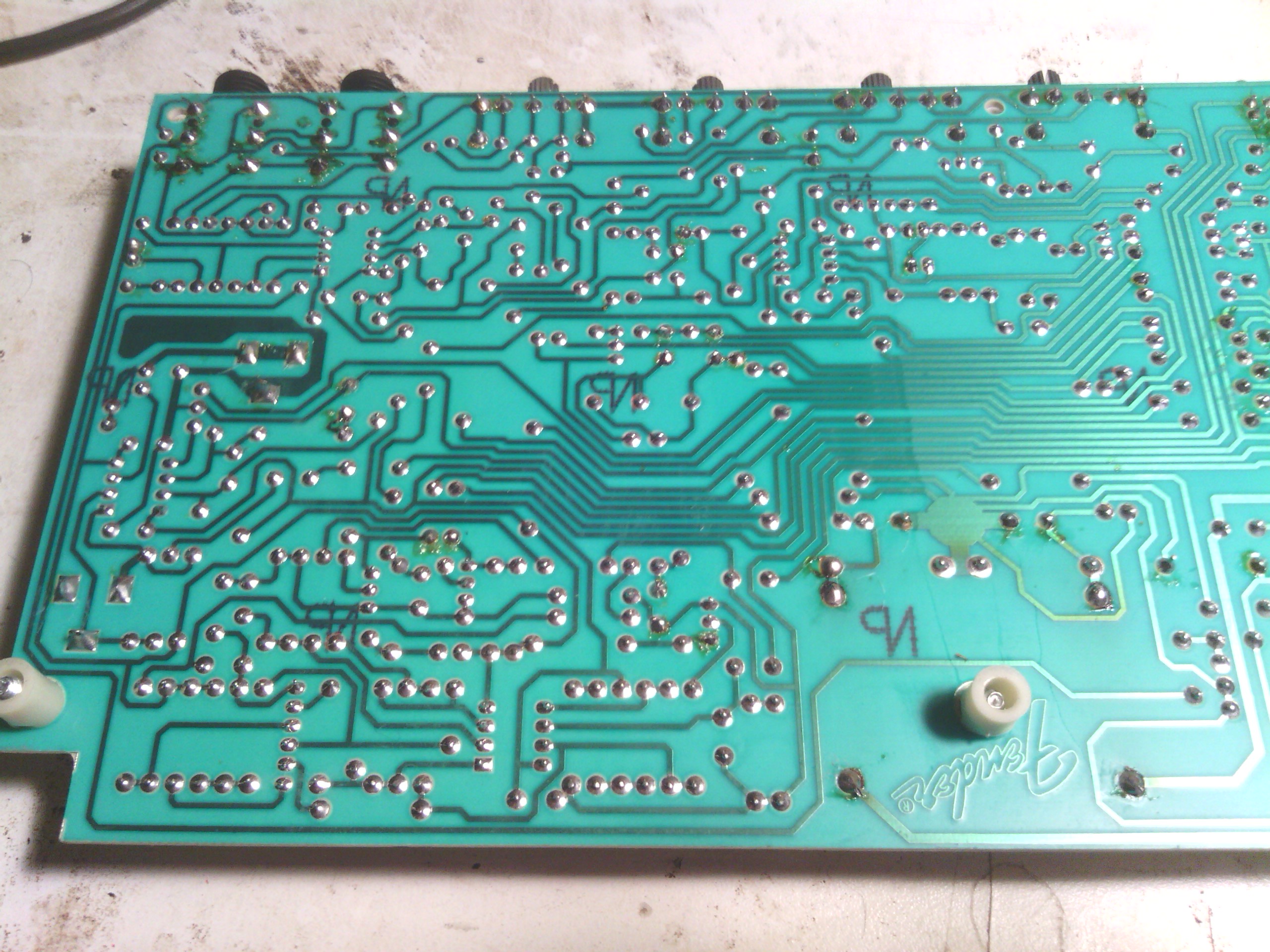

FM212R in pieces w/pics
Its all apart and I have been over it visually and I don't see anything out of order, no strange smells, burn marks etc...
Attached are some pics. The Power Supply has varnish that ran out of the coil(s) which I assume happened when it was originally dipped.
The two big Caps are not discolored, misshaped etc.
There is the residue all over the solder joints that I am under the understanding is supposed to be cleaned off after soldering because that substance is supposedly corrosive. But I am not positive about that.
Not sure if I should reflow all the joints or not. I don't want to cause myself any more problems.
I think I will re-assemble the amp and leave it out of the cabinet, hook up the speakers and power and try wriggling wires etc.
BR

I reflowed the solder on the main connections. i.e. Power supply terminals, the large Caps, all 5 of the jacks I recently installed and a few of the smaller ones. No I didn't over heat anything that I know off. I then mounted the PC board back in the chassis. I made a quick check of all the connections and discovered that the crimp connection on P7 moved within the connector. It wasn't flopping about, it was just loose enough to move it if I tugged and pushed back. I got really happy assuming that I had found the underlying problem. I recrimped all the push-on connectors and then I plugged the amp in without the speaker hooked up. I flipped the switch and it took about 2 seconds and it blew the fuse on the PCB.
I pulled the PCB again and rechecked all my solder joints and found what looked like a hair sized piece of solder between two of the small joints I had resoldered. I desoldered it and then soldered again. I checked all the joints again and found nothing so I reinstalled the PCB and installed a new fuse and hooked up the speakers this time and when I turned it on the speakers hummed for about 2 seconds and the fuss blew again.
So... Either I am missing something or I caused another problem OR I inadvertently caused the humming issue to finish "going out". So... I'm not sure where to look now but either way I don't have any more fuses. Tomorrow will be another day I guess...
Still blowing fuses
The joints I thought I had shorted are a ground leg for one of the pots and the ground leg of the adjacent "More Drive" switch.
If there is something shorted from my endeavors I cannot locate it.
I got more 4 amp fuses and removed the PCB from the chassis and hit the on switch and it just hums and then pops the fuse after a few seconds. I'm pretty sure what's happening now is what was going to happen eventually anyway. It used to blink out and hum intermittently, now its doing it non-stop.
Anyone have enough understanding of how to troubleshoot this? I have a Good quality DVOM.
