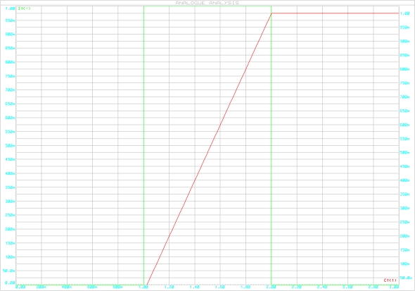

The capacitor integrates the current to get the voltage. It just so happens that the integral of a sine wave is ... a cosine wave. And, a cosine wave is identical to a sine wave but shifted 90 degrees. So, because it so happens that with a sine wave the integral also looks like a sine wave, it just looks like a delay.
You can see that there is no delay as such if you realise that any change in the input wave also has a change in output wave at the same moment. See the attached graph from a DC current (green) into a cap. When the current is switched on at T=1, the cap voltage (red) *immediately* changes (starts to rise), so there is NO delay (the red curve should start at T=1, the small error is due to the graphing software).
Edit: The integration action is also clear: a constant current causes a linearly increasing voltage...

I think with coupling caps and DC, caps are as non-linear as it gets since they block the flow.
*Angry sigh*
Please go to school and read a few textbooks.
Blocking DC is a linear operation. Please, all of you, verify the actual definition of linearity before spouting what you think linearity is.
[snip].
No, they are not non-linear because they block DC. There is a continuum from hi freq through low freq to zero freq (DC). At all times, the cap impedance is depending on f and the cap value. That is perfectly linear.
CapImpedance = 1/(2*pi*f*C). Also in the limiting case when f goes to zero, where CapImpedance goes to infinity. All perfectly linear.

Blocking flow is really a misnomer and a very short-sighted way to think of what a capacitor really does. It also has nothing to do with linearity.
If you got current to flow through a capacitor (some net amount disregarding leakage), then you'd have exceeded the breakdown voltage of the capacitor. All the capacitor can do is store charge. This points to why the capacitor opposes changes in voltage across its terminals. Any change in voltage attempts to change the amount of charge on the capacitor's plates. Since changing the amount of charge requires current based on the rate of change of voltage, faster rates of change require more current. This current is never flowing through the capacitor though; only into or back out of it.
It would be more logical to say that the capacitor smoothly varies in impedance to effect a change in signal level if used with a signal source of some finite impedance (as all are).
We are not going to get very far discussing feedback if people are unclear what is meant by "linear". It would be like trying to run a marathon before you have mastered walking on two legs. No, a real OPT is not linear but at some frequencies it may be a closer approximation to linear than a valve.
The easy answer is to send all the doubters away to read some textbooks. When they have understood them, they can come back and raise queries about things which puzzle them or things they disagree with. Not likely to happen, but how far should we go in attempting to remotely teach basic electronics and signals?
A capacitor is linear at all frequencies because if you add two different stimuli to it the output is exactly the sum of doing the two stimuli separately. That is what linear means - put twice as much in and twice as much comes out - no more, no less. Valves are nonlinear because this is not true for them, although they are approximately linear for small enough signals. Feedback networks are linear because they are made of linear components like capacitors and resistors. That is why we can use feedback to improve linearity.
