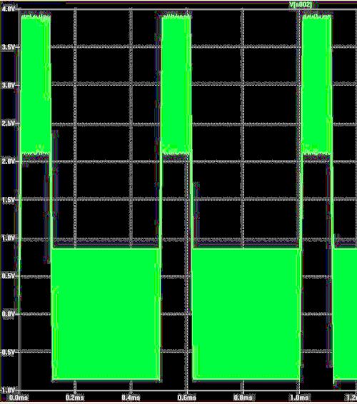

May be I showing the slowness of OPA2134 for buffering DAC not so sistematic.
Ok, lets start with most people agree that OLBW is unused, right? (and hard to change this religion). Then in this case an opamp used for DAC buffer to prevent DAC drop when filtering.
Attached image is DAC output waveform that show at least it needs buffer with good 'speed'. As I know here, that low OLBW is slow and higher OLG is higher and much overshoot and less stable.
OLBW may also important in other side of audio signal amplification, like driving loudspeaker when output is so unlinearly reactive and 'feedback applied', since no one could show about it, it is just also a myth.

Indeed ? 10pF is ok ? Looking at the graph ..... LT1028 is not good ? :) Ok, try with another high performance opamp.

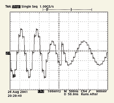

The problem comming from the source, badly design digital source in special. This have too much HF energy which can not be correctly treaty and then that HF energy will be pushed down and up in frecvency . I was listening same music live, with analog mic and pre, and then the same music recorded on a weak digital record sistem. The amplifier and loudspeakers was the same, but the differences in sound was teribble.
Theoretical speaking, digital recorder it is much better then performances of pre+mic combo. In reality HF energy(over audio range) playing an important role.
