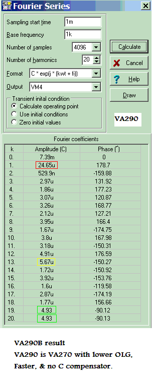

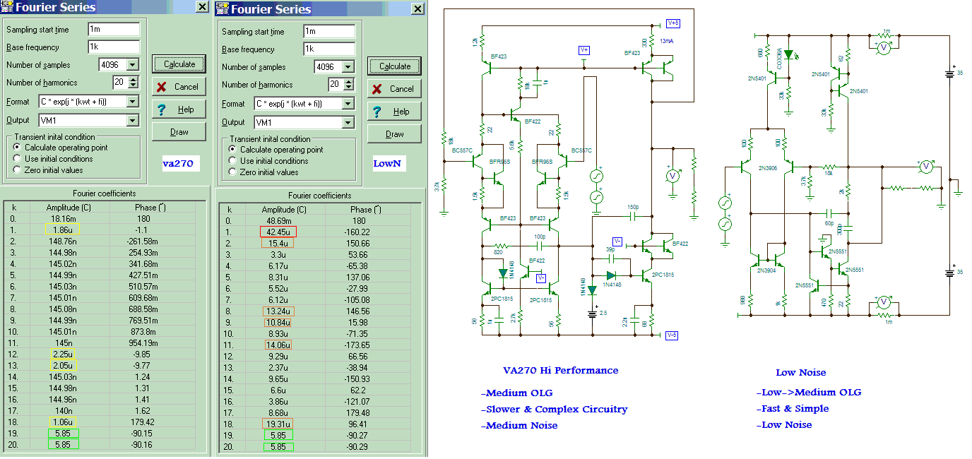

I found something in my sim result. And may be this is why my VA270 still clean compared to VA290, and my VA291 not even reach as good as old VA270 in some case. But where this noise of IMD coming from?
ADD:
I see also 12kHz and 13kHz noise, but 1kHz noise has bigger differences in both VA270&VA290 may be it is the matter.
ADD:
