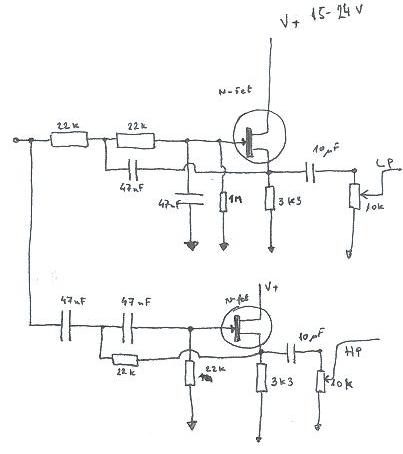

Vix said:
I draw a mock-up circuit that could work. (I am not 100 % sure)
The notch filter at HP part is omitted, assuming that one would use PC-based source and Foobar 2000 player and could use its equalizer for frequency correction...
You will want to take a look at my upcoming buffer article, as you
can get quite a bit better distortion figures on that circuit.
I like the LRC notch. How do you play vinyl with a pc based
correction circuit?
Vix said:
Have you tried this crossover setting:
LP-250 Hz 18db/oct
HP-250 Hz 6 db/oct
No, I haven't. For a loudspeaker like this, I start with the fewest
number of poles and the lowest frequency, and adjust it upward
or add more poles as needed. I stopped at 2 poles at 100 Hz.
The one and only
Joined 2001
Great. I trimmed the high pass for a little higher Q with a bump,
and it flattened out the 150 Htz region. Better, it put the drivers in
near perfect phase at that point.
Very nice system. I've been flipping back and forth between an F5
and an F3 on the top. The F3 softens it out a bit, and the F5
sharpens it up. Depends on the musical material - do you want your
Playmate with a little airbrush, or do you want to see every pore?
