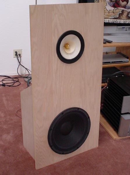

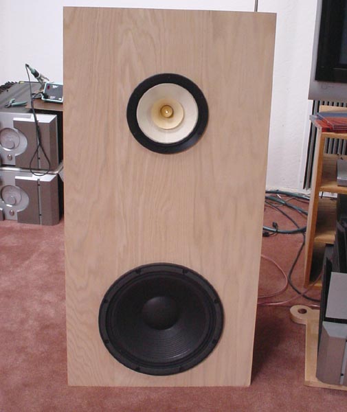

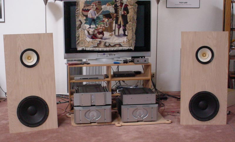

I've finished dialing in the crossover and equalization
for the D9nf in open baffles with a 15" woofer. The
sound is really good, although the setup would be regarded
as provisional. I plan to spend some time enjoying this before
making further changes.

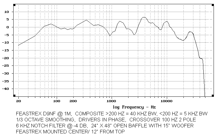

Lastly, here's a composite response curve of the speaker,
taken at 1 meter on-axis with the D9nf.
The response below 200 Hz has been taken at MLSSA's 5 KHz
bandwidth to get a good picture of the bottom end, and the
response above 200 Hz was taken at 40 KHz bandwidth. The
curves have been smoothed at 1/3 octave.
The amplifiers are an F3 on the top, and an X150 on the bottom.
The crossover and equalization were determined through listening
tests, and currently the crossover is 100 Hz at 12 db/oct.
Both drivers are wired in phase.
The D9nf has been equalized with a low Q notch filter at 6 KHz,
with a -4 dB depth.
Any questions?
