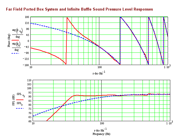

Just for curiosity do the WS's do ported boxes like the one fostex recomended?

Im curious to see how it 'measures' compared to the box you just made... which looks pretty darn excellent if you ask me!

Indeed they do: 1 reflex enclosure modelled at your request for the FE208ESigma good sir!
It's pretty good, though I cheated a bit and used a 3"x5.5" circular port as the worksheets can't yet model anything other than circular ports. Dimensions are exactly the same otherwise as those on the Fostex site for the BR box for the FE206E. There's more ripple than the MLTL, especially up in the 900Hz region -but for a reflex enclosure, this is one of the very best I've seen with a full-range unit. No kidding. Impressive. Also, it has a nicely damped roll-off below 100Hz, which should be useful when room-gain is factored in. Overall, I'd personally go with the MLTL, as it goes a touch lower, has that TL midrange I like (the stuffing I think prevents some reflections coming off the internal rearwall and through the driver cone) presents a milder impedence curve to the amp, and would also remove the necessity for a stand, but this is by no means a poor substitute. Very impressive.

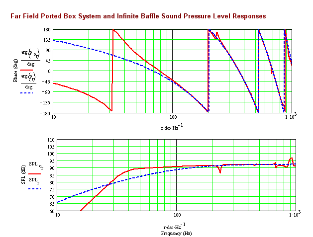

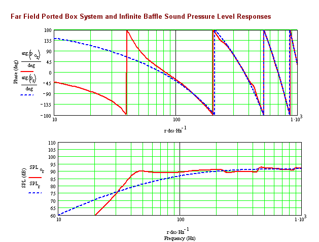

That's based on the Straight Pipe Bob Brines built for the RS1354, right?
OK, this is the response. It assumes the dimensions you stated above, with the driver 30" down from So, and either a 3" wide, 2" long round port 2" up from the base, or the equivalent slot port in the originals. 0.25lbs ft^3 stuffing. No series resistance applied or required as you can see.
Looks like you're in business. BTW -pine. Good choice. Unjustly under-rated, at least for use with full-range drivers.

Thanks Scott! I hope you don't mind if i use your chart in my write up on this project sometime in the future. I will credit you for providing the graph of course. I already have the wood cut ... just need to cut out the holes and attach the new baffles. Removable baffles are wonderful!
http://www.zillaspeak.com/ZillaSpeakBoxPlotFostex168-167.asp
The shape of the response you got is similar to what i get in WinISD for simple ported boxes.
The shape of the Voigt is timeless and our kids will be building similar speakers with newer full range drivers well into the future. They will probably laugh we only got down to around 50 or 60hz.
Much appreciation. You've confirmed on paper what i will build wont be a total flop... i was going to build it anyways... but you soothed my apprehension and actually got me excited about this project.
I will place these about 2 to 4" from the back wall and warm up that bass a little too. How nice it should sound!

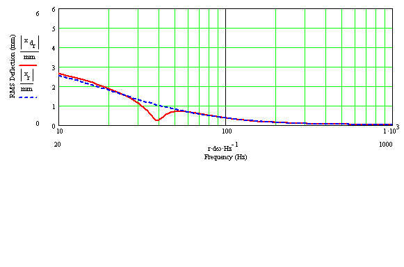

BR vs. BLH
Let me try to show this from a different angle. Scott, are your simulations done assuming 1W input power? Can you, please, post the cone displacement (excursion)?
One of the main problems with ported box is that below Fb the driver is totally undamped. Excursion goes through the roof very fast as frequency goes down. The Xmax of this driver is only 1.3mm one way. At 40 Hz it will bottom out at 2W input power in so nicely looking modled box, producing max SPL of 84 dB.
I am not that familiar with ML-TL design yet (getting there...), but AFAIK, there is the cone displacement plot in Martin's worksheet. Scott, can you check in your model where it will hit the excursion limit in that design?
Anyway, in a BLH high excursions are not required from the driver: the horn works, basically, as a trasformer. What's needed is high speed. To get this you've got to have as high a BL as possible, which means huge magnet. Huge magnet results in low Q. At least this is my understanding that low Q is a result of a design aimed at horn enclosure and not the other way around: low Q drivers are only sutable for horns.
As a matter of fact, low Q drivers with high excursion limits make the best subwoofers for ported enclosures. Low Fs also helps in this case.
I am working right now on a design of a BLH for new Hemp 8" driver, with Q around .5 and beleive it makes for a better final result than FE106 with half the Q. In Martin's article on the advanced design of the BLH there is a chapter, where he shows the benefits of higher Q.

OK, low Q drivers in box enclosures. Well, they don't naturally work as well as higher Q drivers -they have more motor strength, and the result is that in a box enclosure, they are over-damped. However, adding some series resistance sorts that problem out. Also useful if you run a transistor amplifier which have a high damping factor, and thus over-damp most full-range units with their big magnets and hyper-light cones. Tube amps, with their low damping don't have this problem.
Re: BR vs. BLH
Sim is done at 1w. Woofer displacement shown below. As you can see, it's not bad. This is basically very similar to Martin's Vitual MLTL Project for the FE206/7E which have similar excursion capabilities. I've never had a problem with mine. They're not ideal for reproducing Motorhead of course, but against that, they go much lower for a much smaller box-size, and usually have a smoother response. Not that I'm denying horns their due -I have a pair of Terry Cain designed rear-leaded Voigt style corner horns / giant TQWTs terminating in free space with FF165Ks (Xmax 0.3mm) that are very good indeed.
That said -I like the higher Q drivers too: as Martin notes, and you have found out, they have some benefits, even in horns. I gave up worrying about the Q of the driver a while back, unless it's over around 0.5, in which case it's probably best in a huge sealed box or on an open baffle.

VadimB said:Scott, are your simulations done assuming 1W input power? Can you, please, post the cone displacement (excursion)?
Vadim
