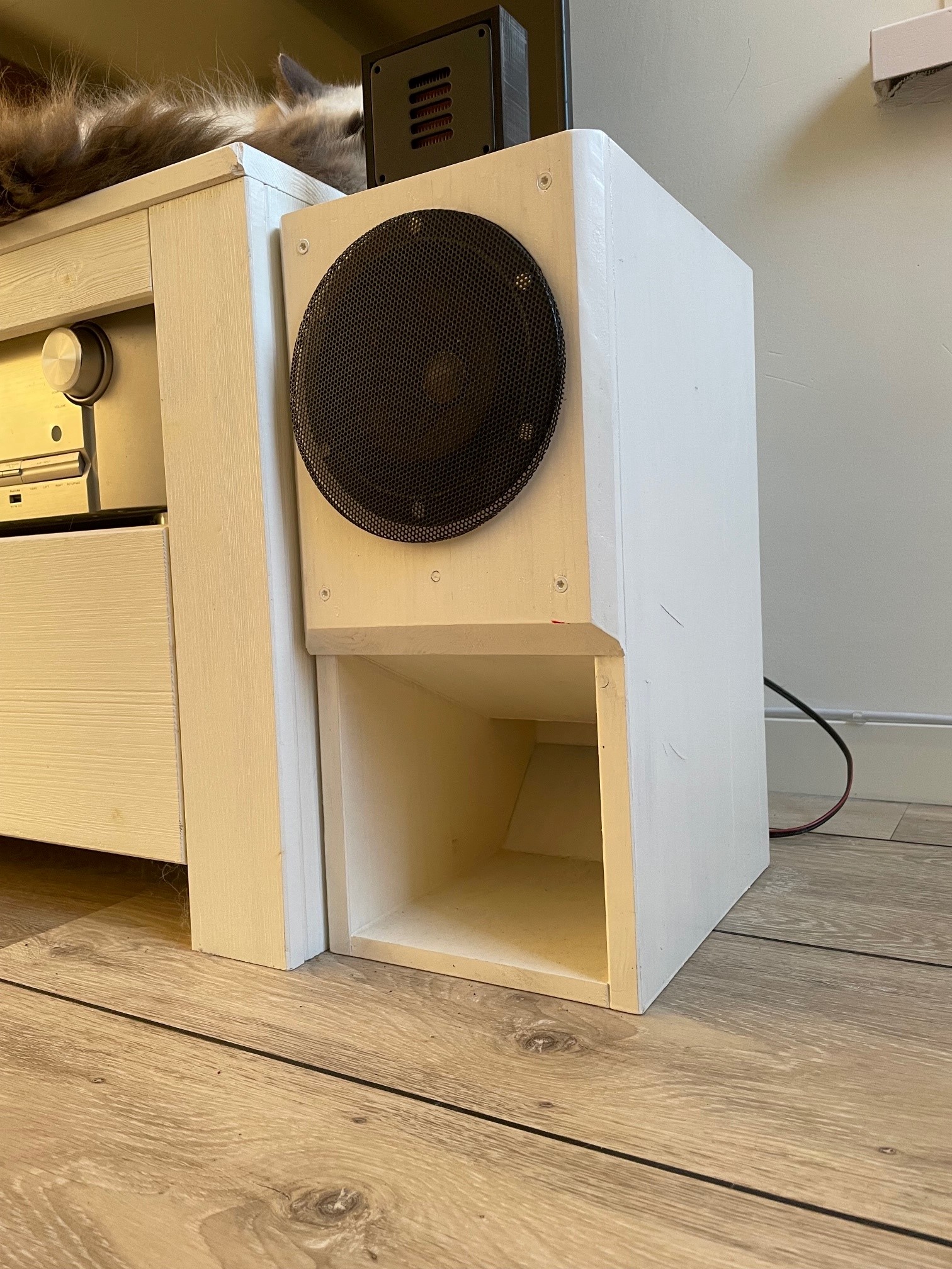

Hi Dave,
I am still struggling a bit with the sound from the 138ES. I want to try it out in the horn design you posted but wanted to check if this is the "final" version. Is it? If you have any other horn recommendation in this size range for the 138ES I would love to hear that as well!
Currently I have it in a miniature horn enclosure with a AM-20 supporting the treble, and a couple of notch filters to correct the worst bits. Putting the speaker a bit higher and mellowing out the horn response should help.

The FE138 was a dissappointment… it brought the screech to the Fostex Shout.
Have yours caled down?
I cannpt recall an FE138 box… clues?
We did put it in FH3 where the bass was superb, might be even better in FHXL.
A larger horn would need to be done, something between Valiant and Victor. Very, very little demand for that tho.
