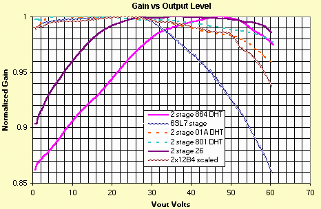

As mentioned above, differences have been measured. Attached a graph which shows different tubes gain variation with output signal level. All normalized to peak gain.
I shows that IDHTs have a slight loss on gain with signal level, which could result in s slight compression effect. Oxide DHTs have the opposite behaviour, slight increase in gain with level, which could be translated to a slight expander effect. Thoriated DHTs seem to be the best according to these measurements.
Thomas

PS very interesting graph in previous post - but does it show that some valves were used at the wrong bias point?
The graphs say nothing about bias points. I have not seen the setup or nmeasurements myself. As they have been doen by a very well espected and experienced persopn I assume bias points have been set up optimally for each of the tubes.

Change of gain with signal level indicates odd-order distortion. Something which is flat at first, then goes down (or up - but less likely) shows low amounts of odd-order distortion but perhaps at high orders (depends on the shape of the curve - the sharper the knee the higher the order). (see 801, 01A, 12B4 in graph)
Something which is rising or falling at first shows high amounts of odd-order distortion but perhaps at low orders (e.g. mainly third). If it then levels off this indicates higher orders coming in too. (see 864, 26)
The 6SL7 looks good at first, then suddenly hits a knee - start of clipping?
Accepting that the graph tells us nothing about even-order distortion, it may show why the 12B4 is so popular - it has low and smooth odd-order distortion.
DHTs look a mixed bunch - some very good, others quite bad.
