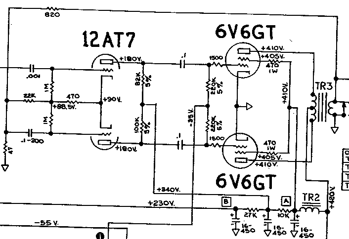

Nice discussion, this provides some great opinion and info, I'll hopefully do this design at some point and see how it turns out.
For the one I'll be working on this coming week, the hi-fi design, it was based on the output transformer Stancor A-3311 10K center tapped primary.
If I use a Hammond T-1609 should I favor 8200 or 11600 as a primary setting, since there are several choices?

Concerning the NFB, take a look at this schematic - the power amp of a black face Deluxe. The NFB is applied to both the unused LTP input and the bottom of the tail resistor. This is not obvious. How they came up with it, I don't know, but clearly they felt that it was better (sounding) than the obvious method, which they no doubt tried as well. Not "just copies of datasheet circuits."

Well maybe it just seems like very basic theory to me then. NFB to the grid as normal, then a little bit to the tail to improve the CCS effect of the resistor to improve balance.

Merlinb said:Well maybe it just seems like very basic theory to me then. NFB to the grid as normal, then a little bit to the tail to improve the CCS effect of the resistor to improve balance.
I have to admit, I don't see how applying the NFB to the tail improves balance.
In any case, the way I think of it is that the NFB is first applied to the tail. If everything were perfect that would do nothing at all. It's a common mode signal; it is effectively applied to both inputs of a differential amplifier. The 'fix' is that the unused grid is referenced to the bottom of the tail resistor and not to ground. The consequence is that the NFB is now applied to the upper grid, the one that also receives the signal.
My suspicion is that Fender wanted to use the feedback signal to gain a little headroom at the input to the LTP. Let's see ... at 20W the speaker terminal would be swinging about 12.5V rms. The 820/47 ohm voltage divider would bring that down to about 0.68V rms or almost a full volt peak. That means the LTP could handle almost a full volt more input before clipping.
Again, I admit that I don't see how applying NFB to the bottom of the tail resistor improves balance. Maybe you can help me out with that.

Anyway, first of all the feedback is to the 2nd grid of the LTP. That's where most of the action happens. It's still possible to do this without connecting it to the tail, and you probably wouldn't hear any difference if you did do it that way.
Here's a half decent explanation:
"...you are injecting feedback into the tail resistor, which is sent to both grids: the typical setup has all the grid grounds tied to "virtual" ground potential at the bottom of the tail resistor (remember: your input is bootstrapped, as well as the whole stage being bootstrapped by virtue of the tail resistor). The grid that the feedback is applied to is tied to ground potential by (typically) a .1uf cap that is where you are referencing the feedback loop. The NFB signal is fed partially through the tail resistor to help balance out the uneven voltage gains of the differential halves of the LTPI that is caused by the introduction of the negative signal. The tail is "split" to provide an easy point to add a voltage divider that will not upset the equalizing effect of injecting some of the negative signal through the bottom of the tail resistor.
So intranslation; If you had a better-balanced LTPI-- like say adding a CCS instead of a tail resistor-- then you can reference all of your grids to chassis ground, and you don't have to inject NFB anywhere but the second grid. Then you can make the grid reference resistor any value you like and adjust the feedback resistor according to your open loop gain"
Garage Amps said:OK but wouldn't applying the feedback directly to the upper grid (but taken from the other end of the output transformer secondary of course) have the same effect on 'headroom'? Intuitively the tube just sees the potential difference between its grid and cathode.
I had been thinking about it, and I think you're right. The reason for this has to do with the way the cathodes in a LTP 'follow' the grids partly. If you apply +1V DC to one of the grids it will cause the voltage at the cathodes to rise 0.5V. Instead, if you apply a 1V AC signal to one of the grids then you'll see a 0.5V AC signal at the cathodes. The result of this is that the headroom (before the grid goes positive) is twice the bias voltage. [Disclaimer: this is precisely true only if everything is balanced; perfectly matched tubes, identical plate resistors, infinite resistance in the tail, etc., but it's still close even in the circuits we're talking about here.] This explains why the LTP has only half the gain of an ordinary grounded cathode stage, but anyway ....
So what happens when NFB is applied to the other grid? If we make the simplifying assumption that the amp is producing little distortion to begin with then the feedback signal is essentially identical to the input signal. The 1V peak NFB signal that I mentioned earlier will result in 0.5V peak signal at the cathodes. Since this is in phase with the input signal it is something like providing 0.5V additional bias. As explained above, the extra 0.5V bias gives the input tube an extra 1V of headroom.
All of this ignores nonlinearities so is rough, but it gives us a good first approximation.

Merlinb said:Anyway, first of all the feedback is to the 2nd grid of the LTP. That's where most of the action happens. It's still possible to do this without connecting it to the tail, and you probably wouldn't hear any difference if you did do it that way.
I disagree. The way I see it, if you don't apply it to the tail (by connecting the bottom of the tail resistor directly to ground instead of to the top of the 47 ohm feedback resistor) then you'll end up with positive feedback, not negative.
"...[snip]...The NFB signal is fed partially through the tail resistor to help balance out the uneven voltage gains of the differential halves of the LTPI that is caused by the introduction of the negative signal. The tail is "split" to provide an easy point to add a voltage divider that will not upset the equalizing effect of injecting some of the negative signal through the bottom of the tail resistor.
I don't see the tail as 'split.' Looking at the schematic I suppose it appears that there's a 22047 ohm tail resistor with a tap at 47 ohms, but applying the NFB signal to the tap does not mean that only 47/22047 of the signal is applied to the cathodes of the LTP.
I don't see the NFB being partially applied to the tail, I see it totally applied to the tail. The entire tail is sitting on top of the 47 ohm feedback resistor, at least 99.8% of it is. The cathodes of the LTP and one of the grids see exactly the same NFB signal.
Also, and this is important, I still don't see how applying NFB to the tail, partially or totally, has an equalizing effect. It seems to me that any feedback scheme used to balance the splitter would need to be local to the splitter. The feedback signal taken from the speaker terminal can't know which part of it is due to splitter imbalance. I'm fully prepared to be educated, but so far it isn't happening.

Merlinb said:(remember: your input is bootstrapped, as well as the whole stage being bootstrapped by virtue of the tail resistor).
OK, after rereading a comment made by Brian Beck in another forum this is starting to make sense. If the diff amp were driven at both grids with identical out of phase signals there would be no signal appearing at the cathodes (ignoring HD and imbalances in the circuit.) But, applying the input to only one grid means that there will be a signal at the cathodes. That's the way the LTP works.
Applying a signal of the same phase to the bottom of the tail resistor bootstraps it (the tail resistor) making it appear larger. One way to understand this is to realize that the AC signal voltage across the tail resistor is smaller. Say we start with 1.5V AC at the cathodes resulting in 1.5V AC across the resistor. Ohm's Law tells us there will be i = v/R = 1.5/22k = 0.07mA of signal current through it. If we apply 0.5V AC to the other end with the same phase, then the voltage across the resistor will be only 1V. Now the current through it will be about 1/22k = 0.05mA.
OK, from the perspective of the cathodes, they're producing 1.5V and giving up 0.05mA. To them the tail resistor looks like R = v/i = 1.5/0.05 = 33k ohm. Now I get it.
Note that I pulled the 1.5V and 0.5V numbers out of my butt. The actual degree of bootstrapping depends on the actual amount of feedback applied and I'm not motivated enough to figure it out at this point.

Now I'm thinking that this might not be the case. If the NFB were applied directly to the cathodes from a low impedance source then the full signal voltage would be seen by the LTP. Applying it through the large tail resistance means that it is reduced by the voltage divider formed by the tail resistance and the input impedance of the cathodes.
Let's see, the resistance looking up into one cathode is something like (rp+Rp)/(u+1). With the 12AT7 we have rp=11k and u=60. The Rp's are 82k and 100k. So both cathodes in parallel present a resistance of around 830 ohms and the NFB signal there would seem to be divided down by a factor of 830/22k = 0.04 or 28dB. This is the basic function of a current source which is what the tail resistor is supposed to be in the first place.
Thanks, Merlinb, for forcing me to try to figure out what's really happening. I'm learning something, I hope someone else is too!
