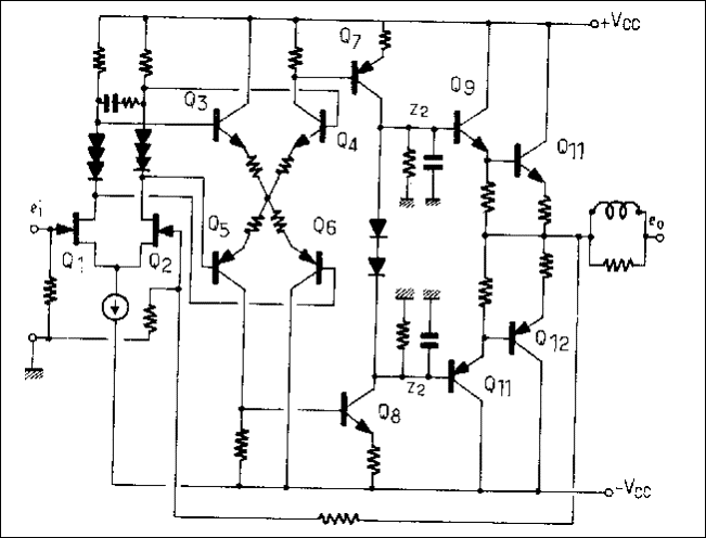

Other amps that use a "diamond transistor" type output stage are Marantz 300DC, 170DC and possibly the 240 (I'd have to look). The Nakamichi 620 is also done a similar way. This Sansui is a little different though.
The "signature" of this design is wonderful detail, the most delicate sounds are presented beautifully. I've been working on a variation of this for a few years. A BUF634 is a good model.

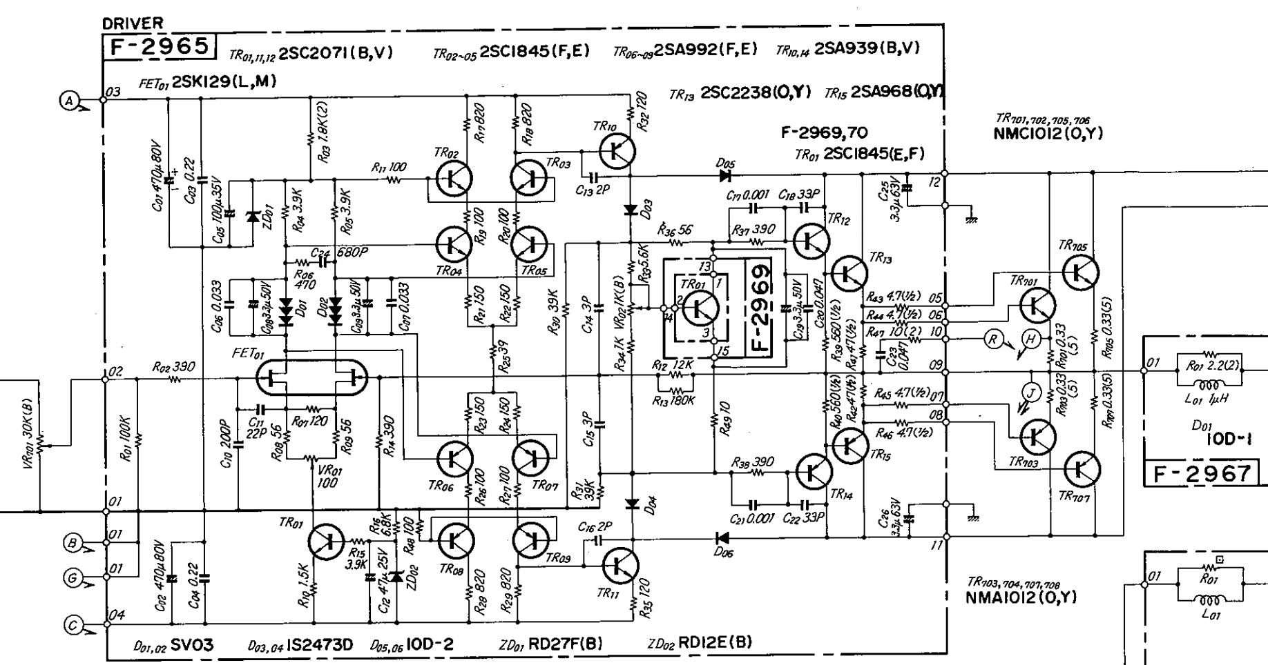

I do also have this Sansui BA-F1 beast, really great.
I did have problems on power supply, as i saw it have two voltage comming, symetrical for main power, and symetrical thrue soem transistors on power supply board, I did set everything except I have distorzion on one channels, and i don't have original output transistors because somebody RIP them.....
Also if someone have schematic of amplifier part can be uploaded here or emailed?
thanks!

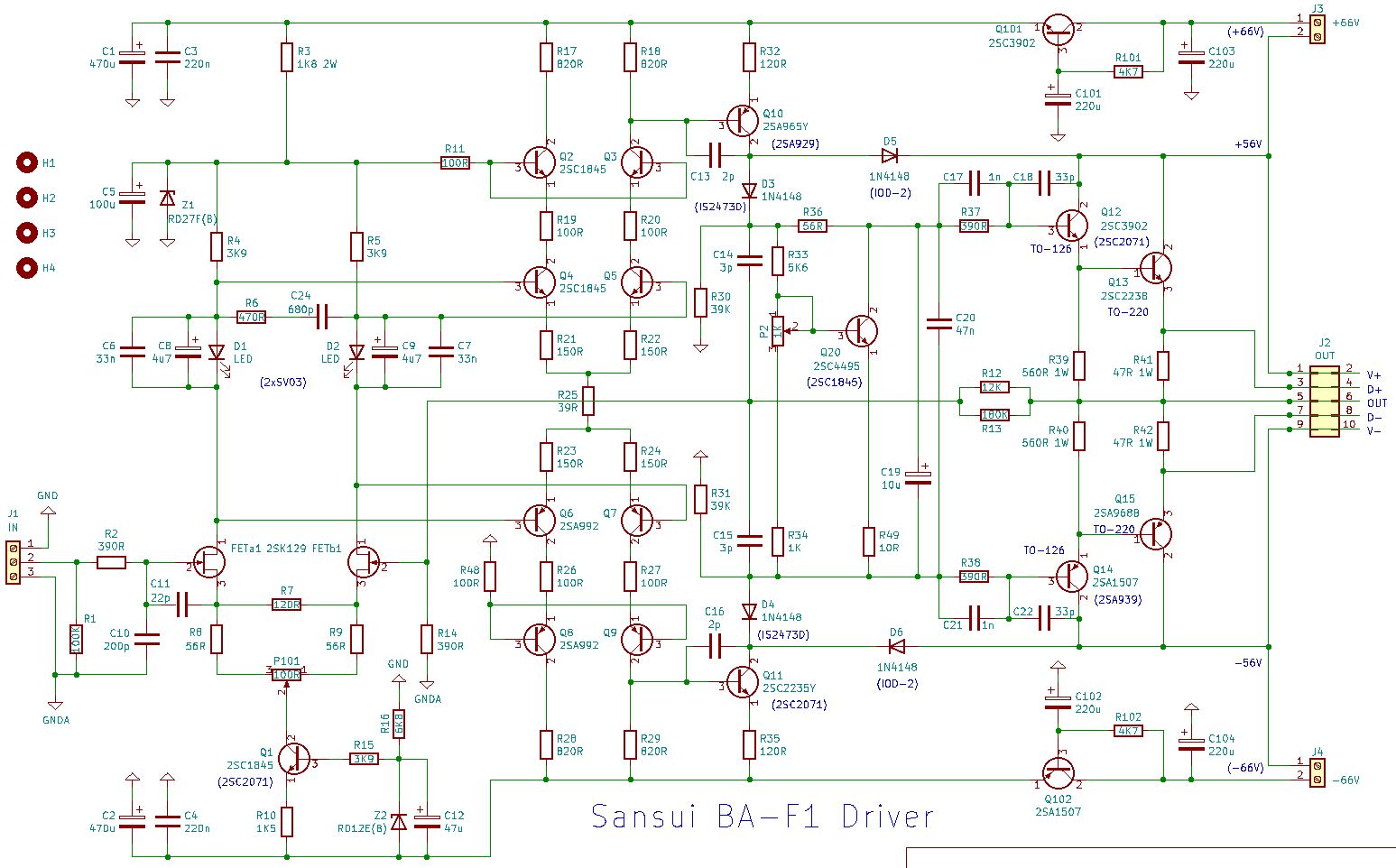

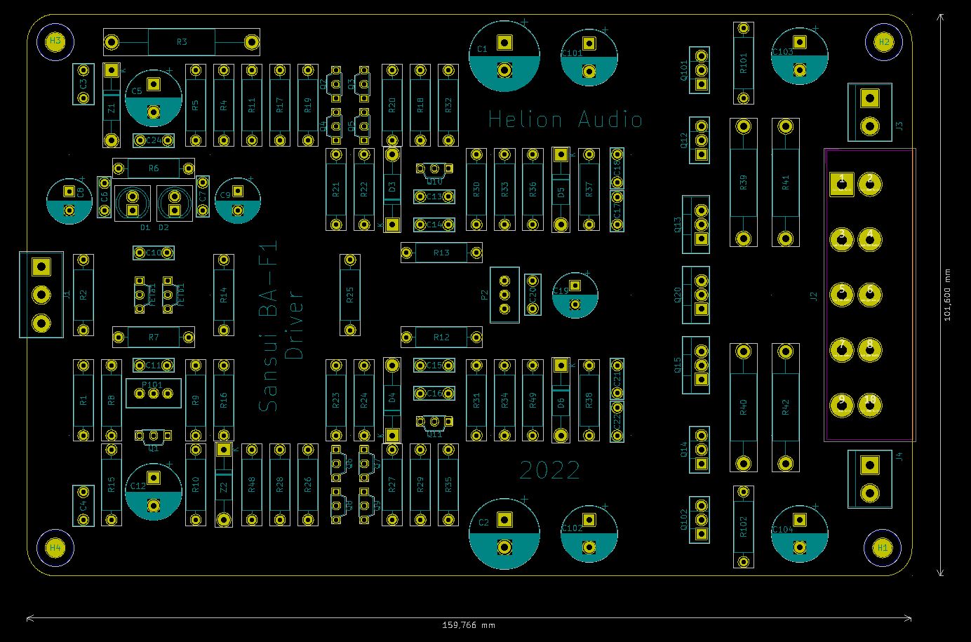

Hi! I suppose this thread is obsolete now, but as I recently made a driver-version of this amp, I thought I would share.
Original schematic is enclosed for comparison.
I am looking forward to building this!
