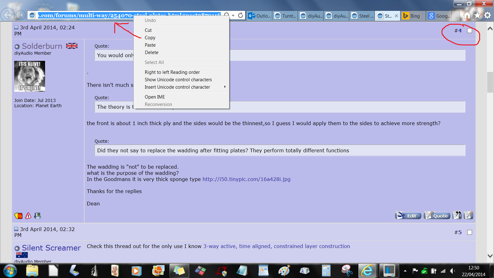

Mooly suggested I put a link in from this thread ( do you know how do do that).

Thank you Mooly for the instructions :)

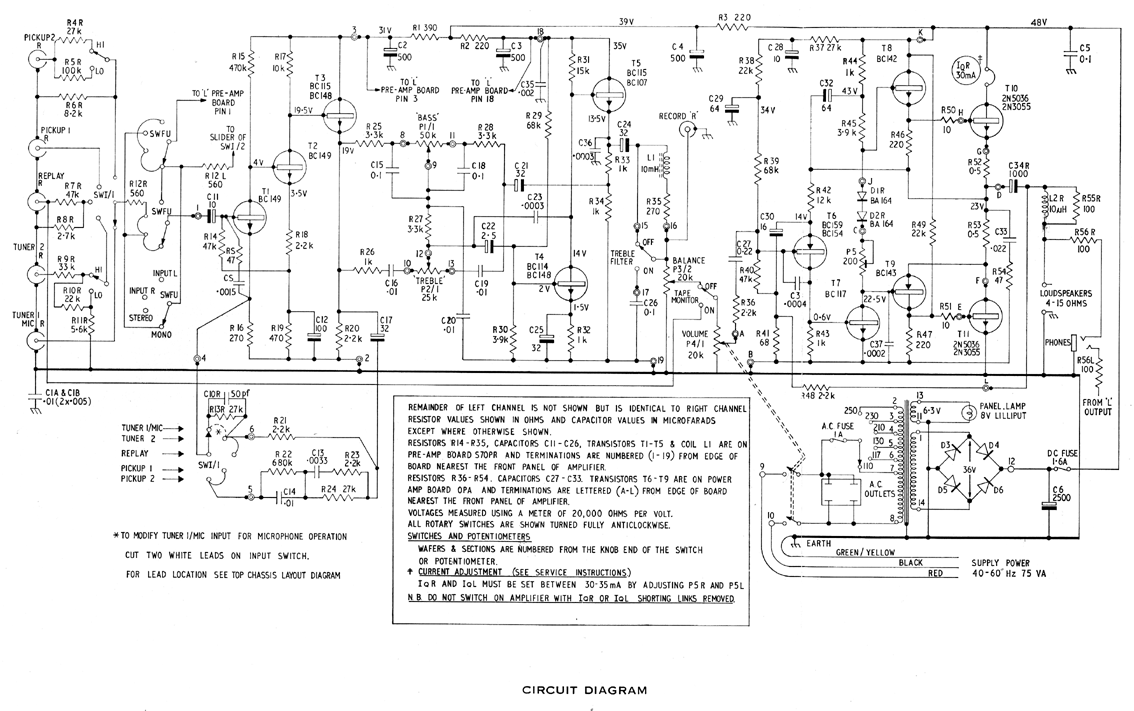

Meanwhile, here is the schematic from Leak Circuits
The big silver cap is marginal on voltage rating (probably why its leaked a bit - I missed that) Make sure replacement is at least 63V
There is also another blue can cap at bottom right under three resistors (C2)

Thanks for your offer EssB, but I have one,it came with the amplifier .Unfortunately I don't know how to read a schematic, so it's of no use to me.
You're right there is another cap next to the taller blue one, but I couldn't see any information on it:scratch2:
Do you know if I was on the right track with the link i supplied to that capacitor .
