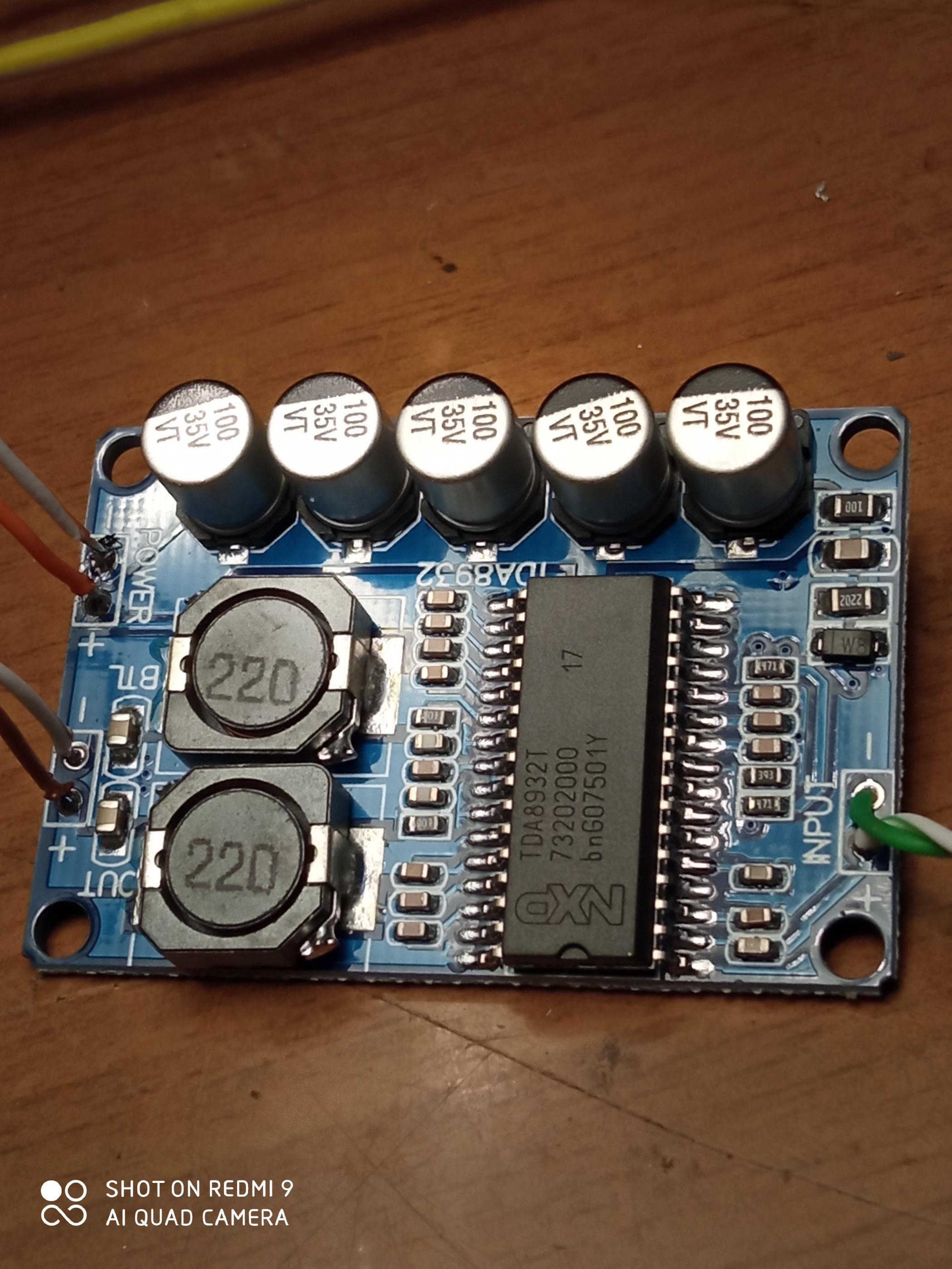

So in the meantime five pc. of this boards have arrived, as usual with Chinese items without any documentation . As each board represents a BTL amplifier, output terminals become clear: They're balanced w.r.t GND. But what's up with the input? Do I need a balanced signal or is an unbalanced one sufficient?

I just use an unbalanced signal input and found that connecting the power input grounds between the two boards slightly lessens the noise. I still get a bit of noise without a signal but everything seems tickety-boo when a signal is passed through.
Thanks to both of you, very appreciated! The noise supposedly is because there's no ground loop breaking resistor on these boards? I'll have to consider this when installing four boards into the Hammond clone organ project, as I plan to feed all those power amp boards and the sound engine from the same SMPS.

I got a couple of those "35W" TDA8932 mono boards, used 2 pcs for stereo. Found that they produce high pitch noise.
I tried a few things:
Seperate power for each module: No change
Add resistor at input: Reduce only overall noise, but high pitch noise remained as loud.
Any idea what may be the problem?

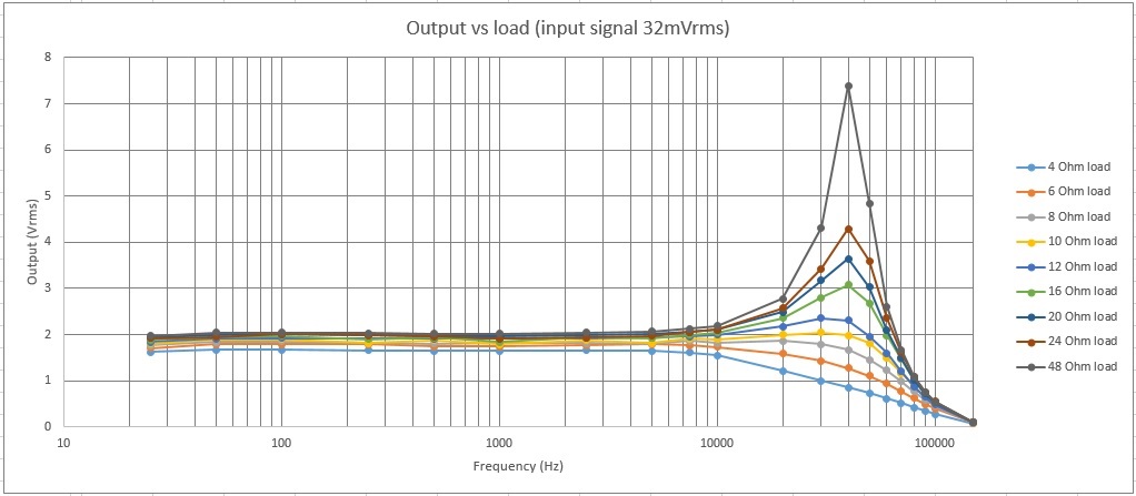

I took some measurements today
idle power consumption: 50mA @24V (1.2W)
No signal output (@8 Ohm load): 5mVpp approx 360kHz sinusoidal plus 20mV switching spikes containing damped 50MHz energy
Small signal frequency response (@8 Ohm load)
-3dB : 6Hz to 18kHz
-6dB : 3Hz to 42kHz
George

Does anyone know the schematics of the boards presented in posting #1? Does it conform with the one in Fig. 37, page 38, of the NXP TDA8932B datasheet?
