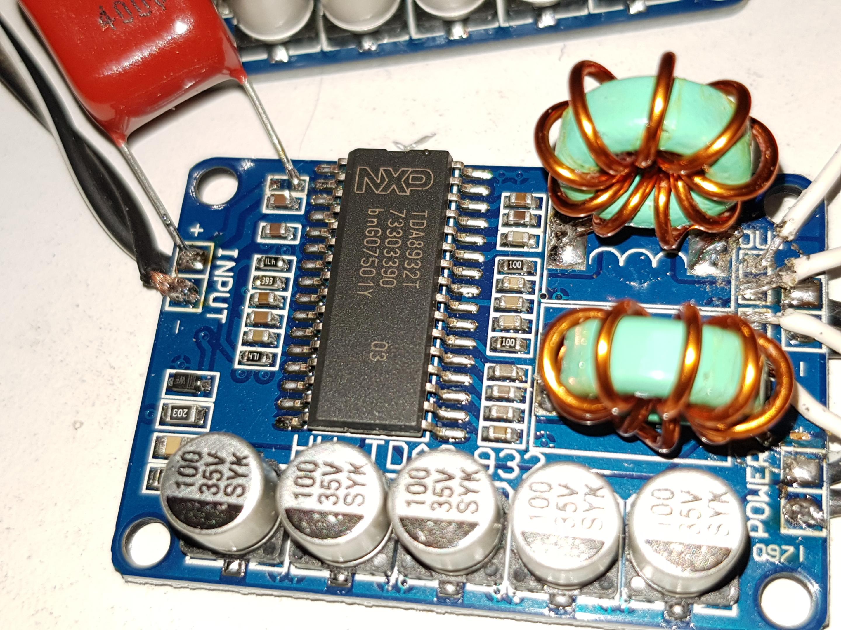

In the meantime I have modded the 8932's. I made my own chockes by wiring waxed copperwire on coils that I removed from another device. I needed only 8 windings to get a value of about 22uH. I replaced the smd capacitor by a 0,47 uF foil type. They are playing well, but I am not sure if the music quality is improved. I am thinking of modding the input filter too, but which capacitors shoudl be replaced and what values should I use?

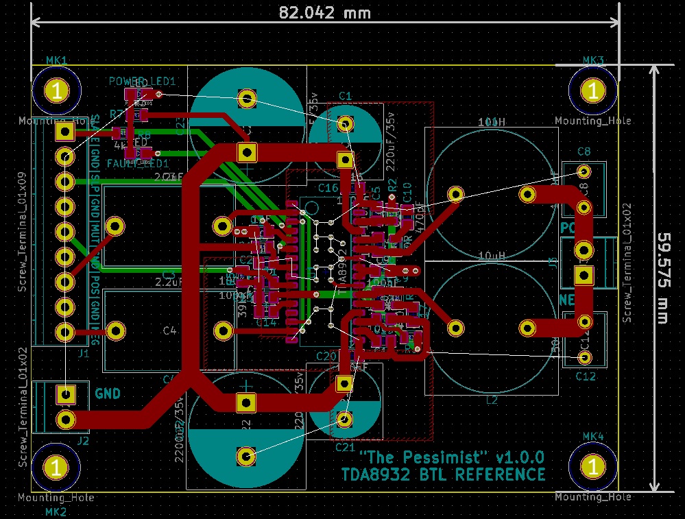

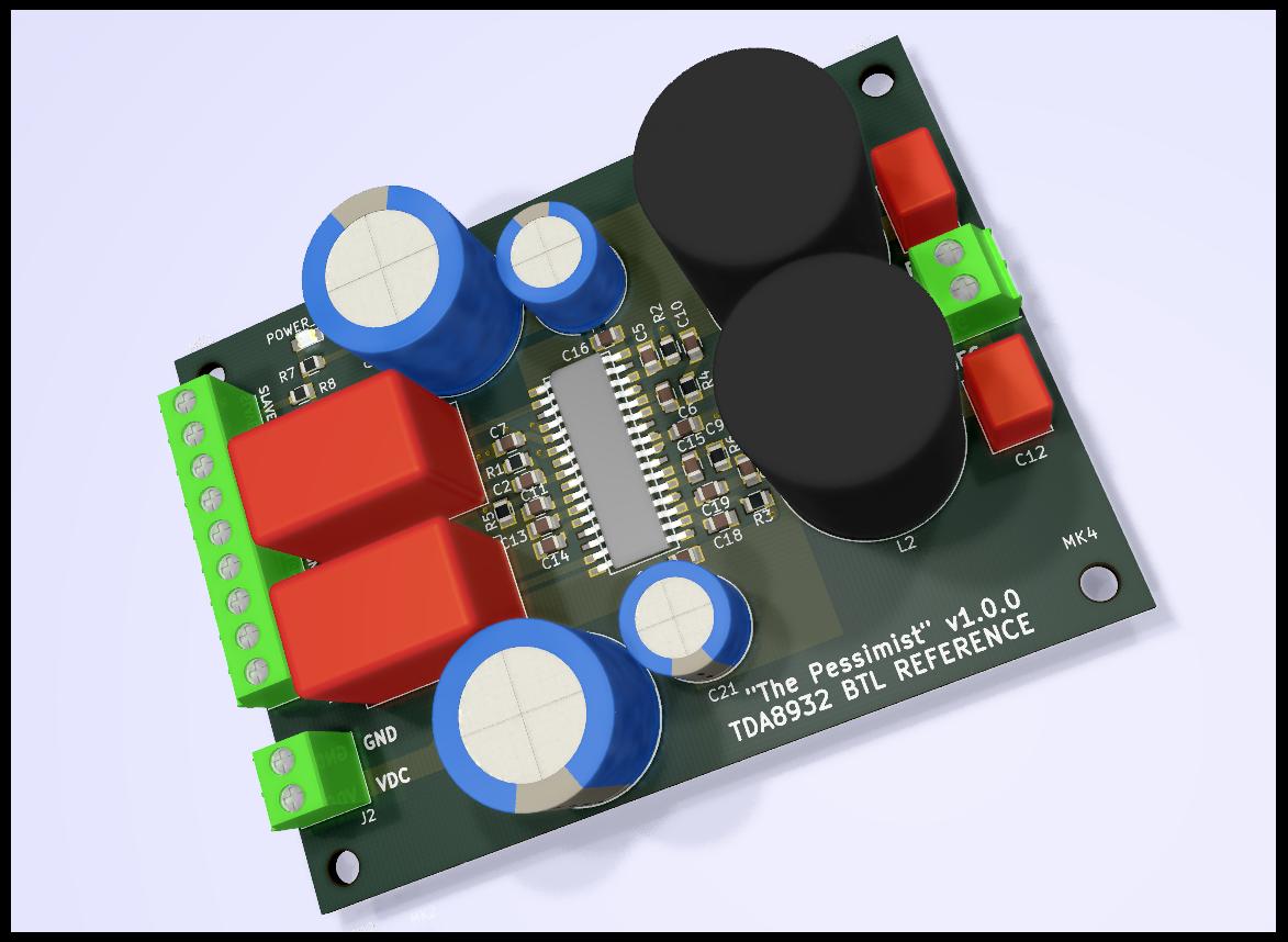

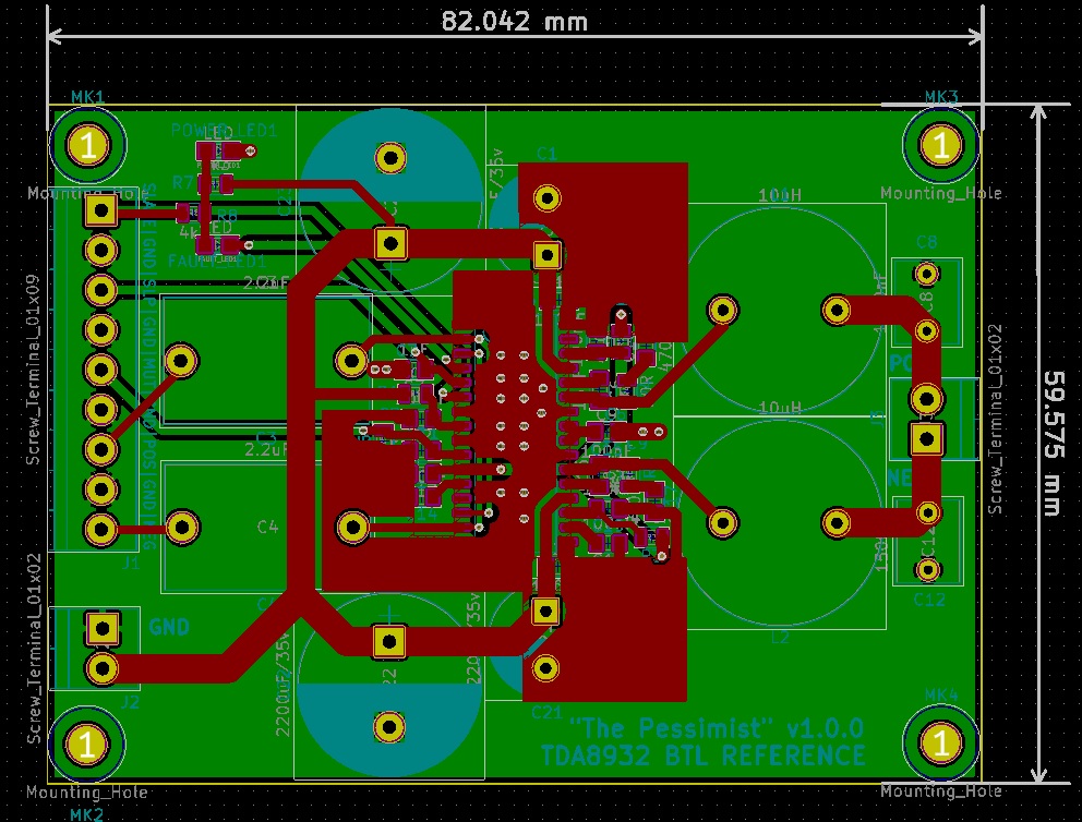

Creating a PCB for this chip has been on my todo list for a while, so I whipped up something pretty quickly. In honor of this thread, I call it "The Pessimist". The goal here is to be a basic BTL reference implementation (for single-rail PSU). The schematic is almost copied exactly from page 38 of the datasheet, with some obvious "inspiration" (ok, outright copying) from curtvm's design (post #455/page 46). I added space for more/bigger PSU decoupling caps.
If this works and seems decent, then I envision a version 2 with more features, tweaks, etc.
The schematic is in the attached PDF file.
Happy to hear any thoughts on the design and/or layout!

Seems very good: Foil capacitors on the input and output.
Comments:
You use 2.2uF as input coupling capacitors, NXP recommends 1uF.
You use a 10uH/1.5uF output filter. That is optimized for 4 Ohm. Could it be more universal with a 15uH/1uF filter optimized for 6 Ohm?
You use filter chokes with a physical outline I do not know.
Are the output filter capacitors really so much smaller than the input coupling capacitors?
I am one of those who cannot get enough power line decoupling. You have space to increase your 220uF decoupling capacitors to 1000uF. If you want to use the TDA8932 potential to its full, 6400uF is not too much I would say.

Hi Matt
A few suggestions with this, based on my experience of tweaking quite a number of 8932 implementations to optimize the SQ :
1) You won't need the 4 electrolytics ( C1, C21-23) on the main supply. Suggest just one 2200uF and put the two smaller ones where it really matters, on pin8. Or just go with one 470uF/35V on pin8. I'm assuming this is one of your 80/20 designs and you don't want to go to the trouble of a separate regulator for the pin8 supply :D
2) Add series resistors to the input pins (2,3, 14, 15) of 470R. This helps keep down RFI from being coupled to the inputs from the output wiring.
3) Increase the cap on pin12 to 470uF/6.3V. Improves the already extremely good bass.
4) Add 1M resistors across C6,C15. This allows using the non-B variant of the chip.

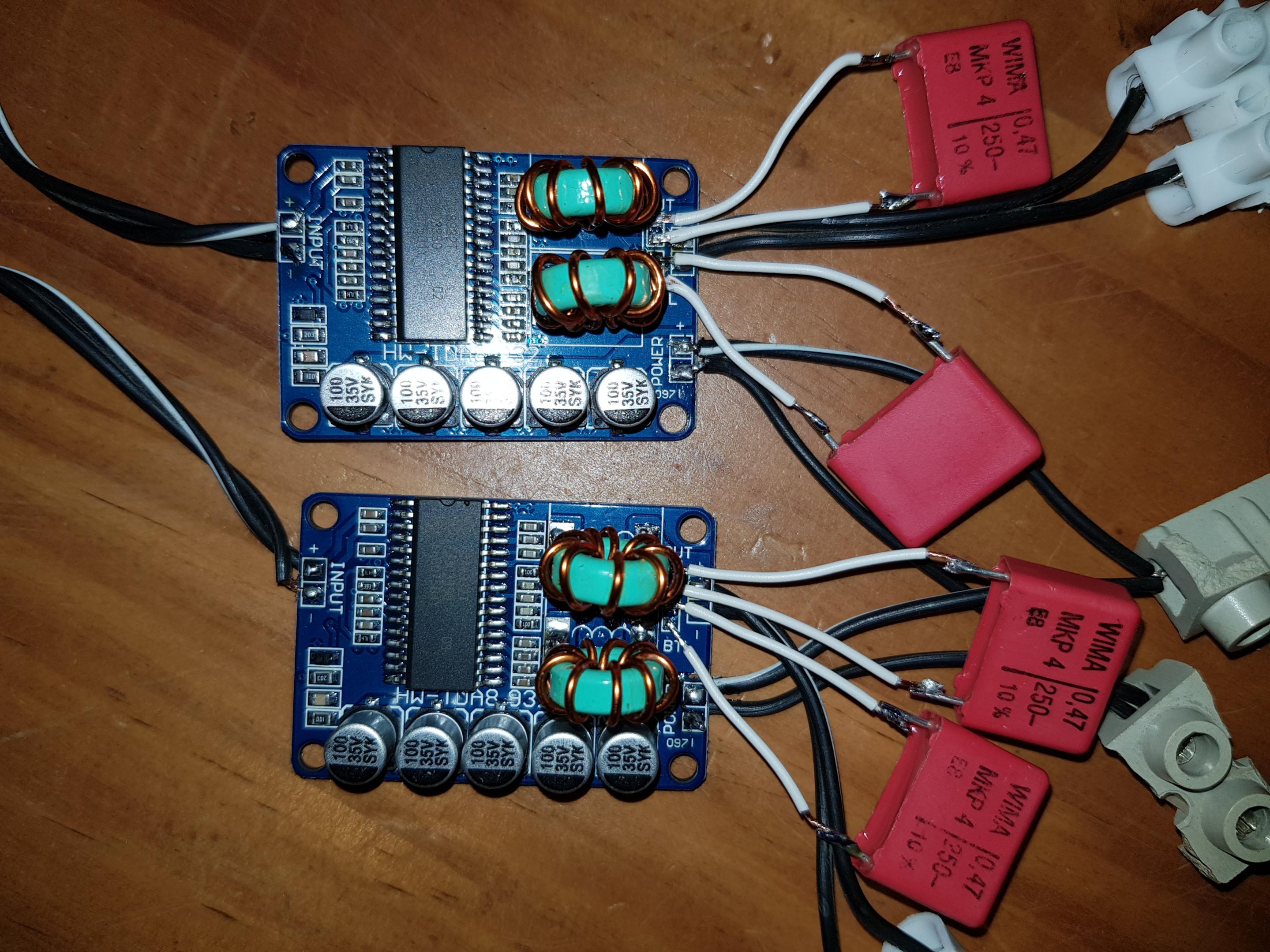

I replaced the input capacitor by 1 uF foil capacitor (see picture). I did some more listening tests and have some observations:
- The chokes are getting pretty warm. I have a laser thermometer and measured 50 degrees Celcius at the core
- There is a problem with the sound: especially with loud passages there is some distortion in the mid. This is recognizable with voices. The bass and treble seem not to be affected.
I suspect the chokes that I winded myself. Perhaps the core is not suitable for this appliance. I saw some considerations regarding the chokes on diybudgetaudio. This small amplifier needs suprisingly heavy chokes that are difficult to find with prices that are higher than the amplifier itself. Can you recommend?

I bought a number of those yellow-blue'ish chokes from out east and tried more of them in class D output filters. In best case they started getting warm, in worst case they affected the sound (negatively) of the amplifier. The cores seem to have high losses and the permeability at higher frequencies may drop. I haven't had time to set up a measuring circuit. My conclusion is these yellow-blue'ish cores are no good for class D output filters.
Mine remain in the drawer.
I have better experience with these 15uH/15A chokes:
5pcs/KS065060 17MM Iron silicon aluminum 15UH 1.2 Line 10A Magnetic ring inductors Annular inductance-in Inductors from Home Improvement on Aliexpress.com | Alibaba Group
And, I recently made a filter with these chokes (also 15uH) which works very well:
2pcs/SMD Integral forming inductors 1770 15UH 12A Saturated 20A 17*17*7MM Printing:150-in Inductors from Home Improvement on Aliexpress.com | Alibaba Group
I have now ordered 22uH SAGAMI inductors I expect to work well:
10pcs new Digital amplifier dedicated shielded inductor 7G17A 22uH -in Replacement Parts from Consumer Electronics on Aliexpress.com | Alibaba Group
Yes, a good filter costs more than the ("dirt cheap") amplifier. The amplifiers are spit out by a robot without a break, the chokes may require human intervention. It is probably the amplifier that is particularly low priced rather than the chokes being particularly expensive, at least from a European perspective.

Thanks for your suggestions. With all these options a core is used that can saturate. Why not use aircoils like they are used for passive crossover filters? At low values they are affordable Luchtspoel 0.70mm - RumoH - Caps, Coils and Speakers You can unwind them till you get the right value.
I mainly did that just to induce a slightly bigger capacitor footprint. I was trying to strike a balance between flexibility (which typically calls for lots of space) and smallish footprint. Also, though the math says otherwise, in one of the tpa311x threads, people claimed bigger input decoupling values improved bass.
Of course, the footprints "should" support any output filter values you want to use. I assumed 4R speakers because that's what I'll be using. :) But since this is a bare board, the user can populate the right filter values for his speaker load. When I get ready to have these fabbed, I'll write a BOM with notes on component selection.
Those are 18mm radius, 10mm lead spacing footprints. I had something like the Coilcraft RFS1412 series in mind. Although looking at that DS now, I see those are only 13.5mm diameter, not sure where I came up with 18mm.
At any rate: my thoughts on the inductors were, just give enough space for something decent, i.e. better than the likely-underrated ones that come with the cheap boards from China.
Definitely worth further discussion/investigation. I need to find the tpa311x thread where doctormord did a bunch of inductor testing, and maybe go with that. My goal here is to have something that meets the current (amperage) requirement; is easy to obtain; and not expensive.
Yes, because I was assuming polypropylene caps for input, which tend to be bigger; and polyester for output, which tend to be smaller.
The bigger caps are 16mm diameter. A quick Mouser check says you can get 35v rated electrolytics up to 6600uF (e.g. United Chemi-Con ELBK350ELL662AL40S). And there are lots available in the 3300-4700uF range in this footprint.
This may not even be as ambitious as an 80/20 design. :) This is a warm-up exercise, I don't want to stray too far from the datasheet. Basically, I just want to be one step above the cheap ebay/aliexpress stuff. That is, a schematic is provided to avoid guesswork and surprises; use your own components to avoid fakes or under-rated parts; use your own solder for easier modding.
A dedicated pin8 regulator is definitely version 2 material, but an extra cap here or there probably doesn't break the design philosophy too much.
Easy enough. Version 2 will have pads for gain-setting resistors as well.
The DS shows a 100nF cap there. Should that remain? When I see tiny ceramics like that, I just assume the main purpose is HF filtering...
When using the B variant of the chip, should those resistors simply be left off?
I haven't taken a look at the layout, I'd rather spend that time on my own design which has been languishing at the post-placement stage for about a month :eek:
Thanks for your feedback! I don't think the layout is anything special, as the main intent is to be a simple reference design. Hopefully it doesn't make any glaring errors.
Personally, the idea of a considerable "leakage" field from air-coils does not appeal to me. But, I have seen more apparently serious constructions made with air-coils so I cannot state it won't work well. If you do not try, you won't know.
Let us know if it works well.
At least also I have bad experience with the yellow-blue'ish toroid cores and they should be changed.
When I buy rather unspecified chokes from out east, I know I take a risk on the non-specified parameters of the cores. Some you win - some you loose.
