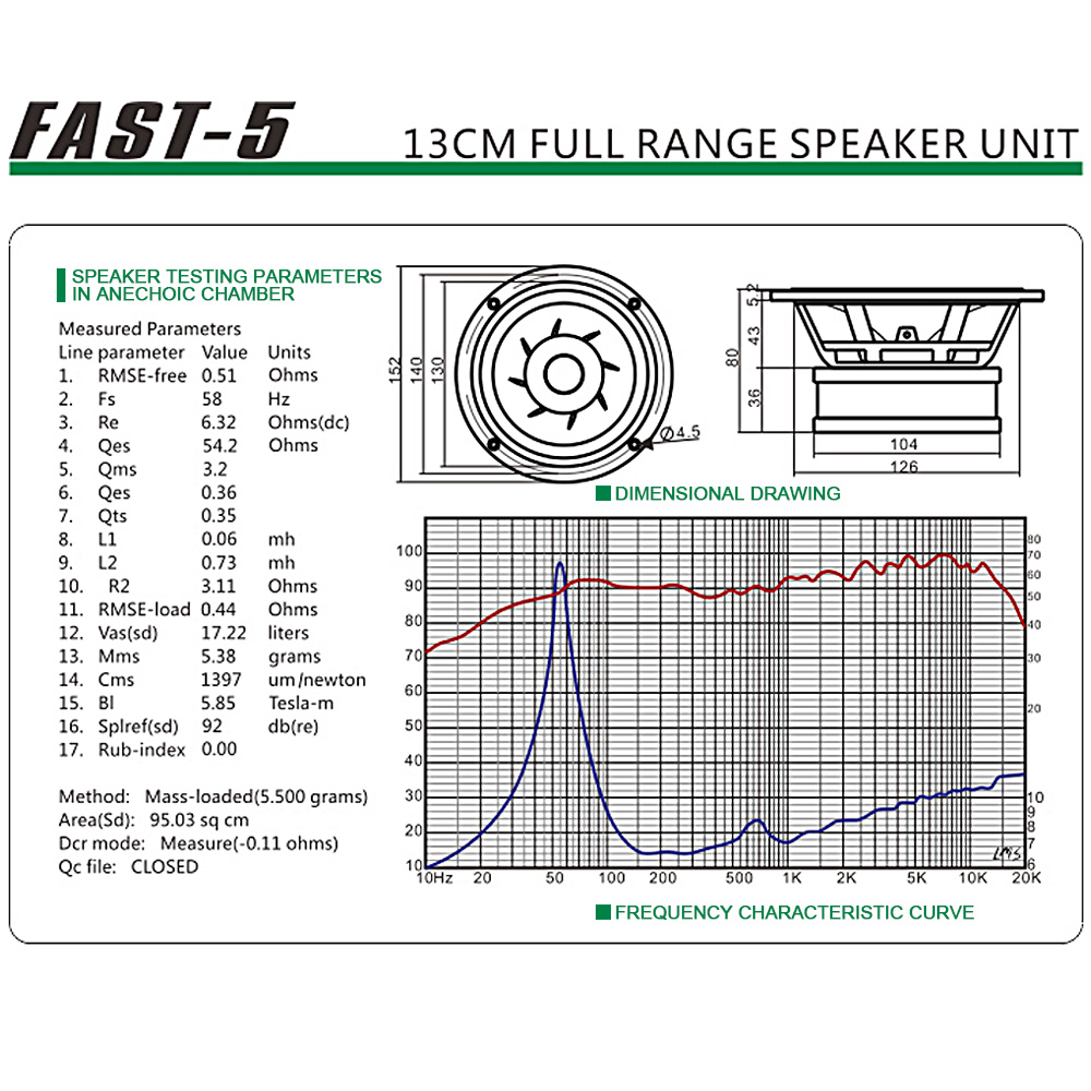

The TSP have already been posted, but here again, together with first REW measurements:
Loudspeaker freestanding in the room, 0,3 m distance, on axis, with an uncalibrated Superlux 999 micro and a Steinberg URL soundcard, both should be OK up to 10 kHz and possibly further, as per measurements from others.
Let´s see: both units vary for approximately 1 dB, that´s OK. Both units have trouble at around 10 Khz, clearly visible with the impedance sweeps, with the frequency sweeps, and in the distortion plots as well (k3 at 3,3 kHz).
The TML and especially the damping method seems to work quite well, as the third frequency sweep (main driver lightly shielded from micro, loudspeaker upside down) indicates.
