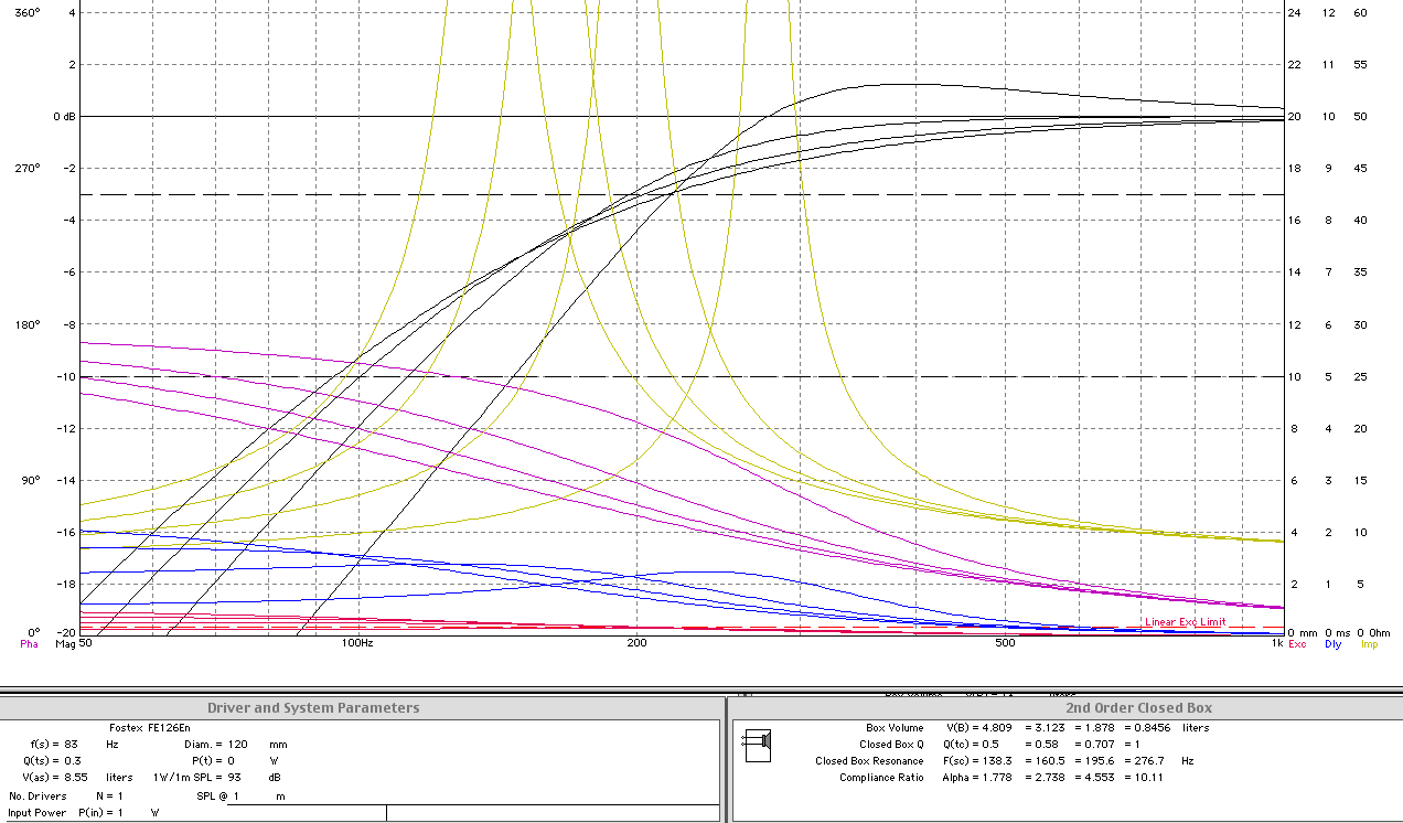

It works nicely in a small sealed box for this kind of application. To take advantage of the natural 2nd order roll-off (~200 Hz) you should consider active.
dave

I know that Dave, I don't know why I said 3". I have had this driver in a 2 liter box for a long time and it sounds quite nice. If I do a 100 liter or so bass reflex box for the Swan and incorporate a 2 liter mid-chamber for the Fostex, I think I will just install the banana inputs as driver inputs. then I will be able to build the "passive outboard" or go active.
