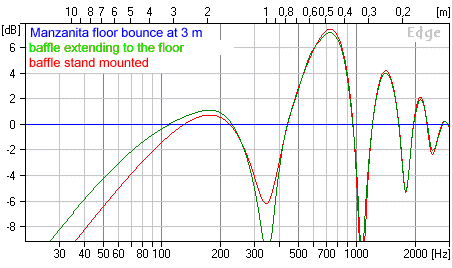

One question, why is the baffle height 28"? Puts the speaker between a floorstander and regular bookshelf. Do you propose standing it on the floor or is it meant to go on a stand bringing the vifa at ear level ~ 36"?

The Manzanita is intened to be a stand mounted design. 28" provided the best balance of baffle area, but small enough to handle. Need to get the woofer a bit above the rear crossover plate to minimize close reflections at the upper end of the woofers range. Also, getting the woofer off the floor minimizes floor bounce issues. I have found the system to sound the best with the Vifa 38" - 42" off the floor and 48" from the rear wall. Exact baffle height is flexible, but much shorter than 27" and you start effecting the f= and F peak of the Vifa. Not good as the crossover is set for the current dimensions. Hope this info helps.

Yes, there is harm. There is floor bounce that is avoided by the gap between baffle and floor. The tonal balance will be wrong.
Now, how is this possible ? The floor bounce is going to be there regardless of whether you have baffle under the bass driver or not. It may be at a different frequency, but it will still be there.
At several 100's of Hz (where it crosses over to Vifa, although it will go higher than that, there is huge overlap), wavelength is still in meters. Can it really be such a huge difference whether you have the baffle extending to the floor or not ?

Thanks for the reply, John. I don't have EDGE in front of me right now, but I would imagine the response of the vifa driver would not be affected much by extending the baffle down below. The greatest change would probably occur in the bass response of the woofer.
As Rudolf has shown, the bass extends a little deeper, with slight gain in efficiency, which is what you would expect with a larger baffle. And I also understand that it will probably mess up the target response in combination with the crossover values and design.
But what I'm trying to understand is why you have designed it in this way. I have great faith in your design acumen and I'm sure there is a reason to go through the pains of making a separate stand instead of just extending the baffle. So, John, what is the effect or combination of effects that you have designed into the woofer position and baffle dimensions?
Pano, why would the floor bounce not be there?

The interest in my baffle configuration decision(s) is a bit surprising to me. I made quite a few heavy cardboard prototype baffles. All sizes and shapes. Various wing depths, shapes. Various woofer and tweeter positions. A couple of things stood out during that process.
When the woofer was close to the floor it's response was quite uneven, both audibly and measured. And with larger width, taller baffles I noticed a large peak in the 52-56 Hz area. The greater the total baffle area, the greater the peak. Moving the woofer upward helped a bit. I also noticed that as the baffle narrowed and the woofer was placed 24-30 inches off the floor, the sense of stored energy was reduced by a great deal. It just sounded more natural and balanced and the sound stage also improved. By getting the woofer up off the floor was a kin to adding more distance from the rear wall in terms of sonic performance. I can measure and speculate until the cows come home as to why. But my intuition tells me that when the woofer is closer to acting like it is in free space, (as on a small baffle up off the floor) it is less influenced by reflections from near by surfaces such as the rear wall and the floor. You have to remember that the larger the baffle area is, the more the wall and floor bounce energy will be collected by it. Like it or not, the area behind the baffle forms a cavity at lower frequencies with the rear wall. The bigger the baffle, the bigger the cavity. Long wave lengths act that way in a residential sized room.
Anyway, I made the Manzi baffle large enough to provide some woofer loading, keep the woofer above the rear bass plate to minimize close reflections and still have enough real estate left to optimally load the Vifa in terms of target F = and F peak.

Very curious observations John. In the other thread, http://www.diyaudio.com/forums/mult...-directivity-pattern-stereo-speakers-177.html, it was determined that positioning the woofer next to the floor is one way to eliminate floor reflection. It is interesting that you prefer the woofer off the floor.
You mention that moving the woofer up off the floor is akin to more distance from the rear wall. This, to me, means that when the woofer is on the floor, the early reflection from the floor that is blended with the direct sound from the woofer is more audible (and annoying) than the deep notch produced by the woofer when it is off the floor.
