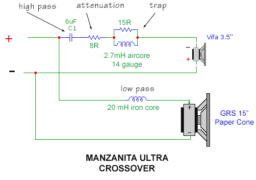

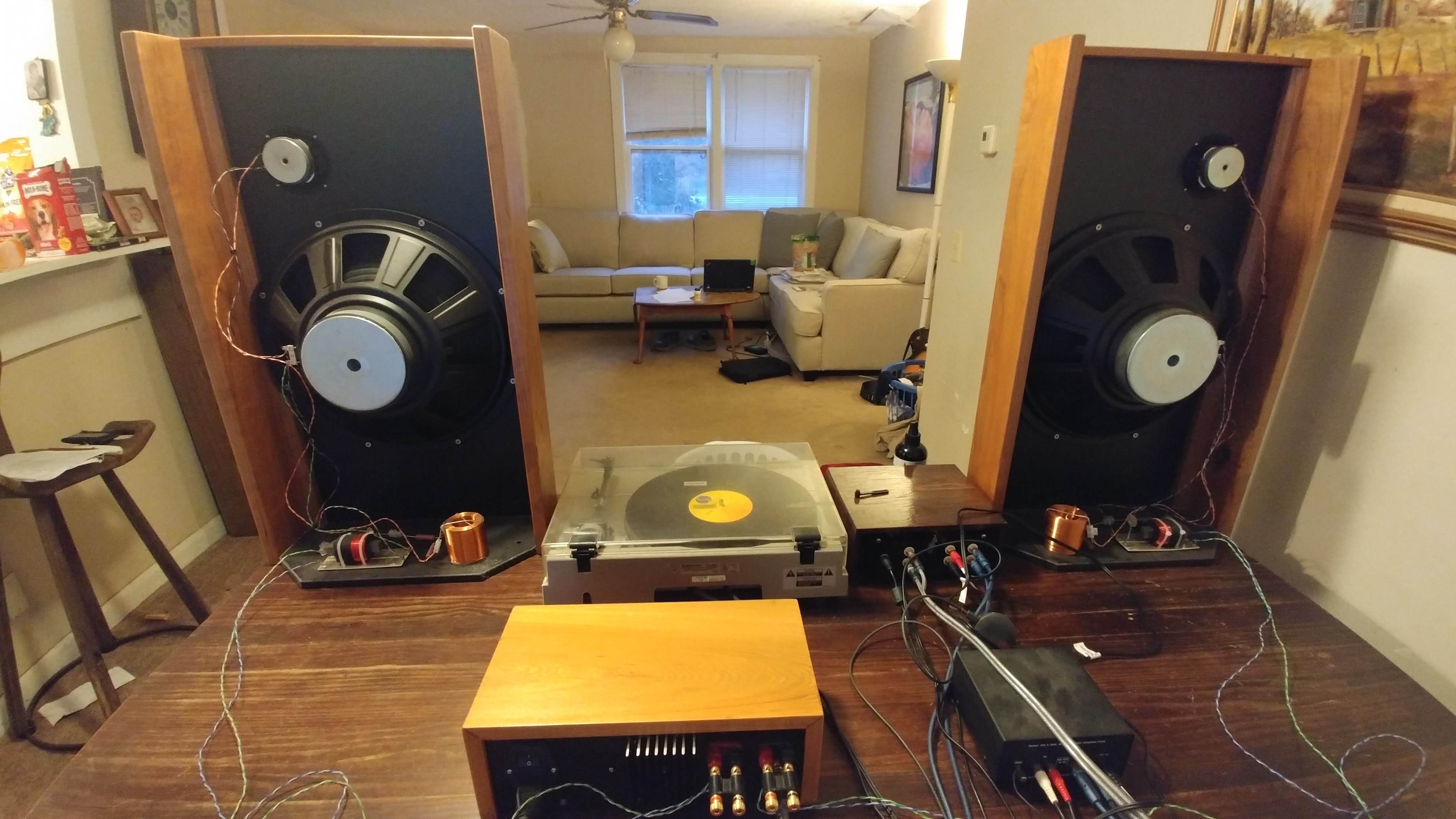

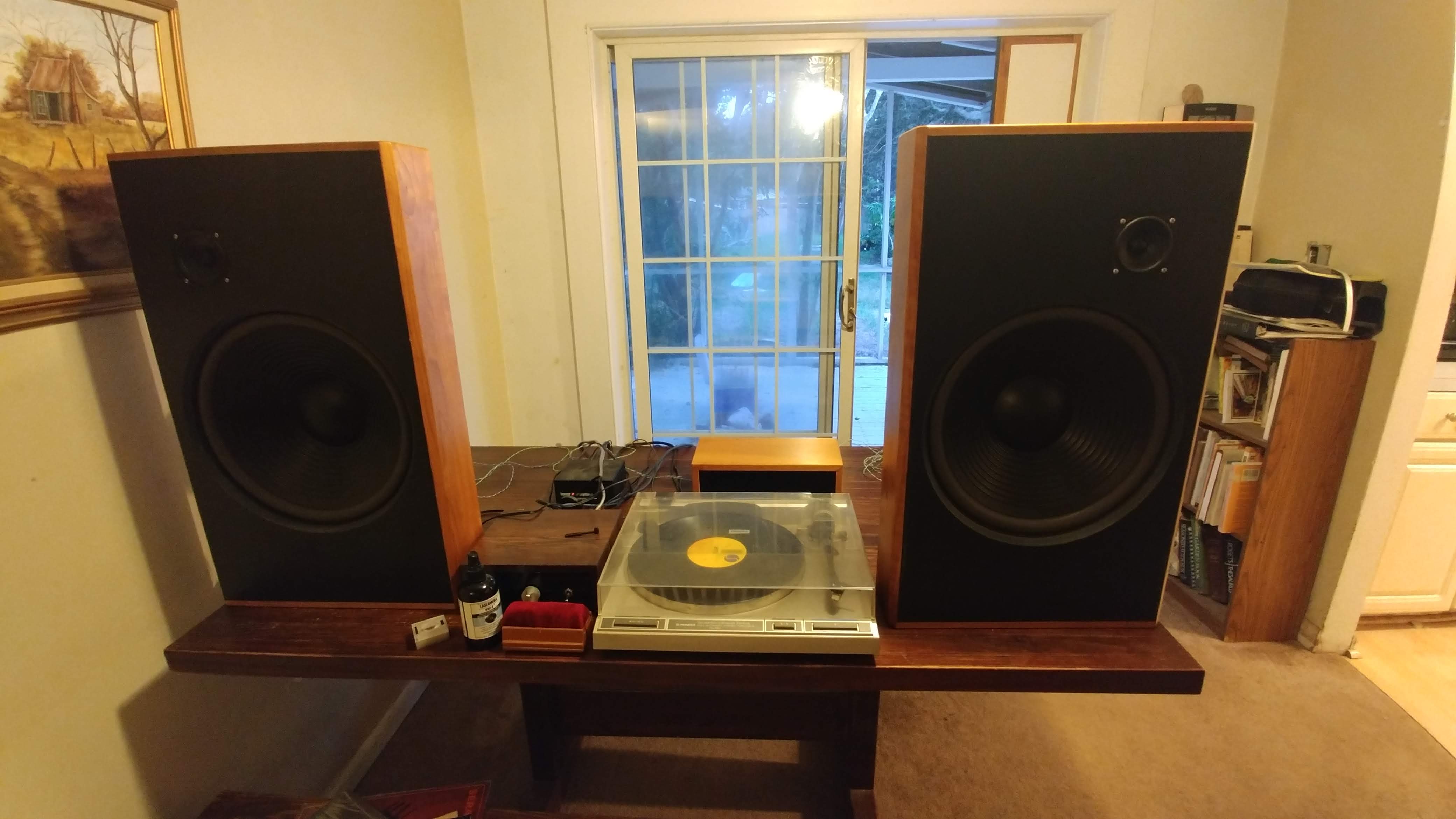

I built the vifa/GRS standard Manzanita a while back and have enjoyed them at lower volumes but get a sorta flutter or buzzing out of the woofer when playing louder with heavy bass. The amp is a Folsom DIY7297 with a B1 in front. I used this crossover as I was kinda confused when ordering parts, although I believe I read somewhere in the thread that this crossover would work. The speakers are about 5 feet from the wall/sliding glass doors. Other deviations from the design are- I used 1/2" phenolic for the baffle and I mounted the woofer on the back of the baffle (with a generous chamfer on the front).
Any suggestions to help me listen louder are appreciated!

1. I hope you have made sure the flutter/buzz is the GRS 15" contributing its song, and not the glass in your sliding doors at the back resonating with the rear energy of the GRSs.
2. If it is indeed the GRSs over-excursing due to playing so much low frequency energy unloaded, a way to remedy it just might be using a 2nd-order high-pass filter a little below its Fs, subject to what the experts have to say.

Well your baffles look solid and the woofers appear to be well attached. Of course seeing them up on the table like that leads to the obvious questions. :) Can we assume that you have the same flutter/buzz when they speakers are on the ground? And what happens if you disconnect the Vifa? Still there? How much power does your amp have?
Those are the first things I would check.
Joined 2017
I played around with placement of the speakers and it seems there was some interaction with the turntable, separating the two seemed to solve the problem. Speakers sounded pretty good on the floor at max. volume!
The DIY7297 has 15w/ch., I believe the PS is 24v but it's been a little while since the build and my head is like a sieve. I realize this is below the recommended wattage for these speakers but to my mid-fi ears they sound pretty good. Have a F5 build planned for this winter, looking forward to hearing them with more power.
