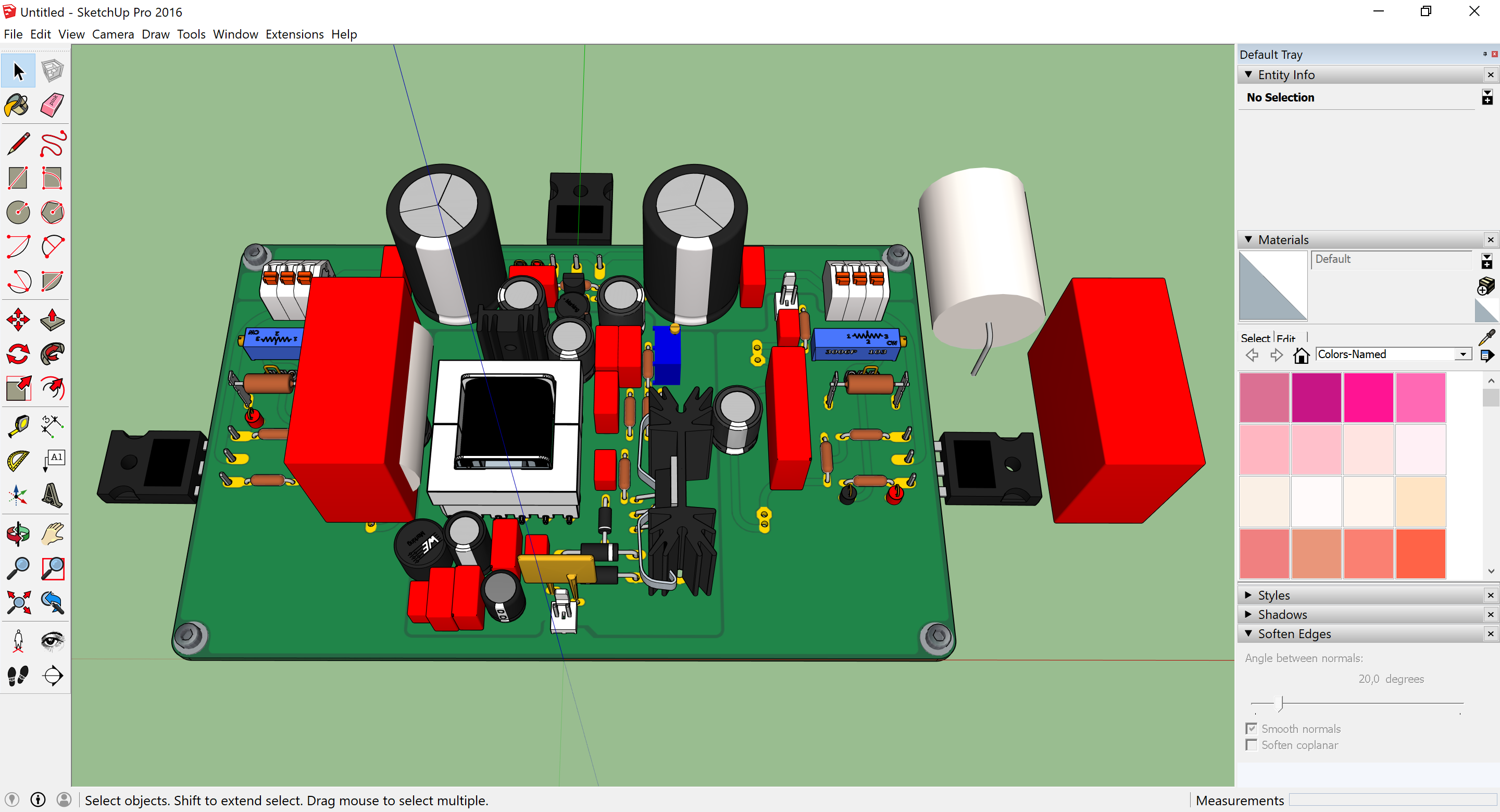

Could someone please check schematics? Or any suggestion then PCB´s not ordered yet.
It includes: 30W flyback, Patrick suggested regulator (#73) and Mr. Rothacher common source amplifier (#47).
I´ll test and report using Toroidy TTG-EL34SE using +12VDC wall cube COTS supply.
JP

Patrick
Thank you for pointing.
Replacing 56k with serie CMF55(0.5W) 39k2@0.36W (3mA) + 64Y trimmer 100k (1mA(84k8@0.09W) to 2mA(45k8@0.19W)).
Mr. Rothacher
Could you please check simply your amplifier in my schematics (using jumper settings for first potentiometer to adjust 70mA and read resistor value then switch to desired resistor value).
I´ll do this modification tomorrow.

I´ve asking last year Pete to do LTSPICE simulation with WE transformer (easy available in Germany) based on his 10W flyback version. He does this and suggested to use the mentionned WE transformer and to switch to LT1170 (5A) to increase the power. Don´t forget, the supply capability is up to 325V@30W.

Yes.
You should at least put a JFET follower upfront to drive it properly.
Unless of course your source is also low impedance.
