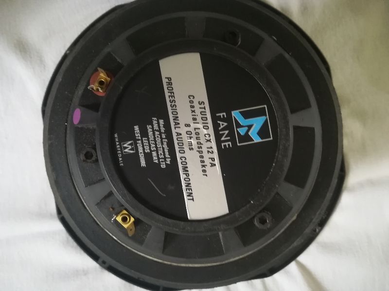

Fane Studio "CX 12 PA" (CX12 PA - CX12) Looking for Replacement or Voice Coil Repair
So that I do not have to write everything twice, here is the email to FANE international that I have sent under this URL:
Contact Fane International

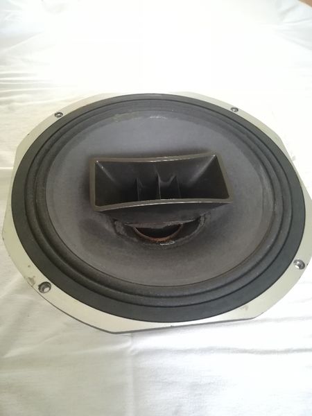

I am looking for a replacement or special company for voice coil repair of a '12 coax transducer from your company. I think, this driver is 40 years old and is basically the Studio 12L with integrated cell horn and horn driver. The model number is "CX 12 PA" (CX12 PA - CX12), On your website there is no datasheet and replacement advice available.
On my device there is follow unwanted effect: Temporary and not permanent there is no sound in the bass-mid range audible. The reason isn't on the outdoor connectors but the internal voice coil winding has a temporary break.
Please let me know, if an replacement part is available or where I can send this driver for a repair cost estimate.
Thank you very much for your efforts.
Best regards
Andreas Kirschner
Maybe one of the members have an additional advice.

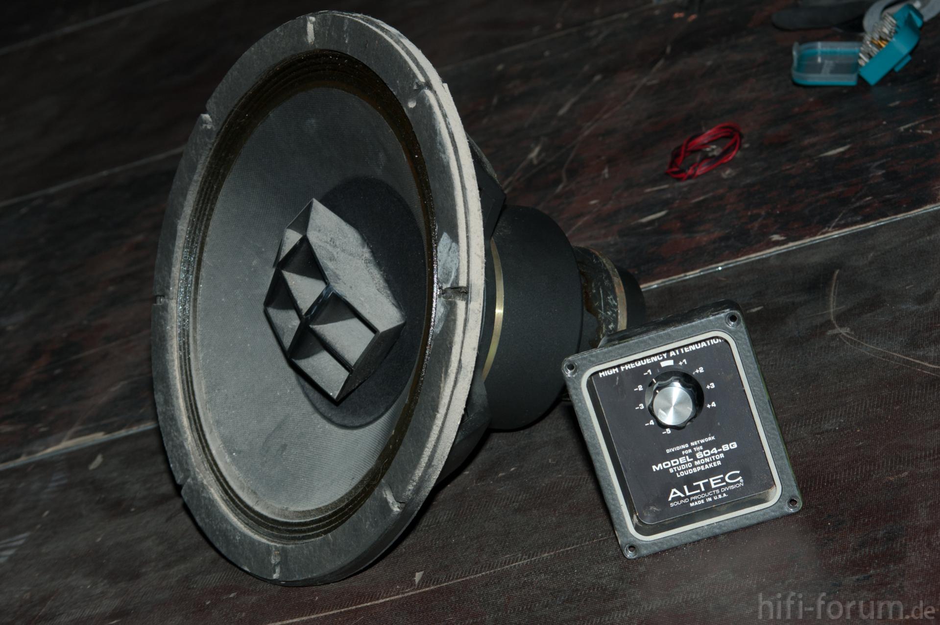

Altec 604 Duplex Speakers and related
Altec Lansing 604-8G Duplex - Manual - Loudspeaker System - HiFi Engine

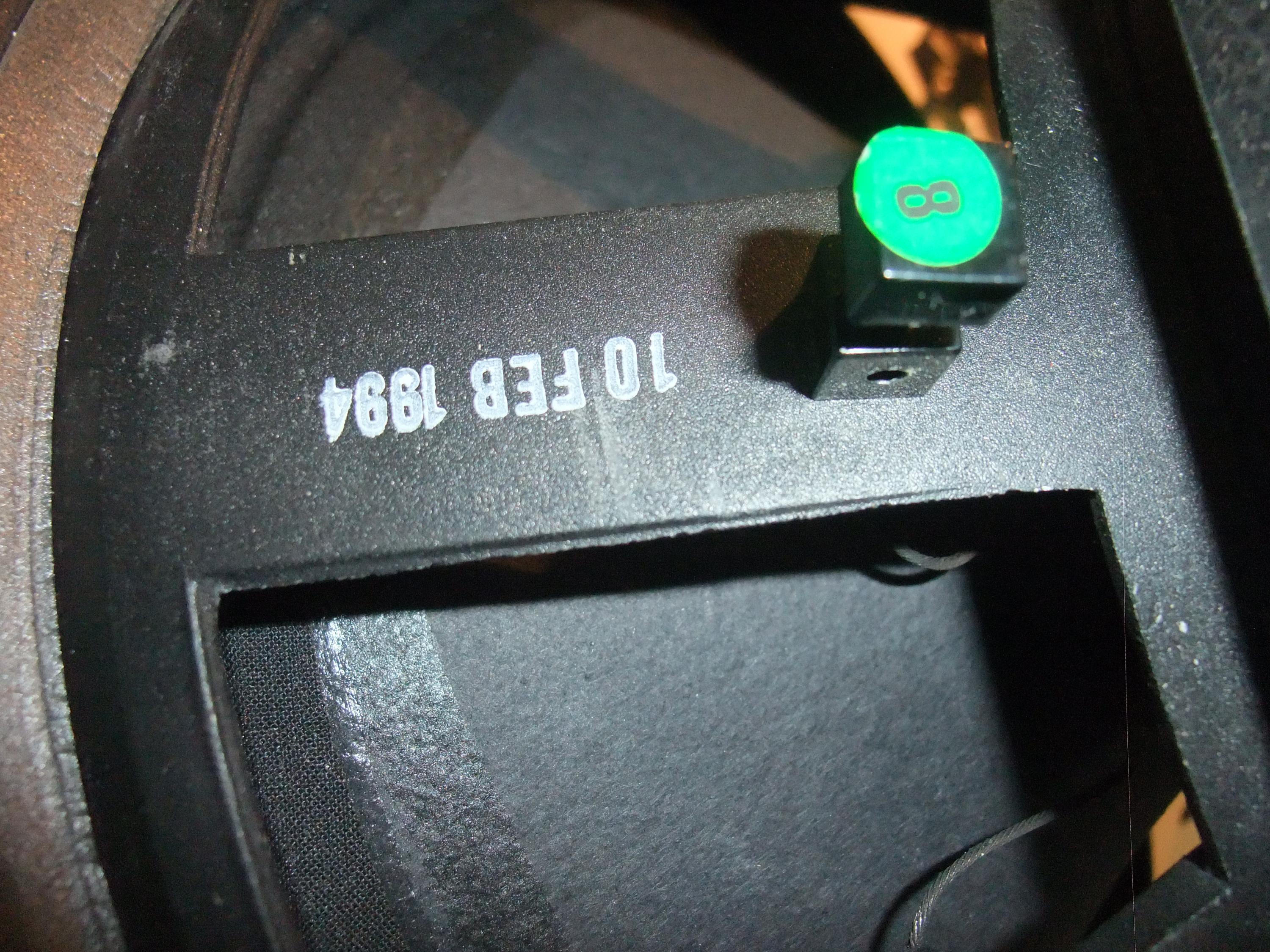

Dear Andreas,
Thank you for details of your enquiry.
As you indicate this product was manufactured by FANE around 40 years ago.
Consequently the product is obsolete and no longer supported by spare parts and cannot be repaired by FANE. We do not have a comparable product from our current product line to suggest as a replacement.

The question is now, which company is in general able for resurrect voice coil in coax drivers with integrated tweeter horn.

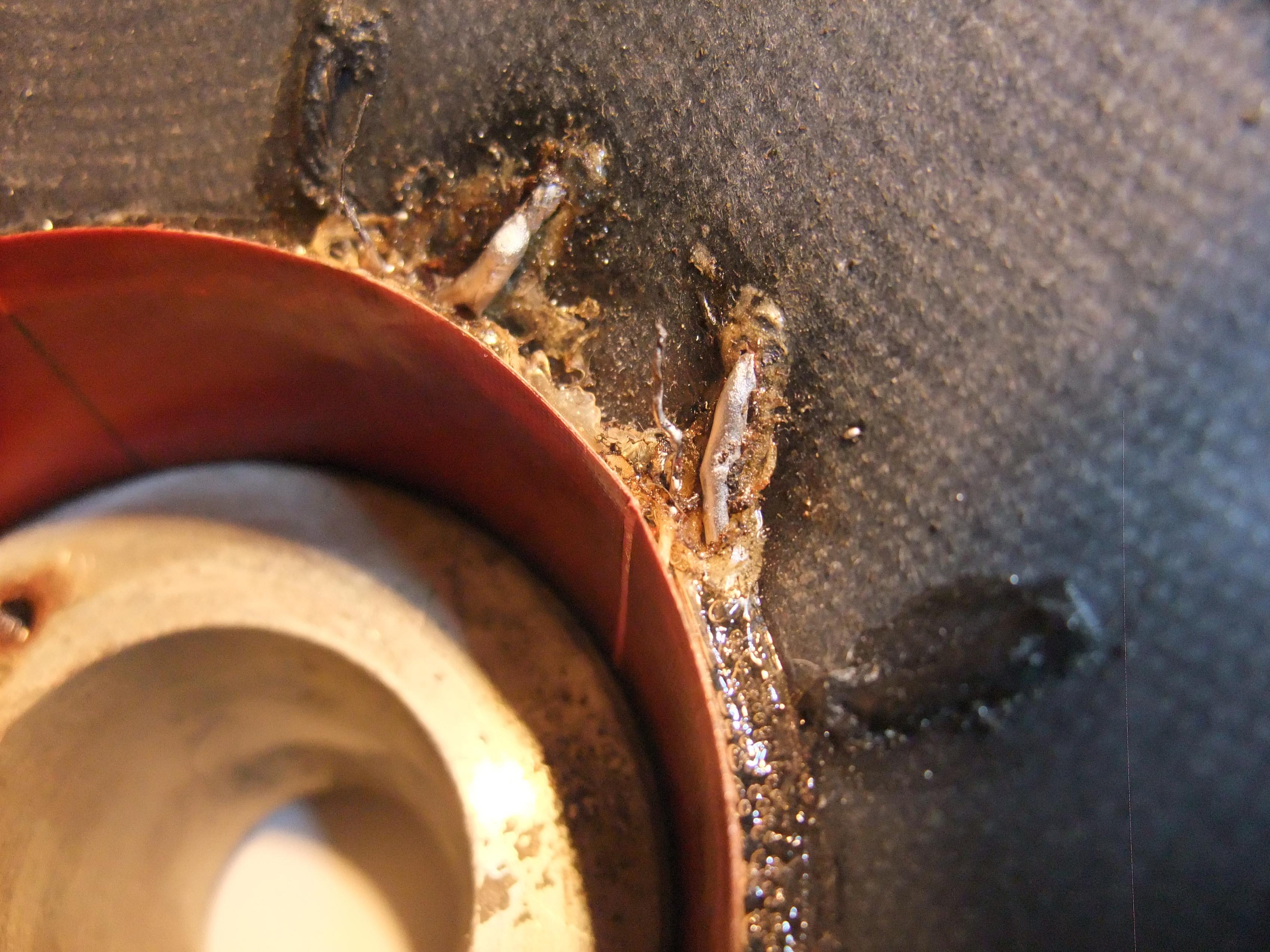

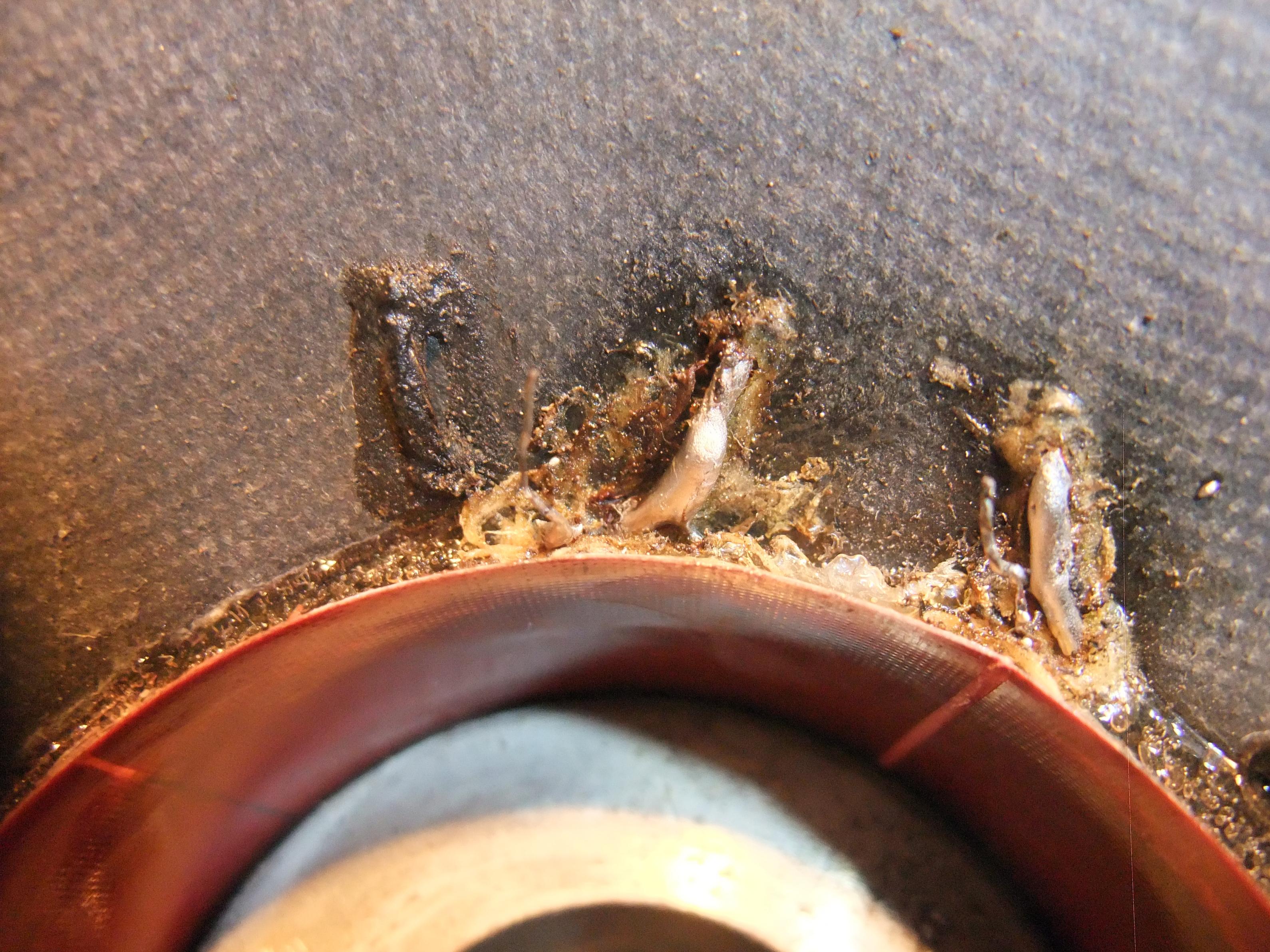

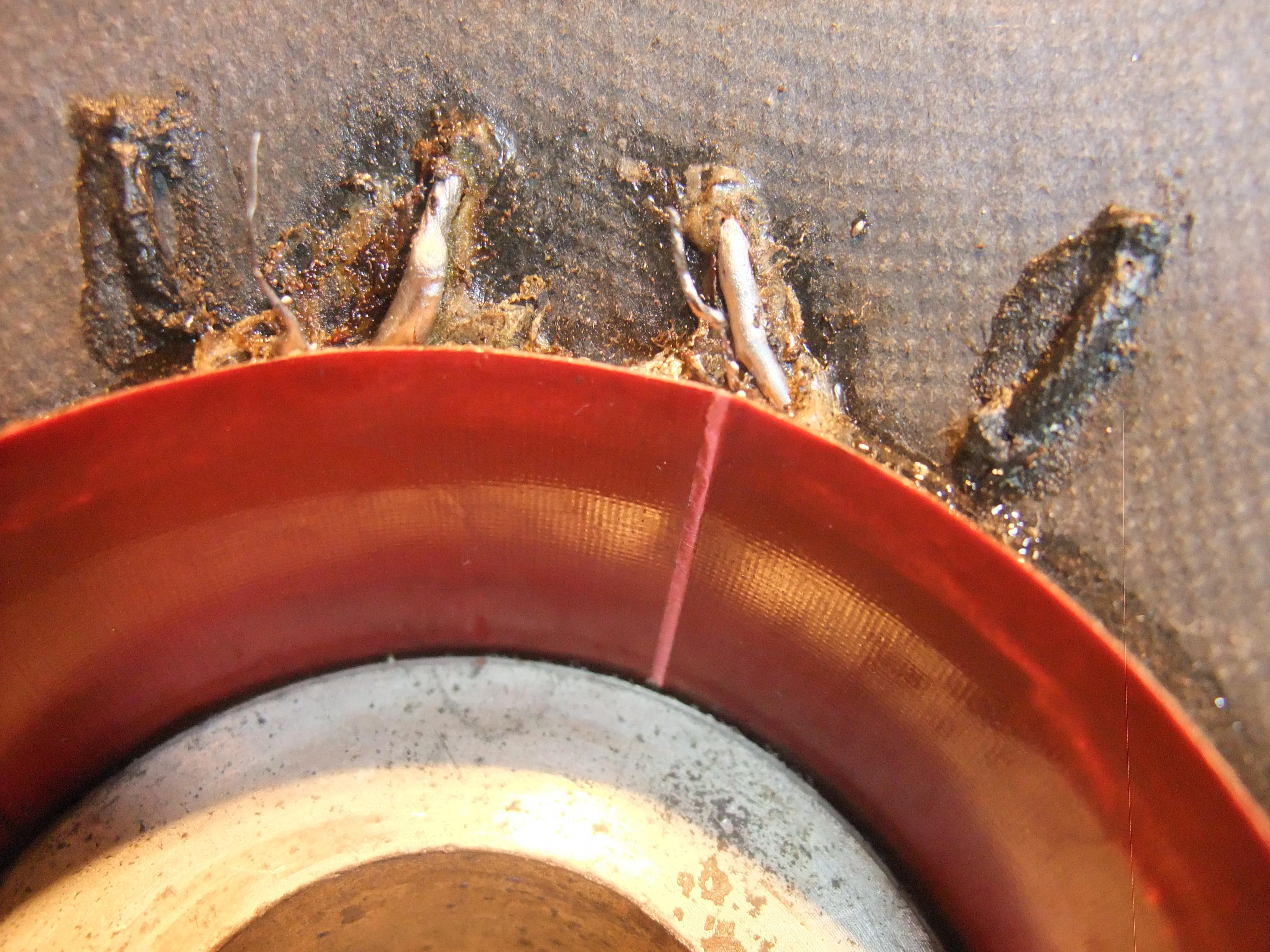

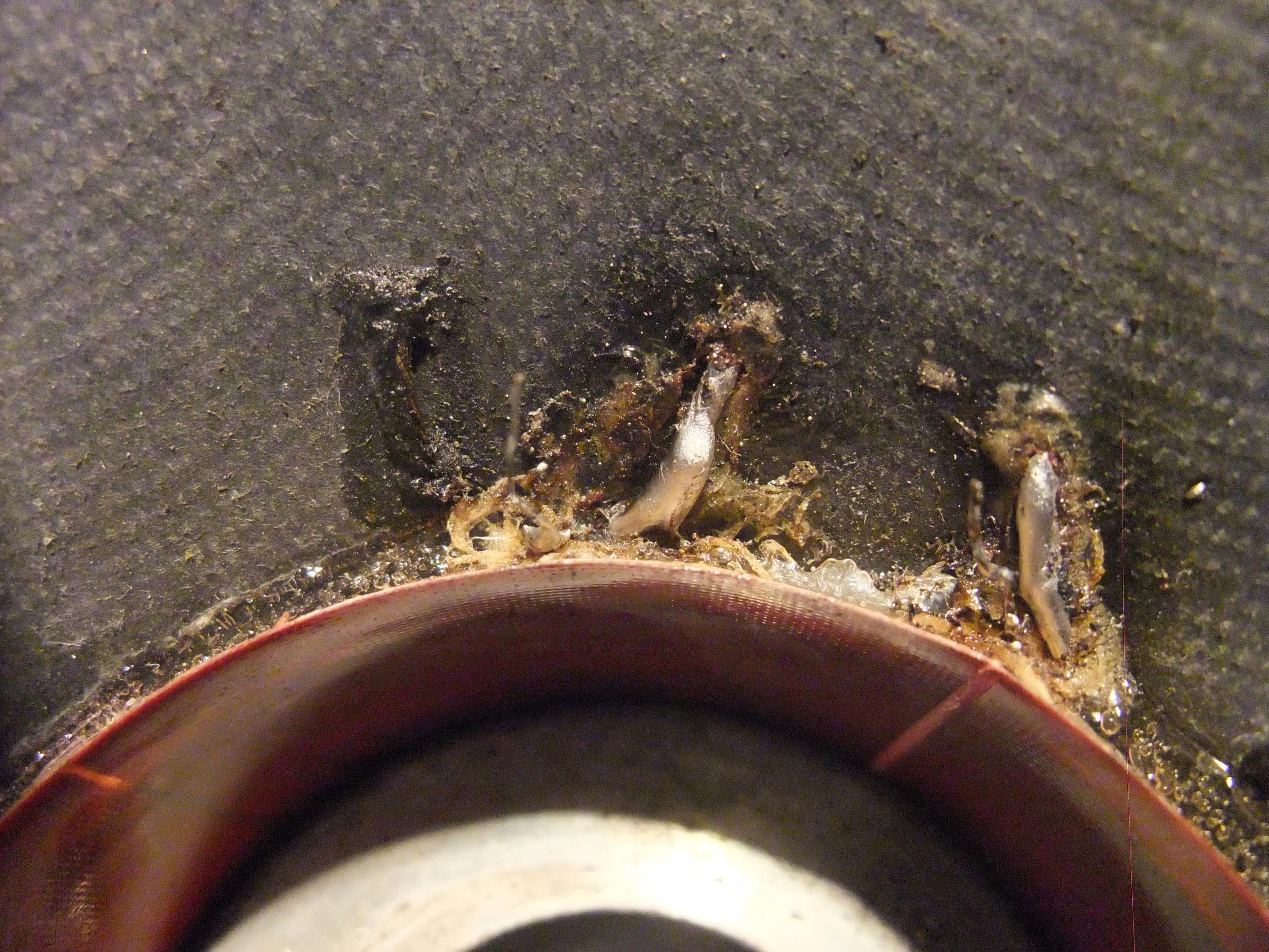

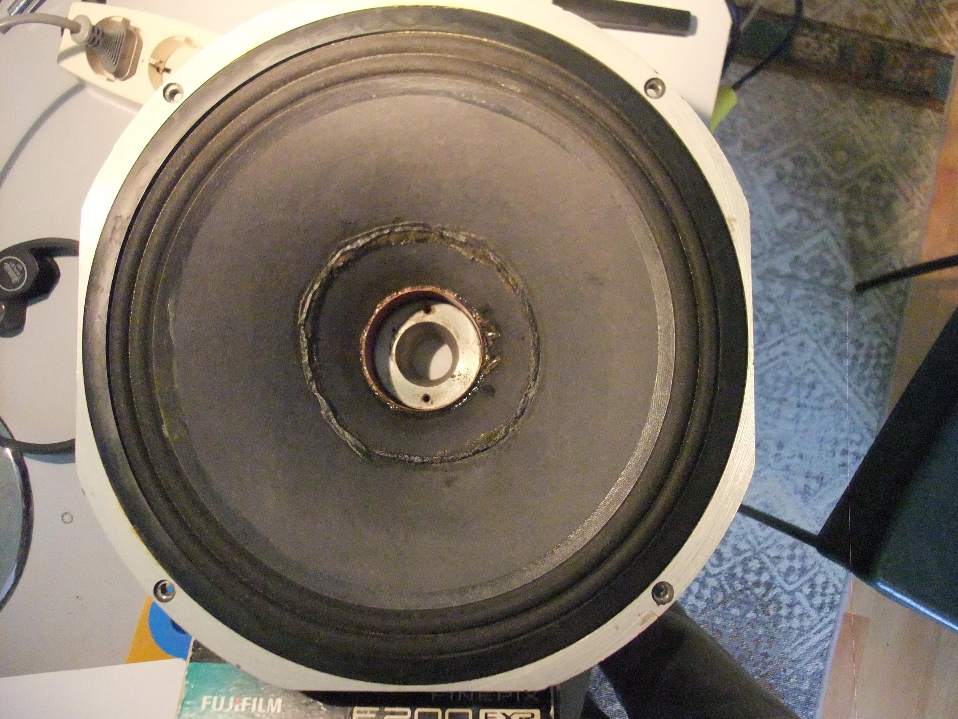

Carried out own first Steps for Troubleshooting

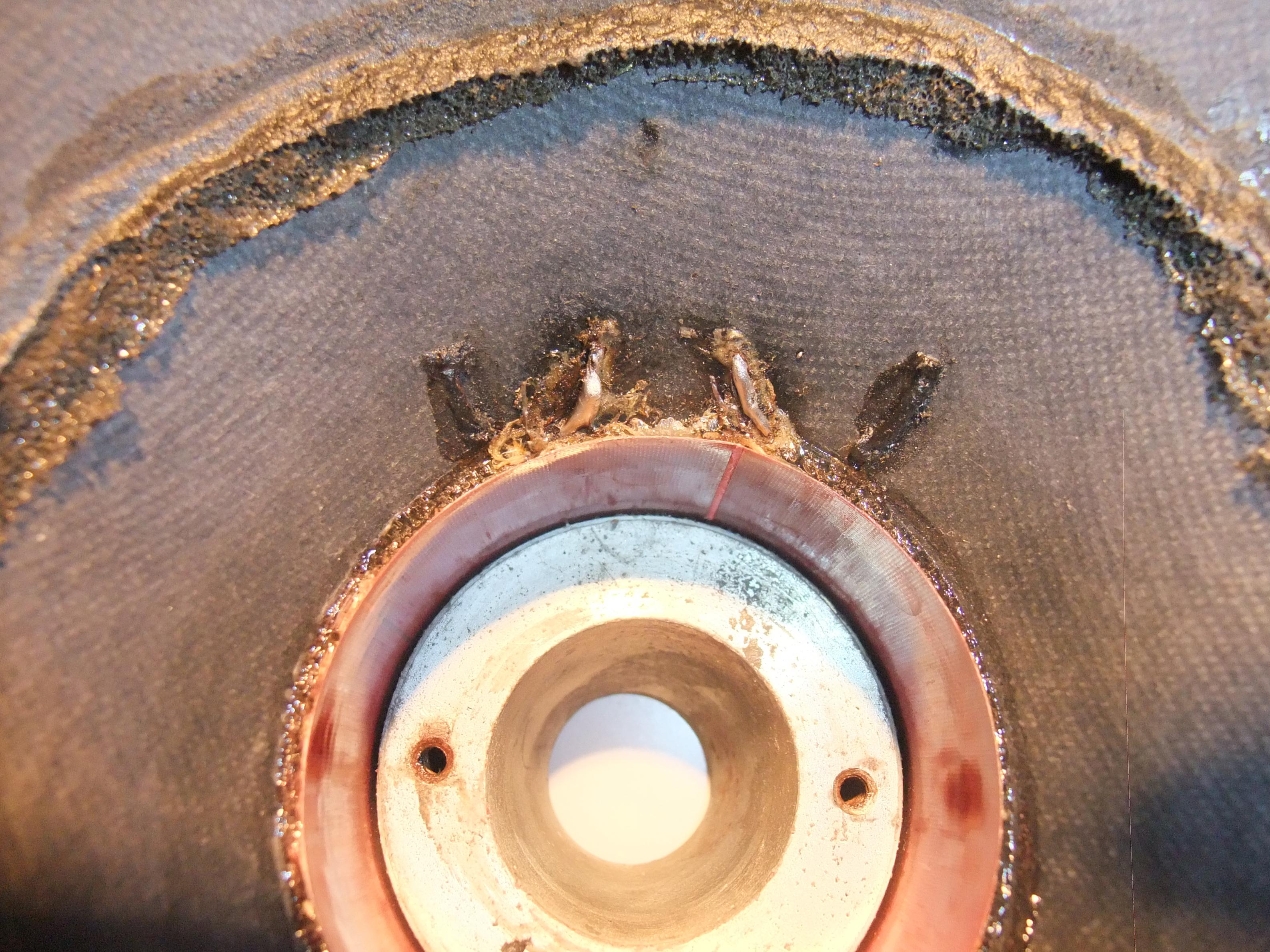

To find out where the break was coming from, I separated the voice coil wires from the flexible lead wires coming from the terminals - go to the attached images.
Therefore I had removed the horn and the HF driver
Unfortunately the break was inside of the voice coil winding. Thus the voice coil is to replace, because completely recone kits no longer available.

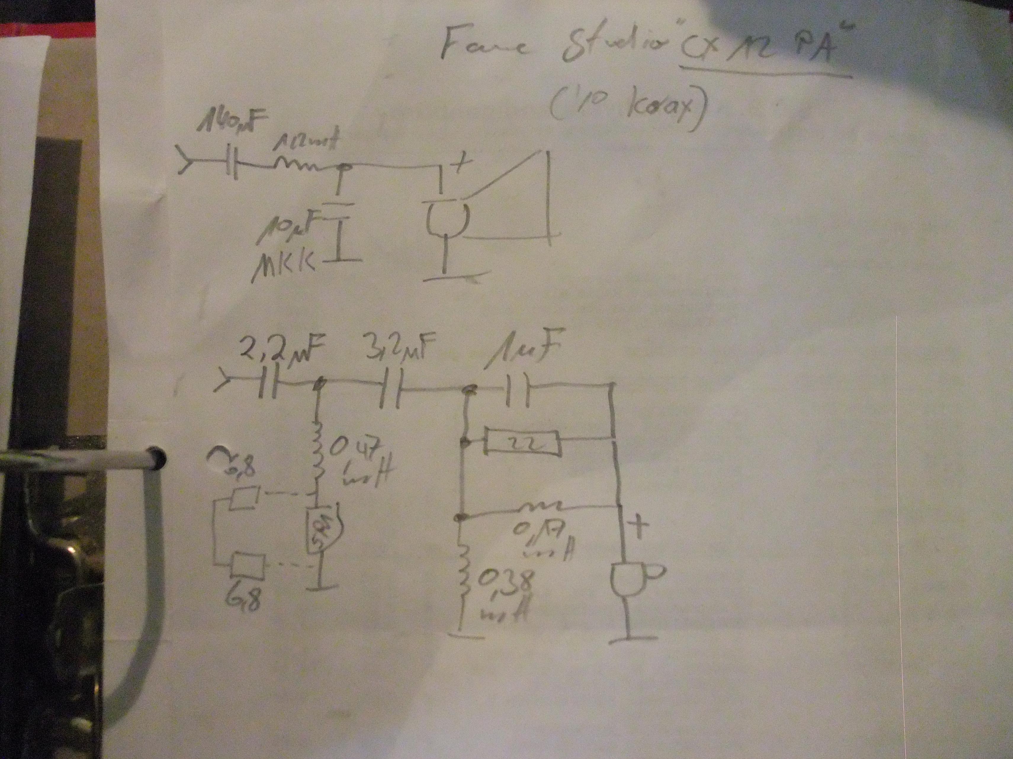

P.S.: My schematic of crossover network (own development for flat frequency response) you will find in the last image.

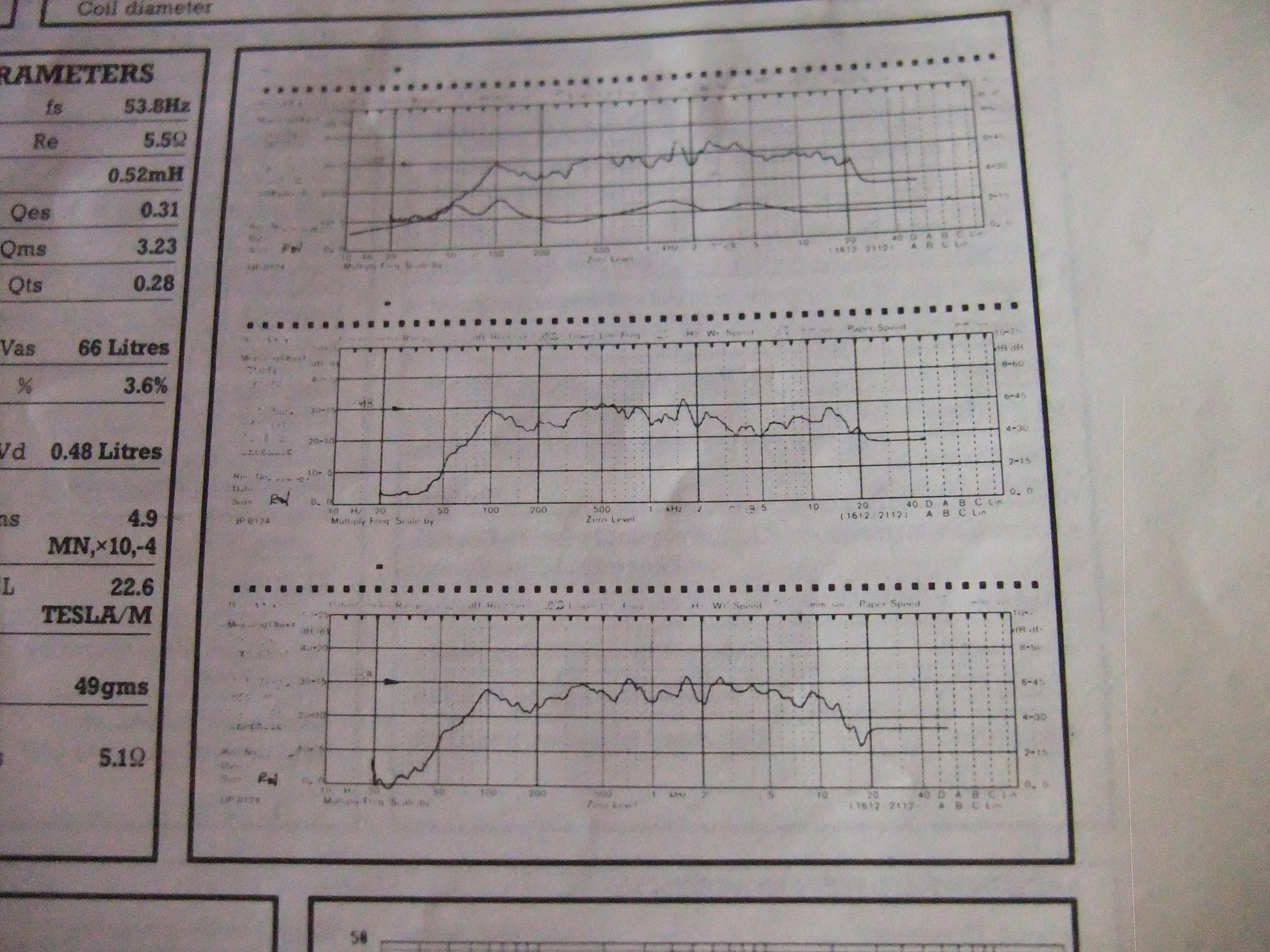

Using of a Recone Kit from currently available Drivers for FANE's Vintage CoaxCX12PA?
Yesterday evening I came up with the idea of ordering a recone kit, of which the corresponding chassis are still in production.
The prerequisite is, of course, that the relevant parameter deviation does not cause any significant changes in the sound character (deviations in the upper frequency range are irrelevant, since the crossover is outside and can be modify accordingly).
The parameters of the following models are relatively close to Fane's STUDIO CX12PA, which are as follow (FS, Qts, VAS, Mms, SPL):
fs: 54Hz, 0,28, 66L, 49gr, 99db Cms: 490 µm/N (4,9 MN x 10-4)
1) Precision Devices PD1225C001
fs: 39Hz, 0,18, 156L, 48gr, 100db Cms: 363,2µm/N
PD.1225C001
2) Precision Devices PD121
fs: 53Hz, 0,23, 66L 65gr, 99db Cms: 168.33 µm/N
PD.121
Precision Devices PD.121 – Musikhaus Thomann
Precision Devices RC.PD.121 Recone-Kit – Musikhaus Thomann
3) FANE-SOVEREIGN 12-300
fs: 46Hz, 0,38, 110L, 43gr 97,5db
https://www.fane-international.com/downloads/FANE-SOVEREIGN-12300-DS141117.pdf
https://www.thomann.de/de/fane_sovereign_12300.htm
4) FANE-COLOSSUS-12MB
fs: 45Hz, 0,29, 56L, 59gr, 98db
https://www.fane-international.com/downloads/FANE-COLOSSUS-12MB-DS141117.pdf
https://www.thomann.de/de/fane_colossus_12mb.htm
The ones from FANE's Studio 12B differ much more:
fs: 47Hz, 0,28 144L, 29gr, 100db
It is fundamental, however, that the following dimensions are absolutely identical:
1) Voice coil diameter (6,35mm according data sheet of CX12PA)
2) voice coil length
3) Position of the winding on the voice coil carrier
4) Outside diameter of yellow centering spider
5) Diaphragm suspension outer diameter
Unfortunately, these dimensions are not published in the datasheets (except Voice coil diameter) and for recone kits.
Experienced repair shops should know that.

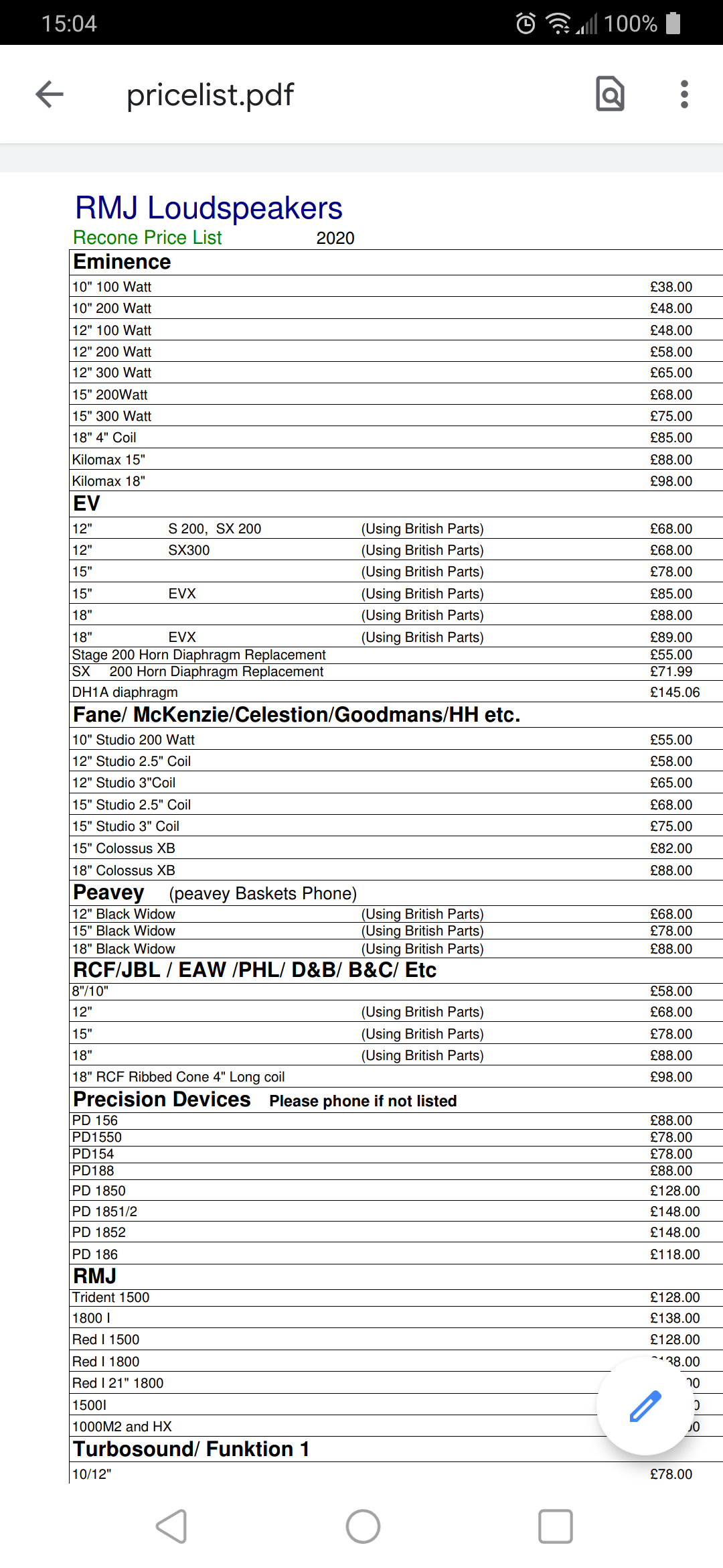

http://www.recones.com/pricelist.pdf
I will contact this company next time.

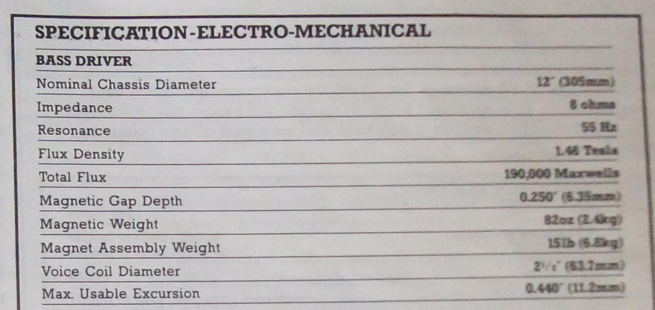

No, unfortunately not. Contact Mr. Barnes again and I asked him if he knew any special companies for refurbishing vintage FANE coax drivers. The horn is attached with two screws - but I can't explain the details of the tear down procedure now.Did you ever find a solution to this? I’ve got one to repair as well.

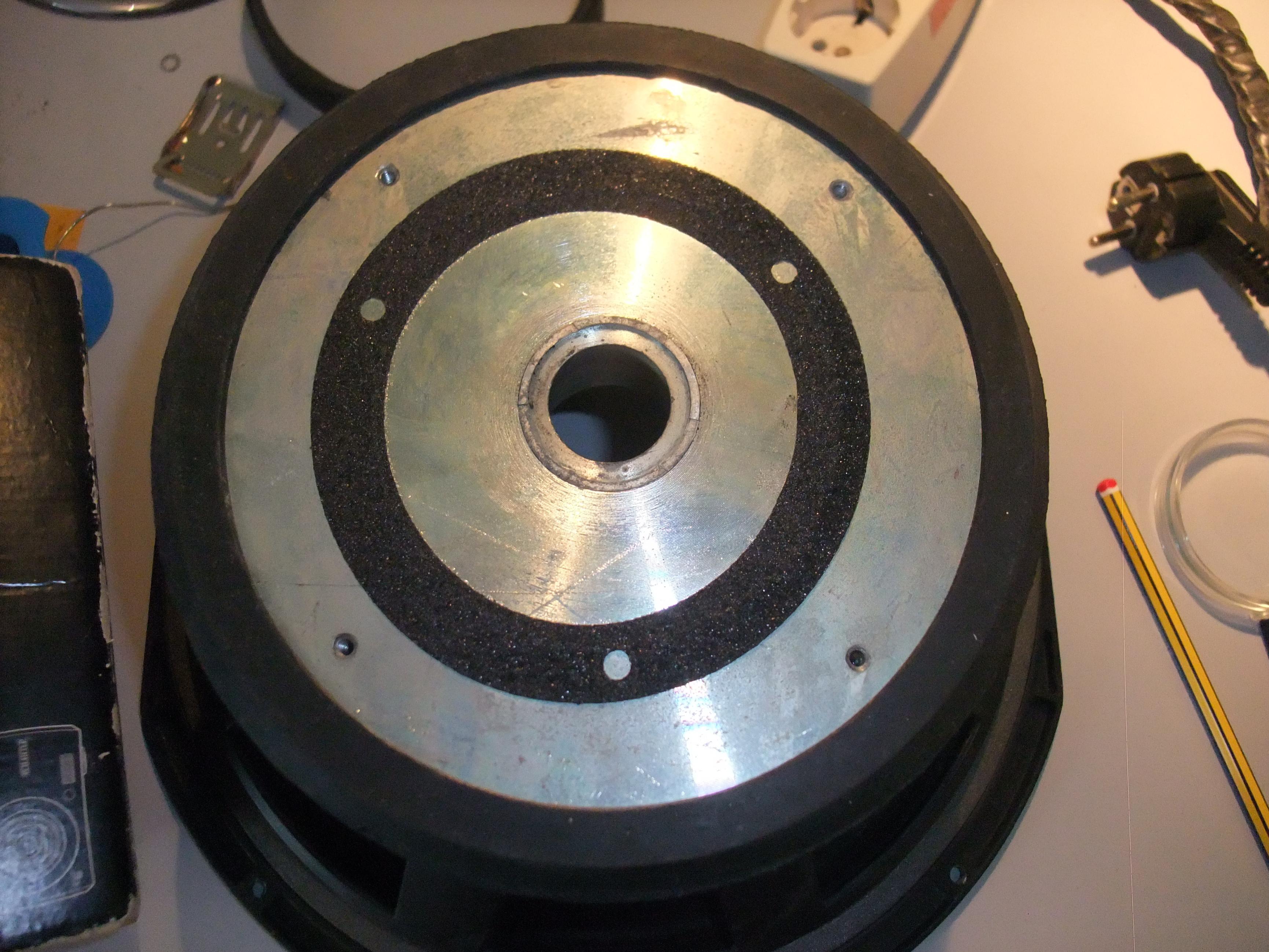

Th woofer section IS a Fane Studio 12L, they say so themselves in the brochure.
And recone kits are available for them:
https://reconingspeakers.com/products-page/fane-studio-12l-12-aftermarket-recone-kit/
So order this recone kit, use it, there may be a couple minor details different considering it´s a coaxial, no big deal.
If unsure, hire a reconer for the expertise and provide him with the proper parts.

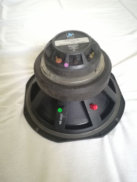

The 12L has an accordion surround not a dual roll as the Cx12pa had. It looks like the vc will work and the depth is the same. The surround might be too different to work right. I might try to get the surround off the original cone in situ a reglue it to the new cone if I can’t find one with the right surround.
Which brochure are you referring to? The surround is different for sure.Th woofer section IS a Fane Studio 12L, they say so themselves in the brochure.
You can´t see the forest for the treesWhich brochure are you referring to? The surround is different for sure.
Type of surround chosen will have a MINOR influence around resonant frequency (if that much) and nowhere else.
Way more important is the speaker "voice", which mainly comes from cone chosen, voice coil used and adhesives, in that order, and will influence parameters such as frequency response, resonances across the audio range (those which are conveniently obscured by frequency response averaging), acceleration under an applied impulse, etc. .
But feel free to get the recone kit I suggested or any other you can find and use the surround you want.
As of the brochure, you didn´t provide any, but tiefbassuebertr was kind enough to post one.
This is not a "Hi FI" or "Home" use speaker by any means but a dyed in the wool PA type.
