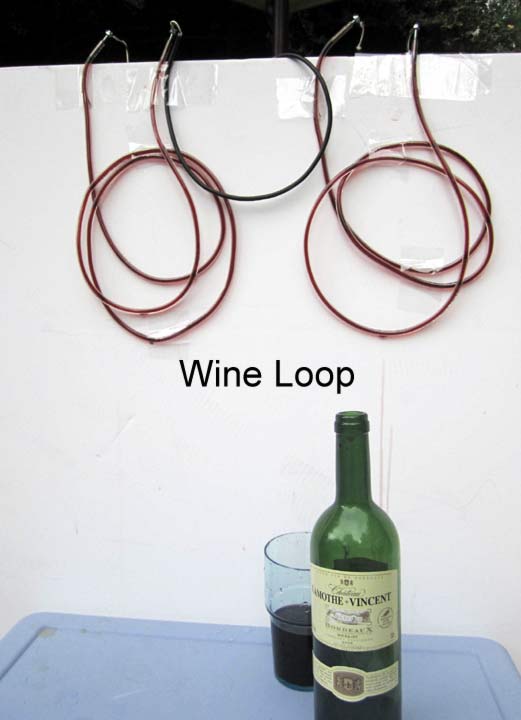

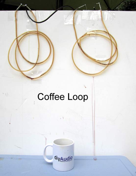

I did some testing this afternoon thru 6 feet of tap water, salt water, diet Coke, wine and coffee. The beer - I drank. :)
Conclusions:
  • Tap water: Very bad, almost no signal
  • Very salty water: OK. About 6dB attenuation and some noise.
  • Diet Coke: Had to boil it to release the carbonation, otherwise it was just fizz. Terrible conductor, heavy attenuation.
  • Wine: A little better than Coke, but not much.
  • Coffee (black): Similar to wine.
Don't try to make liquid cables, unless it's mercury. The things I tried make awful conductors. Maybe over a few inches, like the banana, they would be OK - but not over 6 feet.

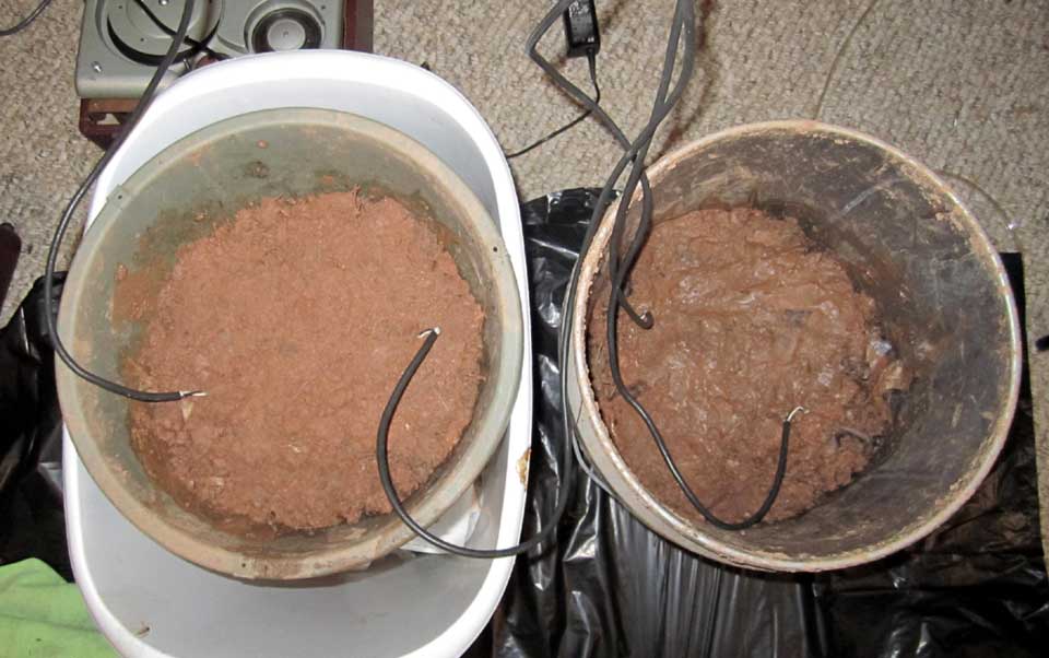

By only playing FLAC, the mp3 bits are discarded; and now the easily discernable last place is D, the mud version - this has nothing to do with the glitch, the cymbals are clearly rendered more poorly. But the others are harder, and this is due to junk connections and components of the PC speakers; reseating the plug, and refreshing the volume pot setting makes as much difference as switching between versions. To get an authorative assessment would require taking the quality of the playback mechanism largely out of the equation, by transferring all tracks to a significantly higher quality system ..

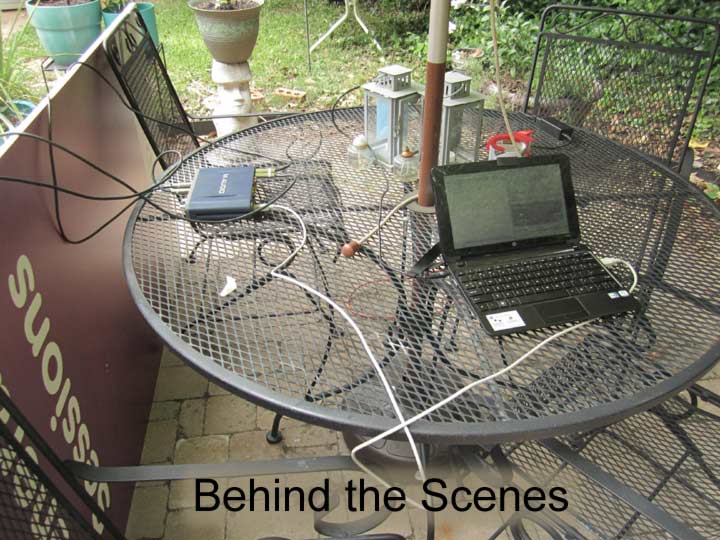

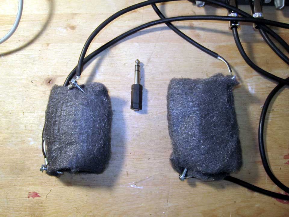

The goofy set up
Here are photos of my goofy test rig - just so that you can see what I'm doing. It's not pretty, but science rarely is.
The test leads are some unknown mic cable with 2 conductors and shield. The two conductors are tied together into 1, the shield is connected only at the sound card.
Sound card is the M-Audio Fast-Track Pro USB running at 44.1KHz, 16 bit. Player software was Foobar 2000, recording done with Audacity. Editing done with Goldwave. Computer is an HP netbook with Atom processor, Windows 7.
