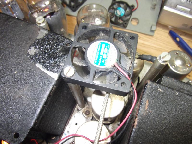

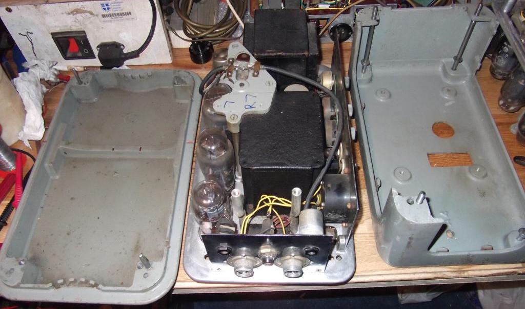

I fitted fans to my vintage mono block amplifiers and these relied on a little bit of suction from the cinema projector that was once up on a time mounted on the top of the cast cabinets through a small cut out that also carried wiring for the lamp and motor. The only place the fan could go was below this cutout.
I removed the bracket with the notes marked on it and replaced the input cable to make the space for the fan to fit onto the mounting point that the bracket was screwed to.
There was little choice about sucking or blowing the air. It was all down to the internal layout of the equipment for me.
