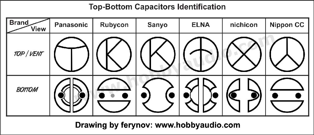

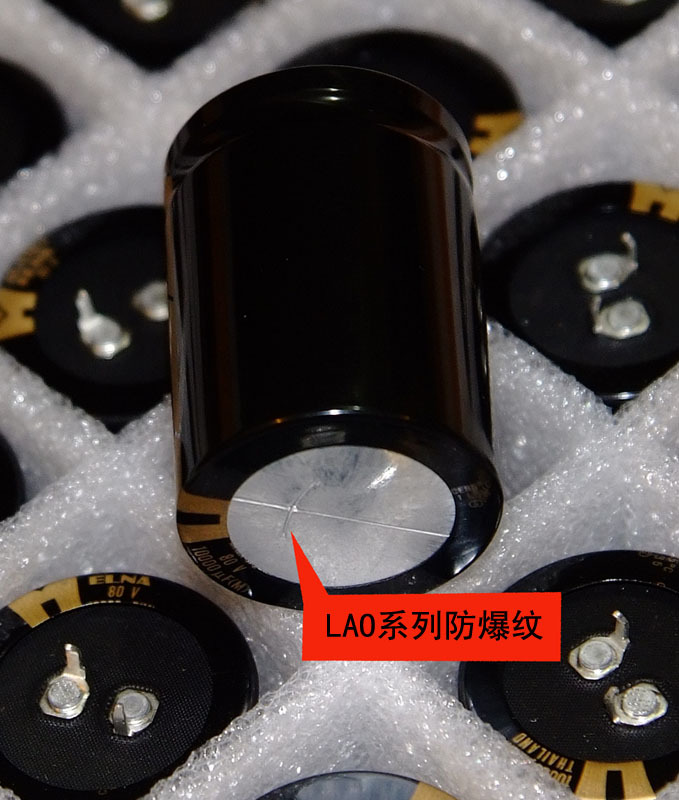

Most of them are in a can with a "cross", stamped as an over pressure rupture stamping in top of the can.
On the bigger ones they usally hide the "cross" with an insulating pad.
This cross stamping in the can is an identity mark for Nichicon caps (but with an other rubber pattern, see below), but also used for a lot of low quality "Cheap Chinese No-Name Brands" with differing rubber pattern.
Sanyo f.ex also uses a cross, but with a stretched middle section.
For other ways to identify counterfeit caps, regarding can stamps and bottom rubber pattern, see the attachment below:

These you bought 3300uF/25V seems to be of ELNA manufacture OEM for Clarion. Bottom rubber pattern is ELNA-type, but pics in the ad don't show the top with the over-pressure vent, that should be like a "sword" for real ELNA. See the pattern map I showed earlier in this thread.
The other 2 10000/80V you show from Ali are absolutely 100% fakes. You must know the seller Moses is not the same as MOUSER Electronics

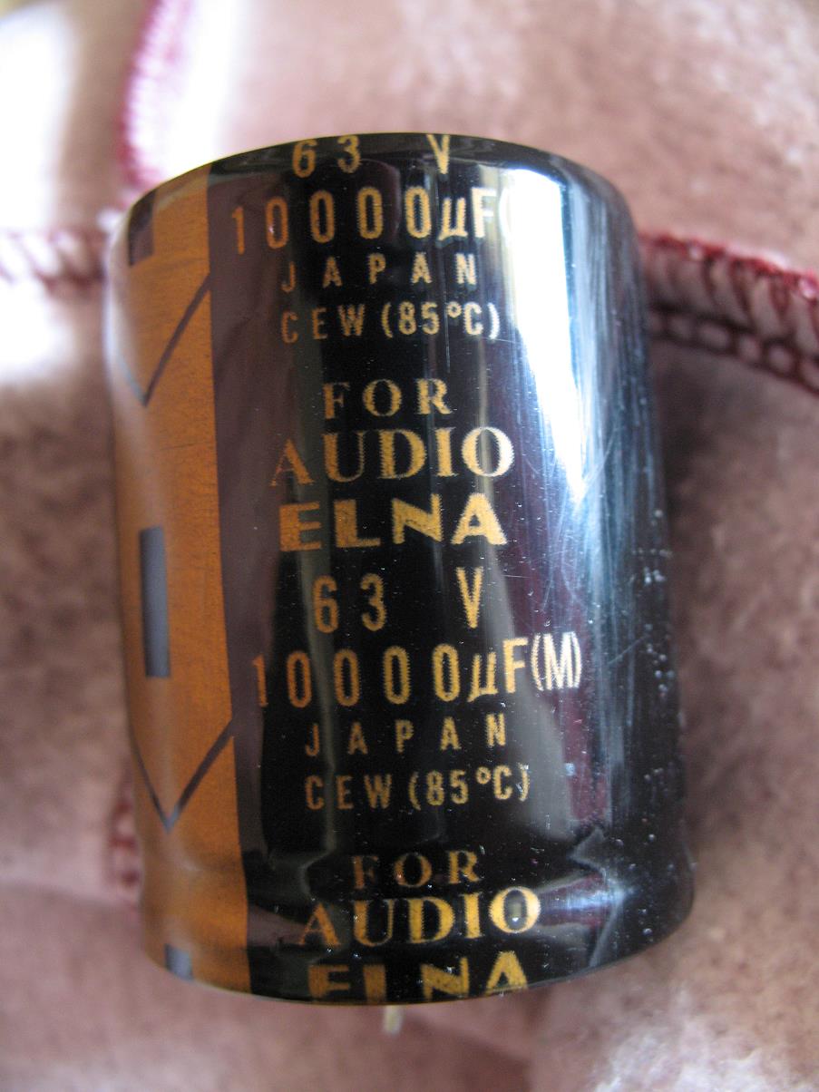

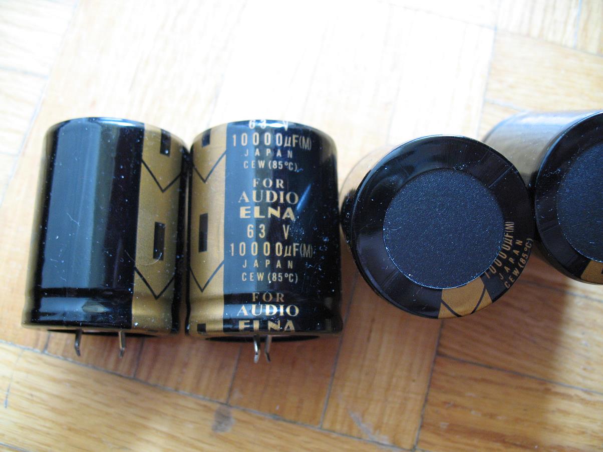

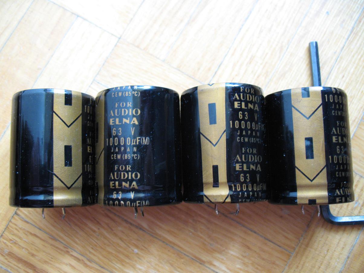

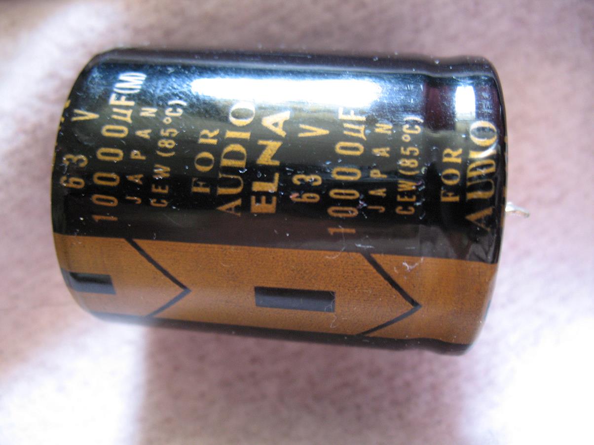

The original 10 000uF 63V look like these

Please do not buy from these seller because he will send you Fake not the same as the picture on the ad
The truth is many times at the ad the use pictures from the original and send you different (I mean fake)
Please take a good look at the capacitor sleeve the negative side marked as the 80V.
I would not put my hand into the fire. When is too cheap very likely you get fake items

He had only one request not to mention he sell fake Elna-s and not to leave negative feedback.
Positive feedback mean not much if people can not see or know the difference between orig and fake.
My parts was not even match to the pictures. If you cut the top sleeve (picture does not have top sleeve) the caps are marked as Nichicon, why you say is not fake... Please do not mislead people to waste their own money.
On the pictures those are real Elna but he sell and ship FAKE parts.
Please order a few from these guy and after share your opinion.
No hard feelings just make me upset when I got the experience by ordering and ..................
Greetings
Both Panasonic and Rubycon warned in annual reports that chinese fakes had appeared the eye couldn't distinguish from real anymore, years ago now... luckily we talk about bad fakes most of times here. If fake explodes we find visual confirmation for fakeness after that, perfect looking fakes exist too... Panasonic now also has chinese factories, for real that doesn't help... it won't go away for next 20 years, then we get african fakes...
If you still have doubt about please see post 17, those caps wans sent by these seller.
I still have the pictures so i will post them here to
