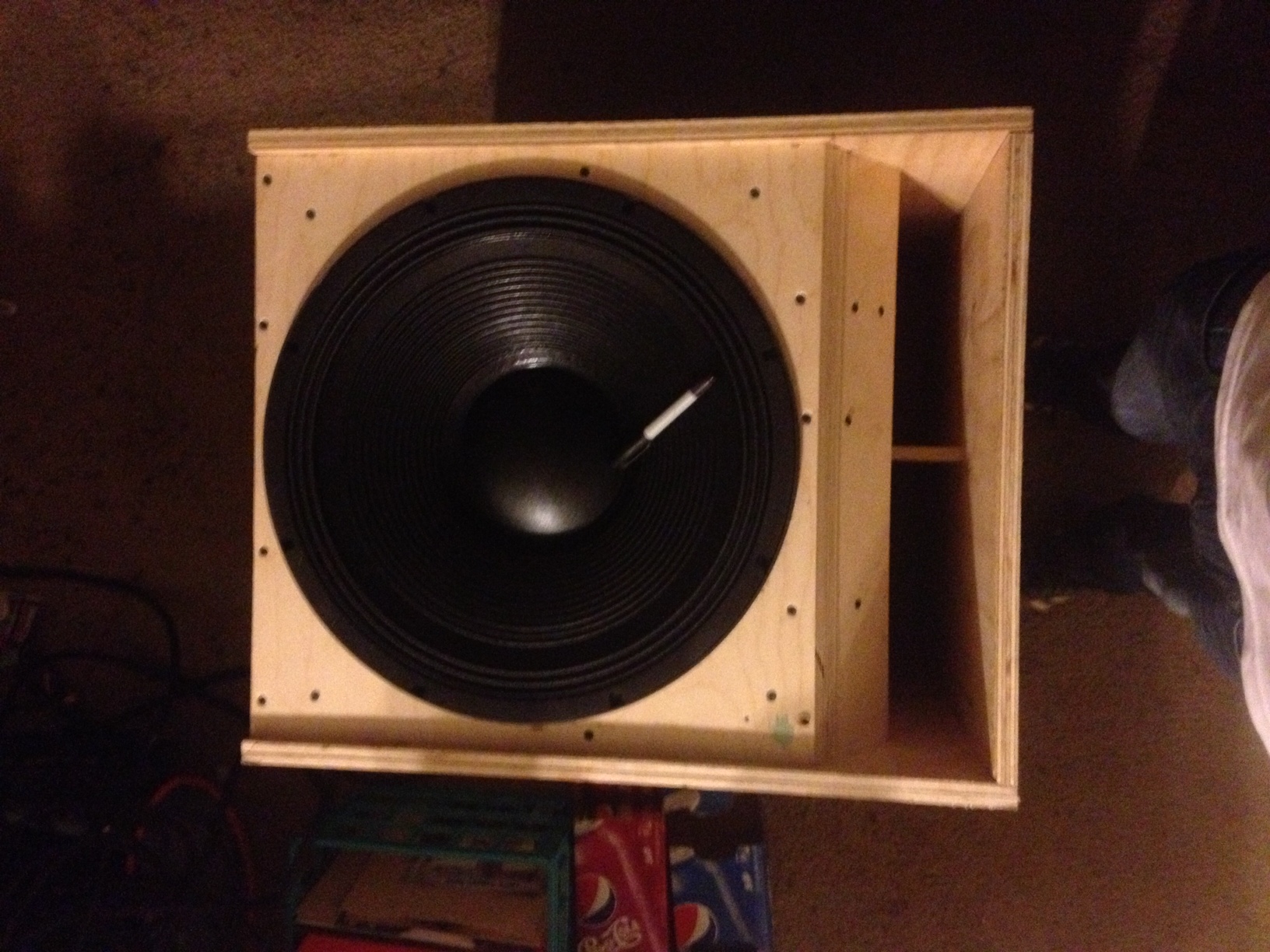

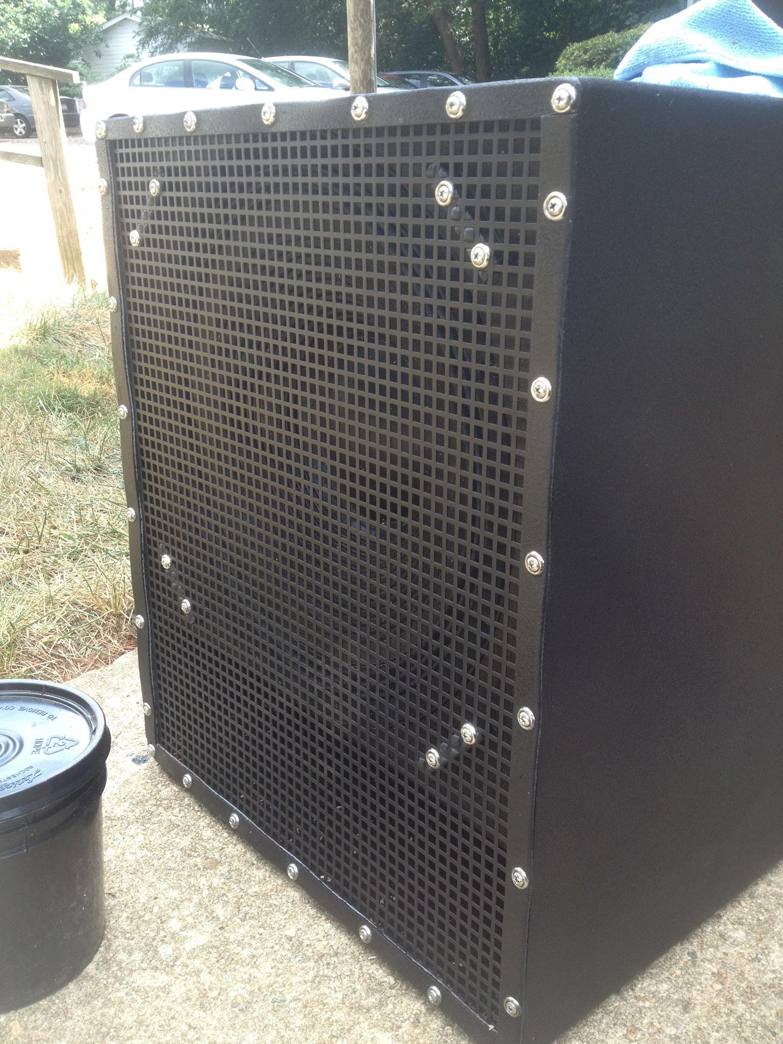

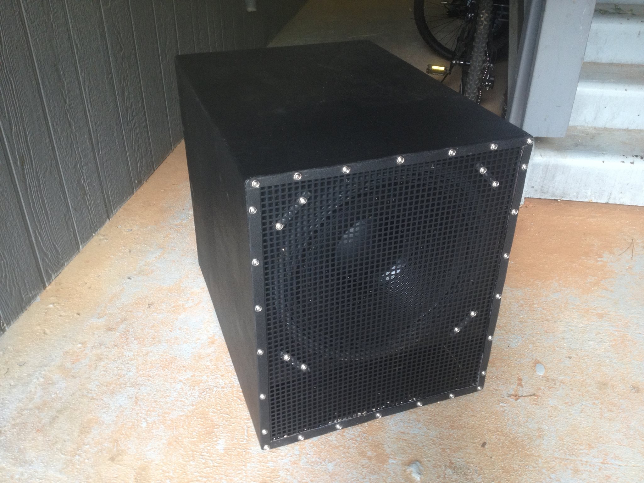

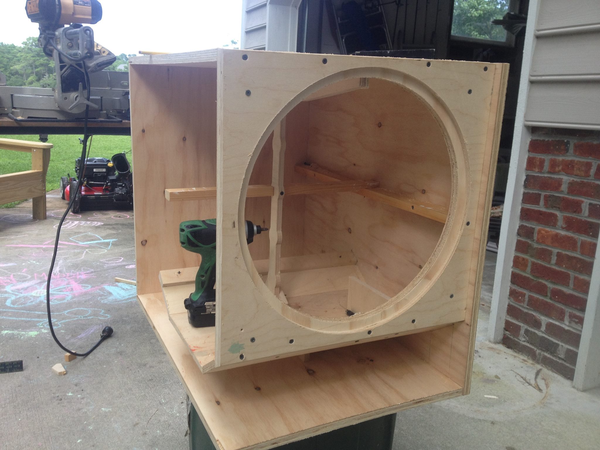

Hey guys, just posting a picture of my "budget" 18" BR I built for a buddy. putting the finishing touches on it... really stretching my overly slim budget to the limits (no corner hardware etc). 3/4 aracuo and 1/2 birch for the port.
Its tuned to 37hz with flared ports (Port speed stays below 15 m/s at xmax). excited to hear it!

Looks good, have you actually measured the tuning to be at 37 Hz?Its tuned to 37hz with flared ports (Port speed stays below 15 m/s at xmax). excited to hear it!
I'm curious how the flared on both sides short port works for tuning frequency. The Danley 12" box has something very similar, with less of a "straight" port in between. Looks like you did a huge favor for a buddy, doesn't seem like you got much $ for building it by the way you describe it

I modelled the port in hornresp. If I had kept the port a constant width, then I would have had to make it far longer. "bottlenecking" it, allows the length to come down a tad, but still offers you a significant port velocity reduction at the mouth and throat of the port. I wanted to stay a good distance away from the back wall as to not affect tuning.

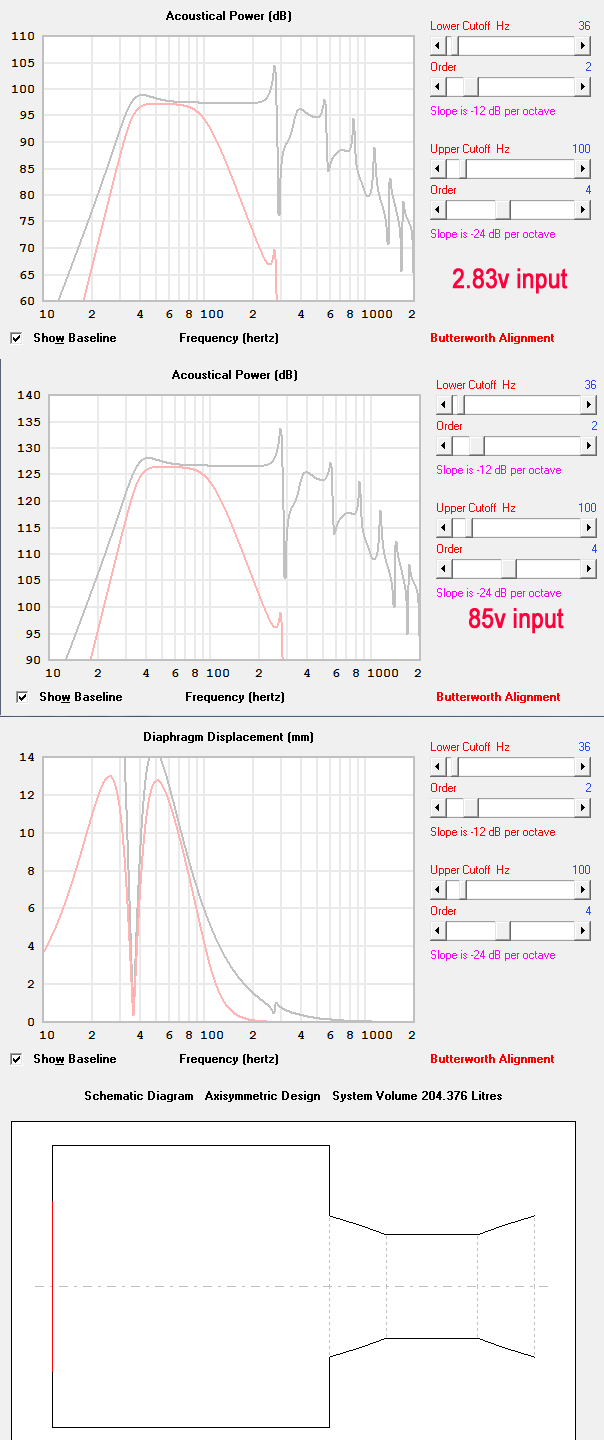

Heres the sim results. just around xmax is shown at 85v input. I'll likely peak limit around 90... they are using some old qsc bridged into 8 ohms.

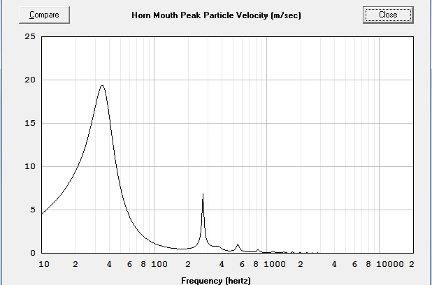

i've also attached horn mouth velocity at 85v. Keep in mind the horn velocity is shown WITHOUT the hipass, thus the reduction in voltage at the peak will easily keep it within the 15 m/s threshold (barely).
I might also add that although I've shown the graph in 2pi, its permanent home will be wall loaded (driver facing a solid brick wall)
I like your design here, Sine143. I have been following this subwoofer forum and and playing with Hornresp for a while, trying to come up with some decent designs for a pair of 18" Peavy LowRiders I have here.
I have learned how to use Hornresp pretty well, but I can't find any directions on how you modeled the tapered port. I can see from your schematic you posted how it is supposed to look, but I can't figure out how you did that. Would you please take the time to explain this to me?

Dropped it off at its new home. unboxed their driverack PX and went about setting it up. I am VERY pleased with my initial impression. SOLID output, and I was maybe looking at 10mm excursion p2p during testing. good extension into the mid 30s as well. I would put this cab up against 2, possibly 3 single 18 budget cabs (peavey, yamaha, jbl etc) ANY day.
the budget cabs generally sport drivers with weak motors, and 6-9mm xmax. they do make up for it with light cones, but as far as output below 50hz goes, this cab has it by almost 10db in output capabilities.

Jimmy 420, refer to this little gem of the internet, Hornresp for dum....erm everyone
http://www.hometheatershack.com/for...32-hornresp-dumb-hmm-everyone.html#post324331
By using the alternate method for vented enclosures (not the simple one where you just plug in Ap and Lp) you can form complex horn shapes with as many segments as you please (hornresp segment cap permitting).
