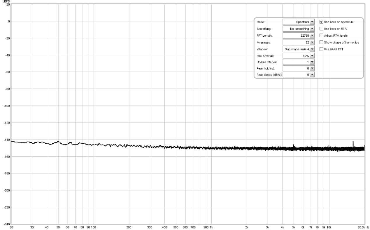

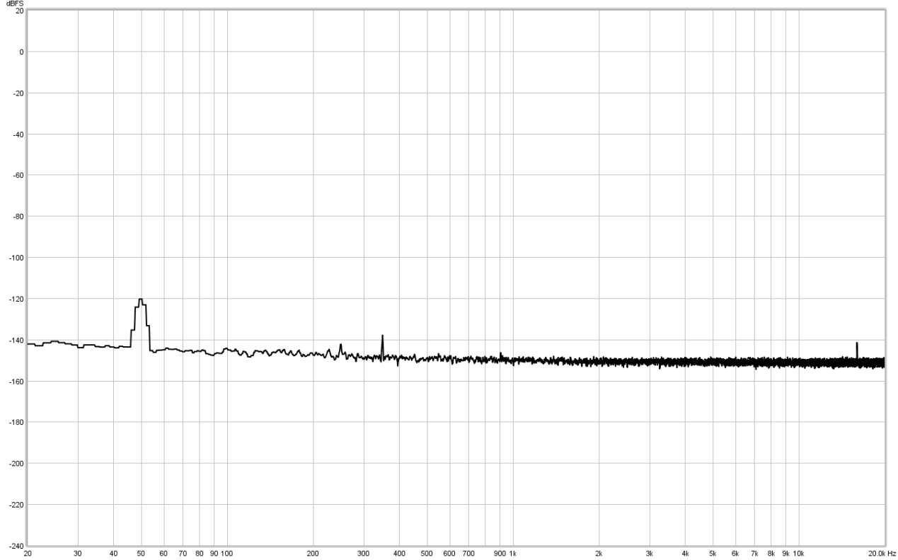

@trobbins
Power amp off
attachment.php
and the noise of the interface itself (interface out plugged directly to in)
attachment.php
Looks like the 50hz could be a ground loop with the interface?
If the mains frequency bump goes away with the amp power cable disconnected then that would certainly indicate a mains lead related loop with your measurement system.
If the bump remained, then that would indicated pickup from the local environment, given you would have a signal connection going to a dummy load that has cabling back in to the amp, as well as the probe and interface to the soundcard may be a bit susceptible to nearby mains wiring or equipment.
I have to turn one bench light off to remove some noise artifacts I get, and I insert a USB isolator when using cheap soundcards to attenuate mains earth related loops.
If the amp power supply rails hold up for a few seconds when mains is turned off, then you may be able confirm any influence (or not) of a mains cable loop from your 'amp on' spectrum mains harmonic bumps.
The 1W spectrum should allow you to calculate the nominal rms voltage of those harmonics, as an indicator of how 'measureable' they would be with a meter.
