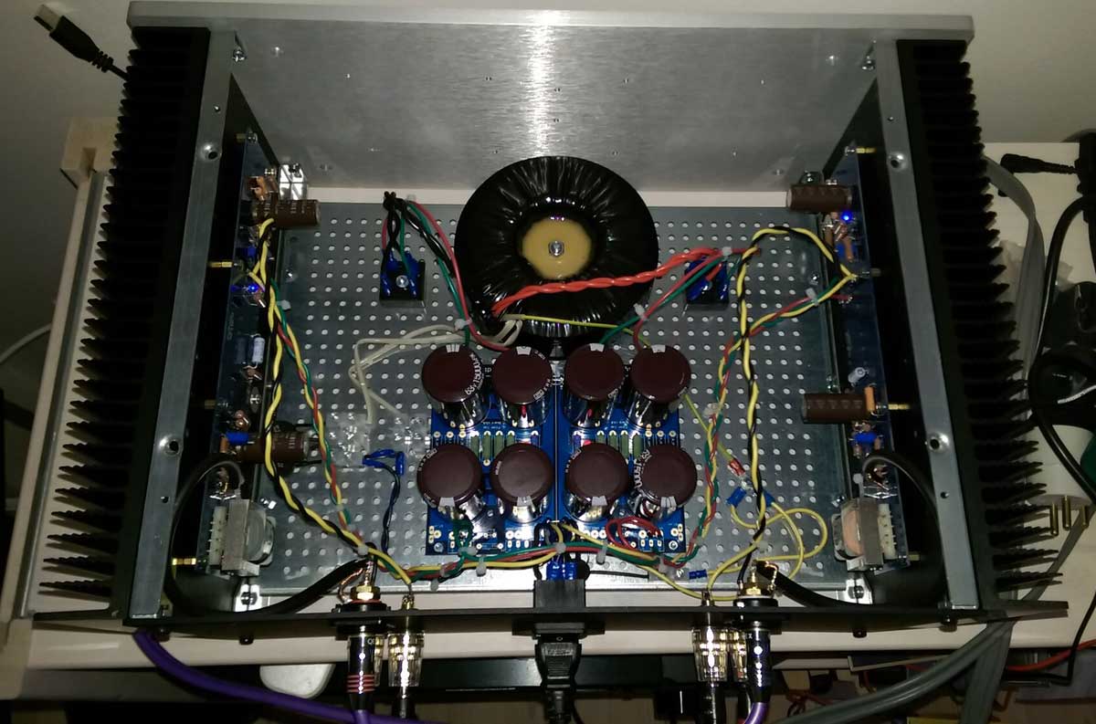

Ok, now for the build – here’s a picture, sorry it’s not great, but I hope most of the important bits are visible for those interested. If you are familiar with 6L6’s guide, you will probably notice that I based my layout as close as I could to his. I did not have an L bracket for the transformer, but luckily it just fit next to the PSU board!
Points of note for newbies like myself:
- All AC wiring involving 230V should be fixed mechanically. I used blue shielded crimps for fast connectors. These did not fit the pins on the fuse that connect to the switch on the IEC socket, so I hooked the wire on the holes, soldered and covered with heatshrink (I cannot remember where, but I read that soldering is OK if you can hook the wire securely).
- When connecting AC 230V to the primaries of the transformer, connect put two CL-60s in series with on the live wire to limit inrush current.
- The transformer I used (Toroidy 400VA) had an earth (0) wire – as I understood it, this is from the shielding between the primary and secondary windings. I connected this to the star ground (right side, red crimp connector). Please correct me if this is wrong!
- If you buy toroidy transformers, note that they don’t supply the M6 screw to fasten it. A 50mm one will fit nicely.
- The large pads are a pain to solder (especially on the PSU board), I set my iron to 330 deg, heated the pad and deposited a ring of solder before putting in and soldering the component.
- If the LED on one of the F6 boards doesn’t light up when you power it, check that you have the LED orientation correct by touching the pins of a spare LED (always buy extra!) to the pins of the one connected to the board in the opposite orientation.
- The back panel parts kit does not contain enough standoffs for the channel boards AND the psu board, so I used M3 screws with 3 bolts. This brings the board to a height that’s slightly higher than the standoffs.
- If you’re new to crimping, buy lots of the crimp connectors – I bought 30 of the fast connectors and used all of them learning to get a good crimp J
- On first boot with the channel boards connected, the voltage across the 0.47ohm resistor can take a while to build up, so be patient if you see 0V and everything else checks out.
- When you bias, short the inputs. I didn’t have any load on the outputs, but as I understand it that is a possibility (e.g. a dummy load).

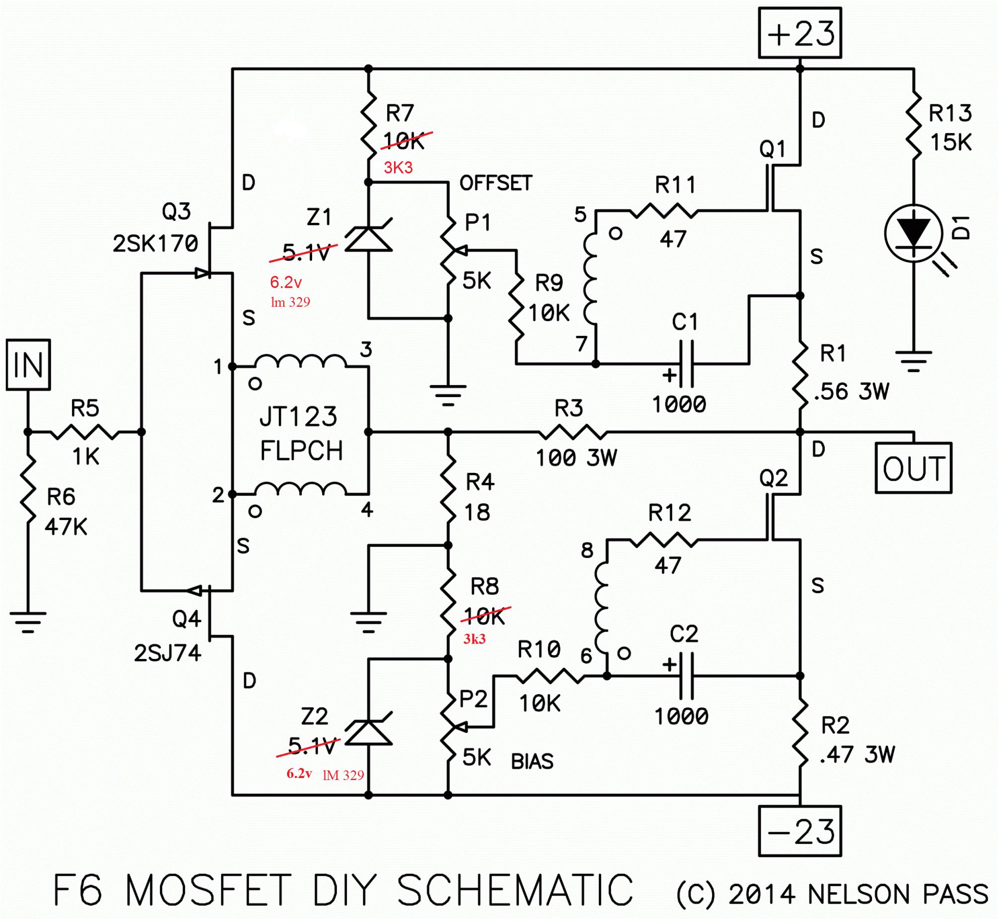

Now, I also have a question for other builders regarding the bias. After ensuring everything worked and letting the amp heat up for around 30 mins I dialed a bias of 0.52 and with zero (or as close to as possible) offset. I then let it stand for a while with nothing connected to the output and watched the bias. It remained reasonable stable, climbing a bit after about and hour (10-20 mV). I dialed it back down and tried with speakers. Even with cheapo test speakers it sounded lovely already. The next day I let it play all day while keeping an eye on the bias and offsets. I noticed towards the end of the day that it had reached a bias of around 0.57 V, with around 20 mV in offset, so I dialed it back down to around 0.52-0.53 and zeroed offsets again. I will keep watching it the next few days, but I am unsure what I should expect in terms of bias stability – how long should I expect the electronics to take before they become bias stable? Or is this already a sign of problems? So far I haven’t measured above 46 degrees on the heatsink, so I guess im still in the safe zone, but I prefer to play it safe and avoid smoke.

final Iq and DC offset setting will be stable for good , if you made them in temp equilibrium conditions , with top lid on .
as you already know , that's iterative process , but easy and trouble free , especially if complemented with some background music and cup of fave coffee/tee
for my liking , that is wrong type of connection of mains NTC (NTC legs easily damaged with screw rotation), and laid like that , their body dangerously close to metal bottom plate ; I prefer them placed vertically and soldered to hefty enough pcb traces
another solution , involving screws , can be only terminal block with screws and washers

Zen Mod - points noted, i now switched around the orientation of the CL-60 closest to the mosfet so its on the opposite side of the block, bent both upwards and away from the PCB and baseplate, and gave both NTCs and capacitor an extra layer of shrink wrap. By good fortune, the terminal block i bought from mouser has washers between the screw and pins/wires. I have triple checked now that no exposed metal is outside the housing.

ColinA - another tribute to Zen Mod, i used 6.8V zeners with 3.3k diodes.
