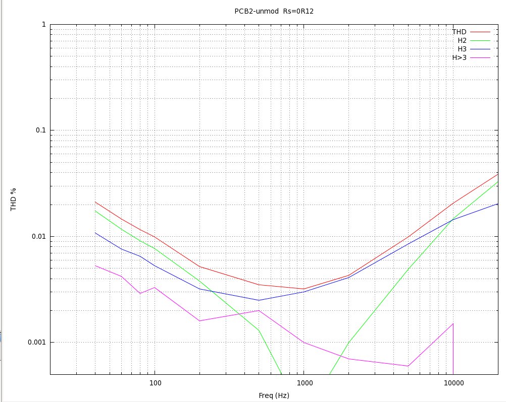

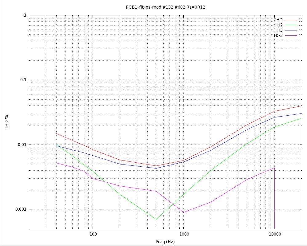

More Teaser-6 adjustments. I received two more SemiSouth R100s and measures their transconductance along with the two R100s from the channel that wasn't performing as well.
New R100 JFETS
Gm = 9.335S, 8.046S
R100 JFETS from suspect channel
Gm = 7.203S, 8.282S
I paired the 8.046S and 8.282S JFETs and reassembled the PC board.
I finally found the "sweet spot" for lowering 2nd harmonic in this channel. It appears to be somewhere near Rs = R05.
I am listening to it now and the sound is better than ever. With pots in parallel to the source resistors, it is easy to adjust for your preference of harmonic content and level of global feedback.
Here are the Harmonics vs Frequency sweeps for the two channels now.
As you can see, the 2nd harmonic is very low. The first plot is left channel that was previously the better one. The second plot is the newly configured and adjusted channel.
I still have no idea what harmonic balance and global feedback level Nelson is looking for.

Yes I have tried it with the pots at 0. Look back at post #1951 http://www.diyaudio.com/forums/pass-labs/216616-f6-amplifier-196.html#post3168846 The difference in output impedance between that and Rs=0R05 is small, but the improvement in the distortion is significant. Basically, I have found a combination of the 2 pots that seems to minimize the 2nd harmonic pretty much everywhere, but particularly at mid frequencies. It probably also helps that I have matched the output FETs for transconductance.
I know. I am saying have you tried with no degeneration?
Ok, now I understand the question.
I measured the JFETs in-circuit with a signal that gave a 4 volt peak output (1 watt). I measured the AC voltages gate to source and across the source resistor. I then calculated Gm = V(Rs)/(Vgs*Rs).
I unsoldered those R100s and tested them along with the new ones using my FET measurement setup using the same calculation and similar AC voltages.
I was asking about this, I assumed you used it to match the transconductanvce of your fets. I was going to check mine.
