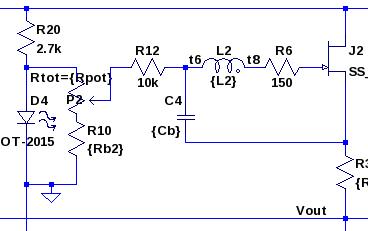

Do you realize what is effectively inside the TL device? A zener and an opamp with lotsa gain :D
Sayin it's better without any reason or data is dumb! Yep you ZM!
Sayin below 100Hz the JFET and Zd is better without any circuit description etc. etc. is just as dumb as ZM!
Sorry :down:
I need more convincing info than a basic sim and a Dummy...
You appear to be correct about that. Here is a Spice simulation of the two. The plot shows the ripple rejection of the two approaches. As you can see, the LED+CCS has a much lower corner frequency than the TL and is about 16dB better at frequencies about 100Hz.
I don't know. Must be Dumber than me? I read: Led+ccs VB2 ripple= 40uVp-p. Quite good in fact.
But, I also read:
TL431 VB1 ripple=17uVp-p???
Who is Dumber? Forgive me ZM :worship::worship::worship:
Not tryin to be Dumber :rofl:
Those captions are poorly stated. What they represent is the ripple rejection without the capacitors, which is the rejection of changes in the DC level of the power supply, ie. the ripple rejection at Zero Hz.

I made some measurements one of my Teaser-6 bias circuits using a variac to modify the AC line voltage. My measurements are the current through the source resistor and VGS vs. line voltage with zero voltage input to the channel.
The reduced numbers give:
delta_source_current / delta_line_voltage = 5.6mA/V
delta_VGS / delta_line_voltage = 0.67mV/V => 63.5dB

Don't get me wrong though. I want to know how good a bias ref the TL is??? and how to optimize for that purpose :D
