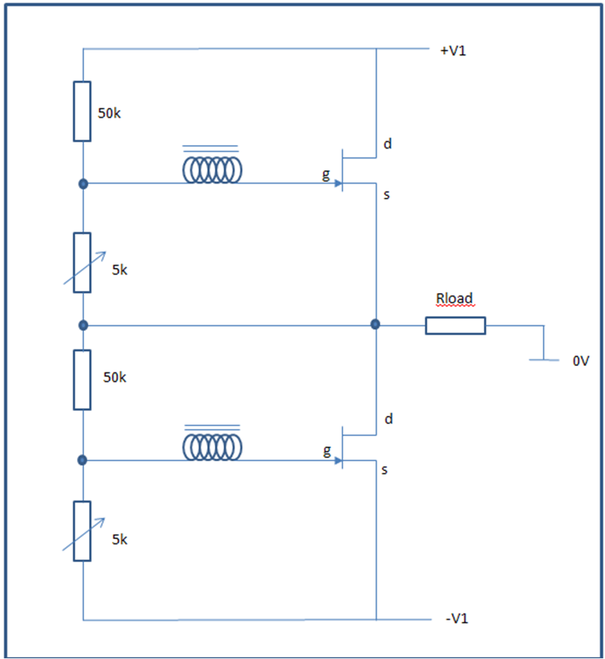

OK guys
Papa is somewhat intimidated with noise in this thread (too much questions directly addressed to him ) , so he sent me sch to share with you ;
he said - "later , when gunsmoke is gone ..... "
It's a simplified schemo...and the reason of course is that there is NO source degeneration going on.
No, you left out the Vds? Without it, you only have a capacitor g-sKeeping in mind the mantra I inferred from reading pass articles 10x ... the FET knows nothing about the world apart from what it sees between the gate and the source and will attempt to react accordingly...
Hold on, the current only does what the gate signal tells it to. The Gate pulls up the source. There may be interactions between the load if it is'nt just a resistor.... That makes the current flowing through the load push UP the source voltage and this reduce the VGS accordingly and this denegerates VGs (creates 100% NFB) and makes the voltage gain drop to 1x.
Remember, the Vds?The fet doesn't know anything else apart from VGS and so it blissfully just conducts away based on what it sees between gate and source.
Just tryin to help
Semisouth R100 is an enhancement device; like a bjt. The bias network which is found in the pdf of thread #38 will be applicable. The schematics of Mr. Pass are highly effective and usually simple [e.g. F6].The circuit is just are Nelson said in http://www.diyaudio.com/forums/pass-labs/216616-f6-amplifier-9.html#post3102389. The hard part is figuring out how the bias voltages are generated

meantime ... re biasing - would this work ?
This one allows to choose the bias. It's a classic. Recalls to me transistorized radios from the sixties, using germanium devices.
The attached pdf shows a possible bias network [OTLAmp3] . Please note that the name I gave this file did not use F6 in it; because F6 is a name which exclusively belongs to Mr. Pass.

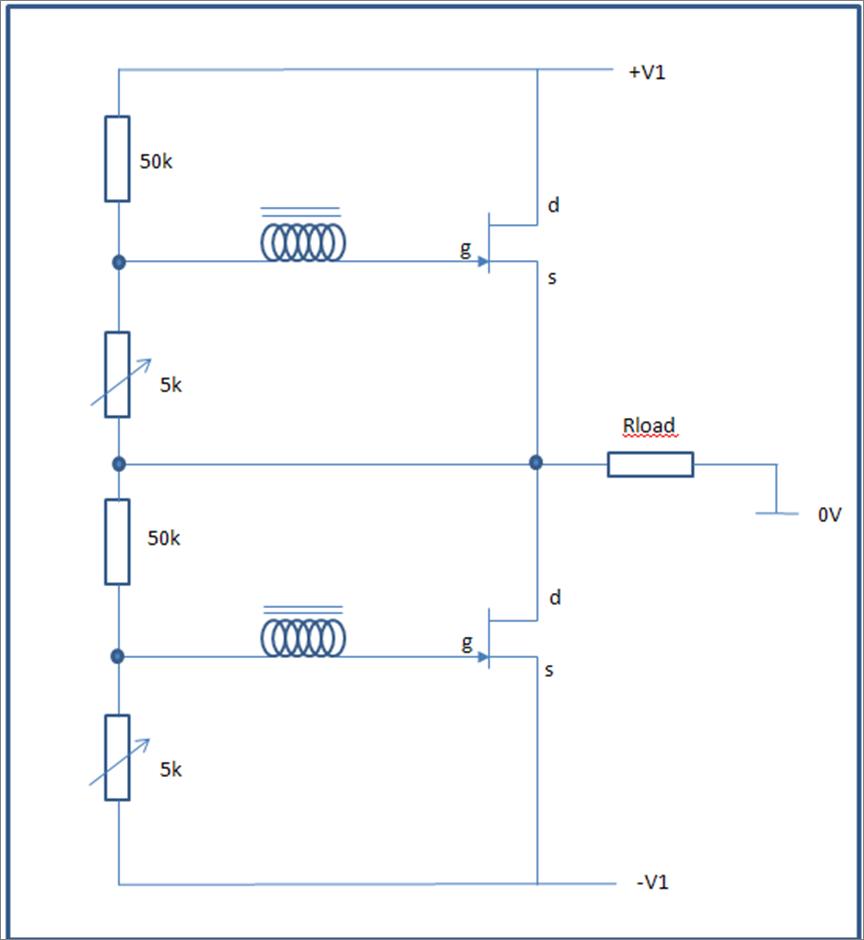

OK guys
