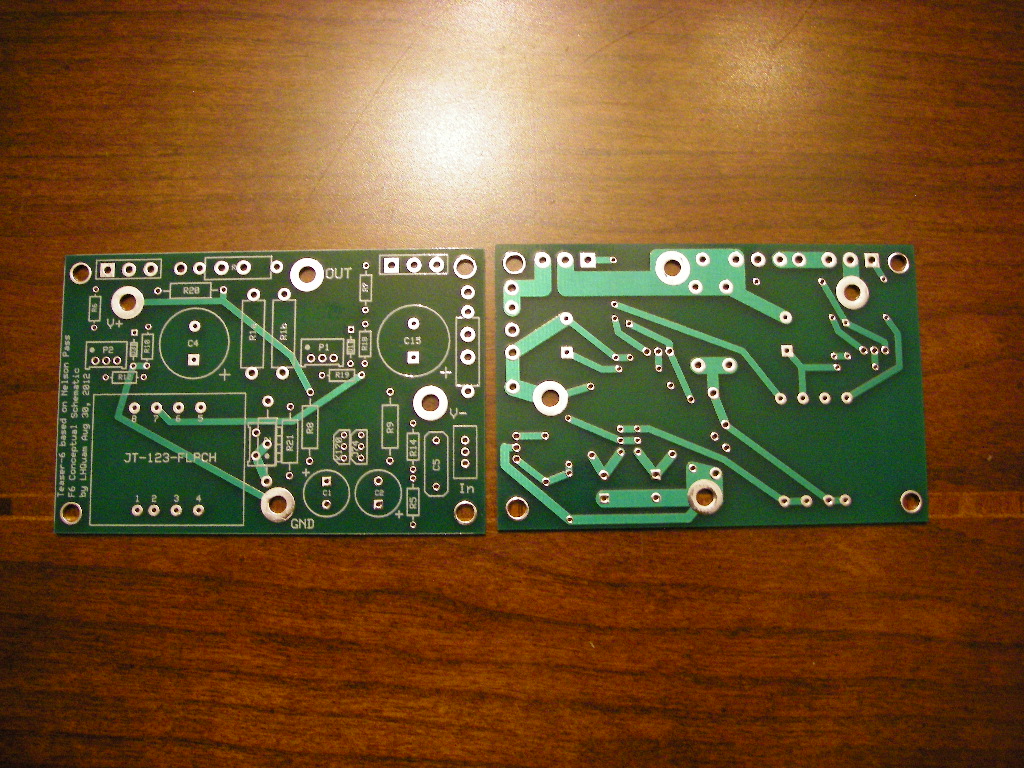

Look what came in the mail !
Thanks lhquam,
That was fast shipping.
The boards look great!

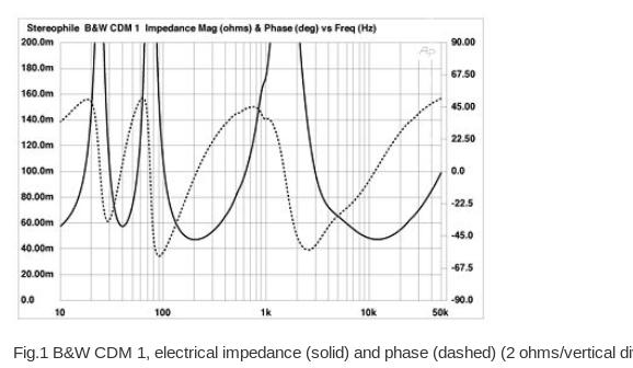

I have listened long enough to know that the Teaser-6 will NOT replace either my F5 or F5-balanced. :down: I am starting to have listener fatigue with this amp. Perhaps my implementation isn't up to Papa's standards, but the overall limitations imposed by the "F6 Conceptual Schematic" prevail. Bottom line: Too little open-loop gain.
Sorry to be a wet blanket. :(
I suspect the "boomy" sound on the bass is due to a low damping factor of about 4.6. I estimate the output impedance is around 1.7 ohms. The closed-loop gain is 4.7.
Your loudspeakers were optimized by its manufacturer to work with an ideal voltage source amp [Zo <0.1 Ohms]. Now you drive the same loudspeakers with TEASER 6 of higher Zo = 1.7 Ohms. TEASER 6 gave you [and us] the correct and expected answers. Your build is A+. Its got power, low %THD, is stable with no hum and buzz. Unfortunately, its loudspeaker mate is suboptimal. What is Zo for your F5 build?

Here is Stereophile Mag's impedance measurement of my B&W CDM1 speakers. Yup, my next tweak will be to lower the output JFET source resistors to somewhere near ZERO ohms, which will increase open-loop gain to around 100 or so. I could also reduce the closed-loop gain below 4.7, requiring an input source capable of higher voltage drive.
