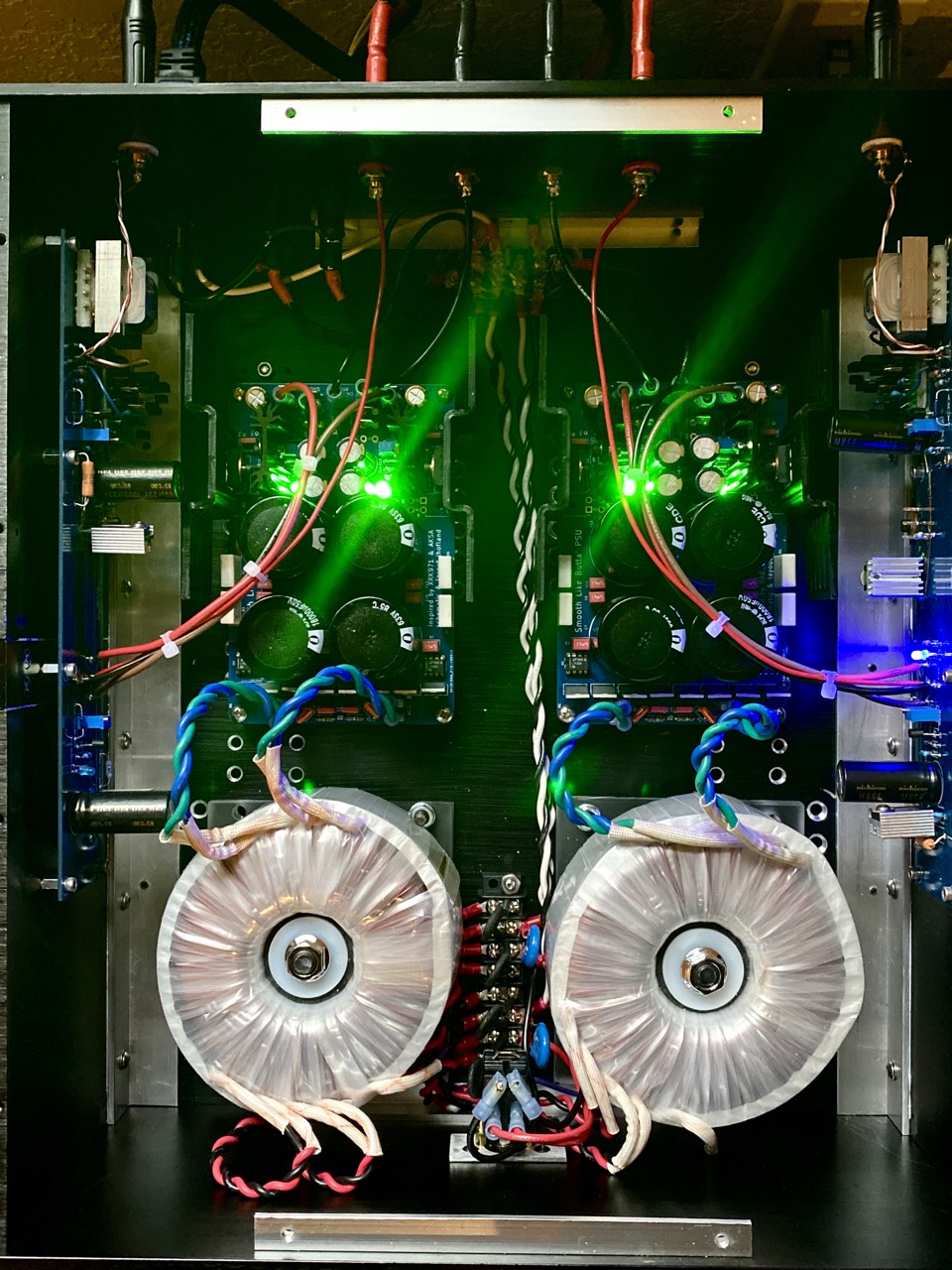

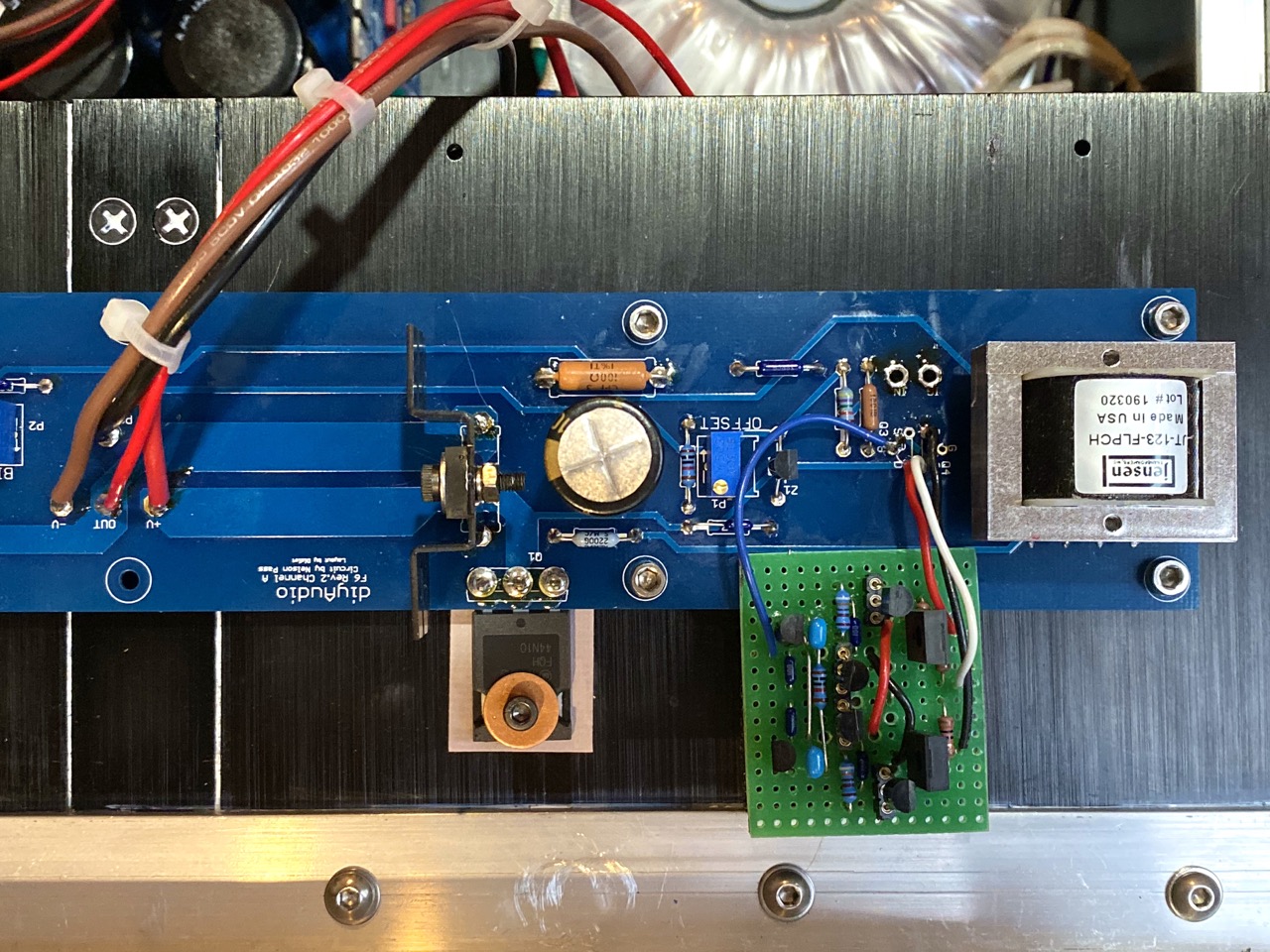

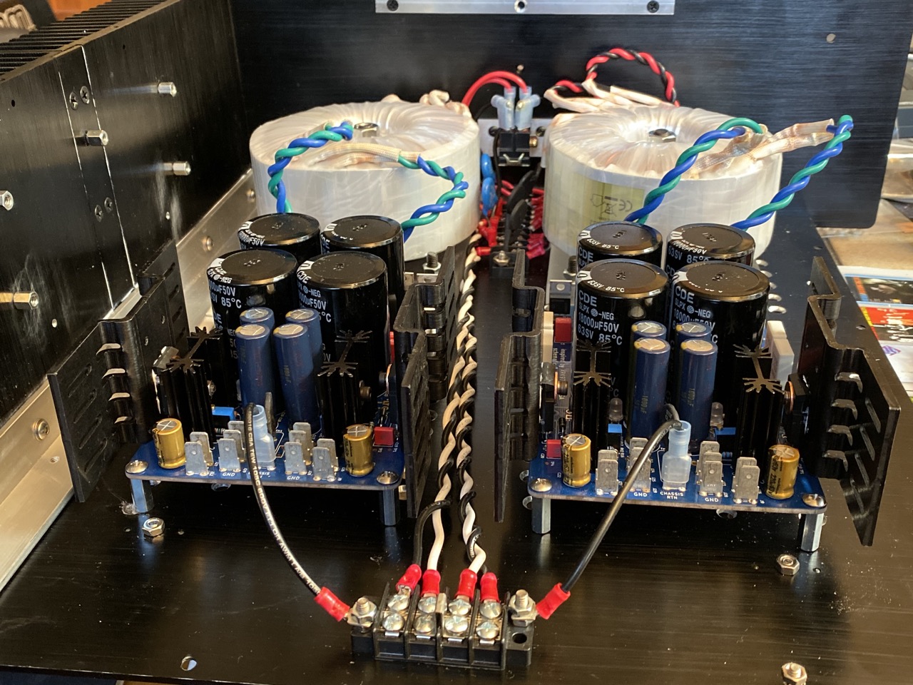

For going dual-mono, the practice I've adopted is to keep the PSUs completely separate for each channel. The only thing the two channels share is the AC power cord, even the power fuses are separate. The first picture shows what I did for my F6. I have a similar arrangement in my Aleph J. Each PSU board has a separate chassis gnd connection, which is through a CL-60 thermistor on the board. The audio grounds are maintained as separate star grounds for each channel. A short wire is routed from the star ground node on the PSU to the speaker (–) terminal. A separate ground wire connects the PSU to the channel board.
The second picture shows the overall PSU and speaker wiring. I don't find it necessary to twist channel board power connections, I simply route them closely to each other and secure with cable ties.
do you put a CL-60 on each PS ground to chassis? .
Yes

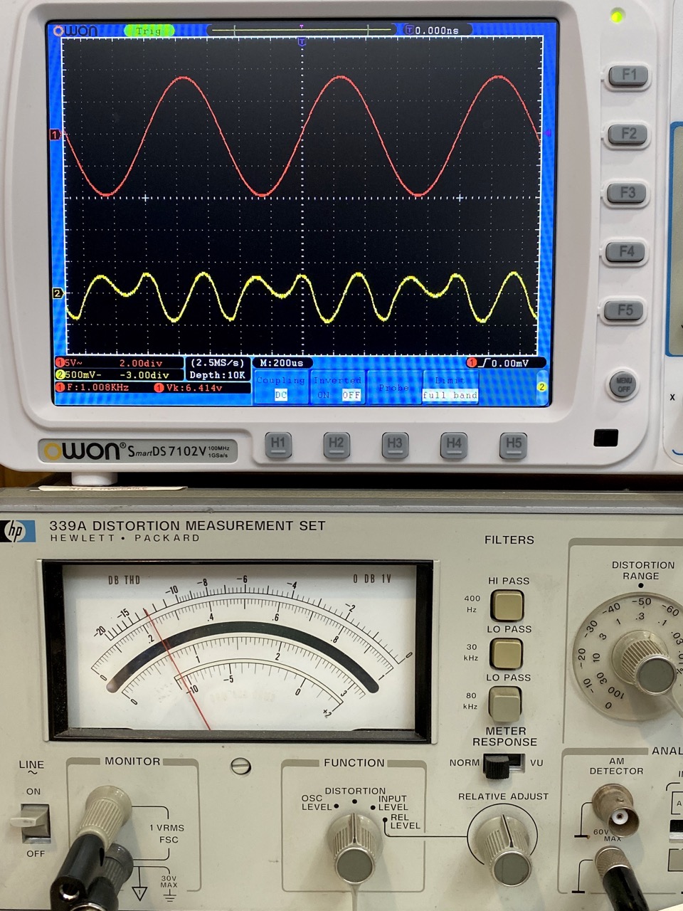

Following up with some measurements of my recently completed F6...
Hooking up my 339A to the amp revealed quite a bit more H2 than I was anticipating. At my customary output level of 5 Watts, there was about 1.2% THD, predominately 2nd harmonic (H2), with a noticeable amount of 3rd as well. At 1 Watt output, THD was about 0.8%, almost entirely H2. Since I started with a modification to the connection of C1, I decided to reverse that mod in order to re-measure a baseline with the bias coupling capacitors (C1 & C2) in their default configurations, meaning low side connected to the Source of their corresponding Mosfets.
While I had the amp opened up, I also took the opportunity to increase the bias current to 1.64 Amps. The newer configuration has now been through a few listening sessions and an overnight thermal soak. The picture shows the latest measurement at 5 Watts output. Distortion is now down to 0.07% with a mix of H2 and other harmonics. This is a lower level of THD than my Aleph J exhibits at the same power output, though the Aleph J presents almost all H2. Of somewhat academic interest, at 1 Watt output, the F6 has a measured THD of 0.025%, with a residual waveform that looks much like it does at 5W output.
Subjectively, the amp sounds wonderful. It needs a longer warm up period before the heat sinks reach thermal equilibrium. Once that has happened, the instrumental detail of recordings is almost uncanny, as is the spatial detail (how ever that happened to be engineered in the recording studio). The difference in sound, compared to the the previous configuration with its higher THD, is difficult to describe. The high level of (negative) H2 present may have sounded more exciting on some recording, but would have likely resulting in more listening fatigue. As with the Aleph J, I expect the sound of the amp to evolve a bit further as it gets more playing time.
I do have another measurement to make to see how the Diamond buffer front end is doing its job. Later on, I may try goosing the bias current up to 1.8 Amps to see how that sounds. I think that's about as hot as I will want to run the amp. The big aluminum L brackets that I added are definitely doing their job, as the base plate of the amp gets pretty warm along with the main heat sinks.

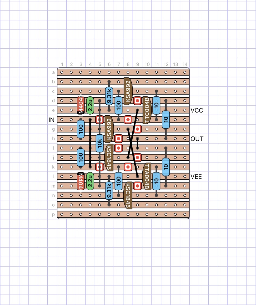

Following a few sets of measurements and some conversation with Mark Johnson, who is responsible for the Austin input stage, I've determined that the diamond buffers I'm using in my F6 are doing their job quite well. It turns out that passing square waves from my iPad through some inexpensive mini-phono to RCA cables caused a small amount of ringing right at the input of the amp. This is reproduced faithfully by the buffer and the rest of the amp. Rising and falling edges are fast and clean, with no visible anomalies. So you all may find the Vero diagram and a picture below to show how I built the diamond buffer into my F6.

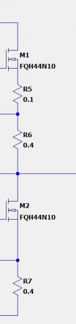

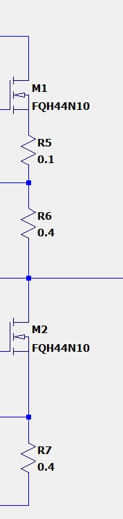

My circuit is currently the same as implemented on the PCBs from the store. That is, the low side of C1 and C2 are connected directly to the Source pins of their respective Mosfets. The 'upper' source resistor is 0.50 Ohms and the lower source resistor is 0.40 Ohms. I'm using 5W thick film resistors with flag style heatsinks to improve power dissipation. They do get warm.
Try this arrangement.
This should get you where you want to be.
If you desolder the source pin from the pcb (ie electrically disconnect source pin from pcb) you could then add a 0.1 Ohm resistor directly to source pin, then solder other end to pcb. Then add 0.4 Ohm in the usual location to achieve the same result attached.
This will get you in the ball park for the kind of distortion you want
Just reduce to 0.05 Ohms if it's still too much of a good thing.
