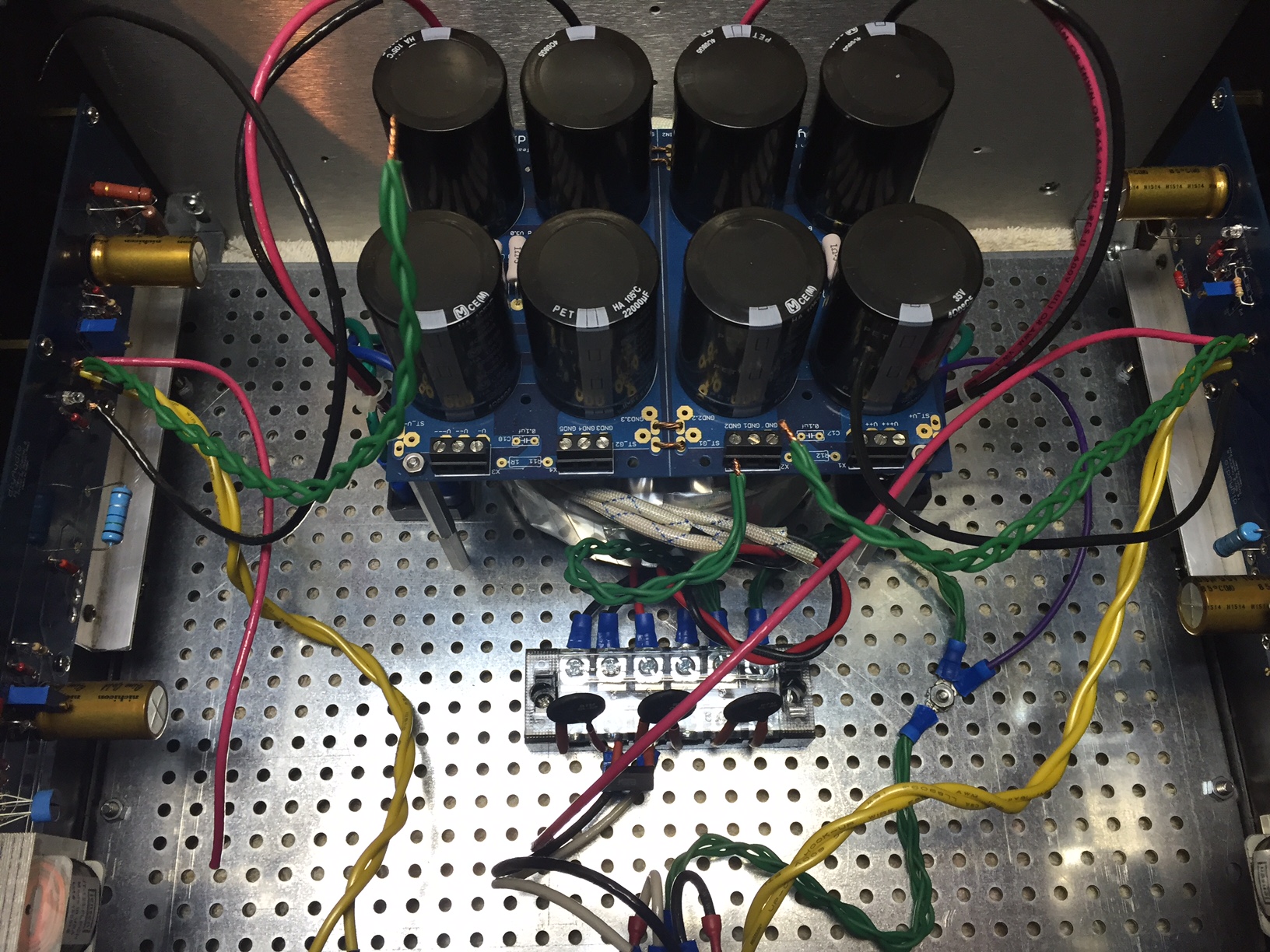

My friend Tim came by for a listening session six months or so ago and promptly decided he wanted to replace his commercial stereo, so we embarked on an F6 build. I organized the BOM, selected the parts and their sources and made him do all of the work. He lives 400 miles away so our build sessions were sporadic, but when he was in town he'd swing by for an evening's work. I pretty much stood behind him as he soldered at my workbench. That amp was completed last night and sounds terrific.
We did encounter one problem: a few of the parts we used were pulled from my inventory, including the fuses. I didn't have any 2.5 amp slow-blow fuses, so we used a 2 amp fuse that lasted all of 1.5 seconds before frying. The next smallest value I had on hand was 4 amps, which naturally worked. I'd like to verify that there isn't a safer value for Tim's amp. We deviated from Nelson's design in the power supply: we used an Antek AS-4218 toroid and eight 22,000 uF Panasonic TSHA caps (176,000 uF in total). Everything else was stock (Store F6 and PS pcbs, 4U Deluxe chassis, etc.).
Can someone explain how to calculate the proper fuse value for Tim's amp?

3AG slow blow type 2 1/2 amp for 120VAC
Straight from the F6 manual. I usually just use a 3 amp. If there is a serious problem a 3 amp is going to blow. The 2 1/2 amp is not as easy to find as a 3 amp.

My F6 uses 8 x 33,000 and 2.5A or 3A work fine. CL-60 slow start, per first watt power supplies. My BA3 amp, same 8 x 33,000 power supply does too, but it uses the store's slow start. Same fuses since build completed in both. 2.5A was specified for stock supply, I figure if they blew on start up, I would just creep up until they didn't.
I inquired about this during my BA3 build, and I think Andrew responded with such a formula?

I'm using 1.5A slow blow fuses on the 240V AC mains without issue.
Based on my results a 3A slow blow should certainly work on 120V AC.
Are you using the thermistor soft start?
It's cerainly not hard to calculate mains current if you know your secondary transformer voltages and currents, however I'm extremely lazy to write out the procedure.
I'm sure you can work it out.
