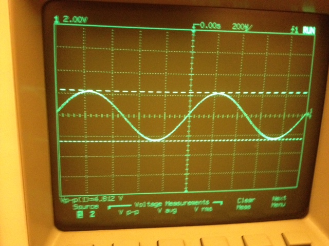

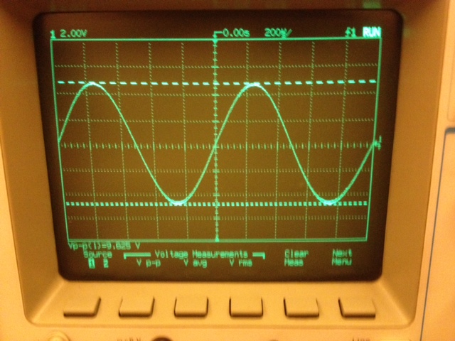

Results:
Both secondaries connected, trace 1. Output is 9.8V.
Top secondary bypassed, trace 2,. Output is 4.875V
Bottom secondary bypassed, trace 3. Output is 4.812V
Summary: So, the sum of the two halves individually = 9.7V vs 9.8V when theyre both connected. Seems close enough to suggest that the initial hypothesis that both halves act to provide equal amounts of gain (in common source) is correct.

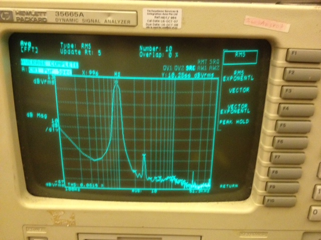

Warts n all open loop, the distortion performance seems pretty remarkable by comparison to a conventional complmenetary push-pull stage built. Here, (trace 4) you can see that theres zilch even harmonics and all were left with is 0.07% THD, almost all of it 3rd harmonic with very little higher order stuff.

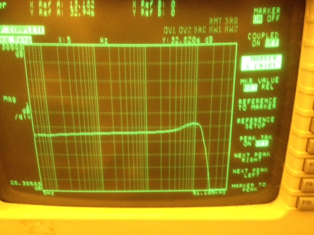

The op stage needs some local feedback so as to reduce the miller effect on input capacitance which is very high. Having said that, the open loop freq response incl tx was quite usefully flat (trace 5). Seems to me that this would run quite respectably as-is w/o nfb if one could live with the HF rolloff and high o/p impedance. Addition of some feedback on this relatively linear stage will make for a pretty nice amp i think.....

Results:
