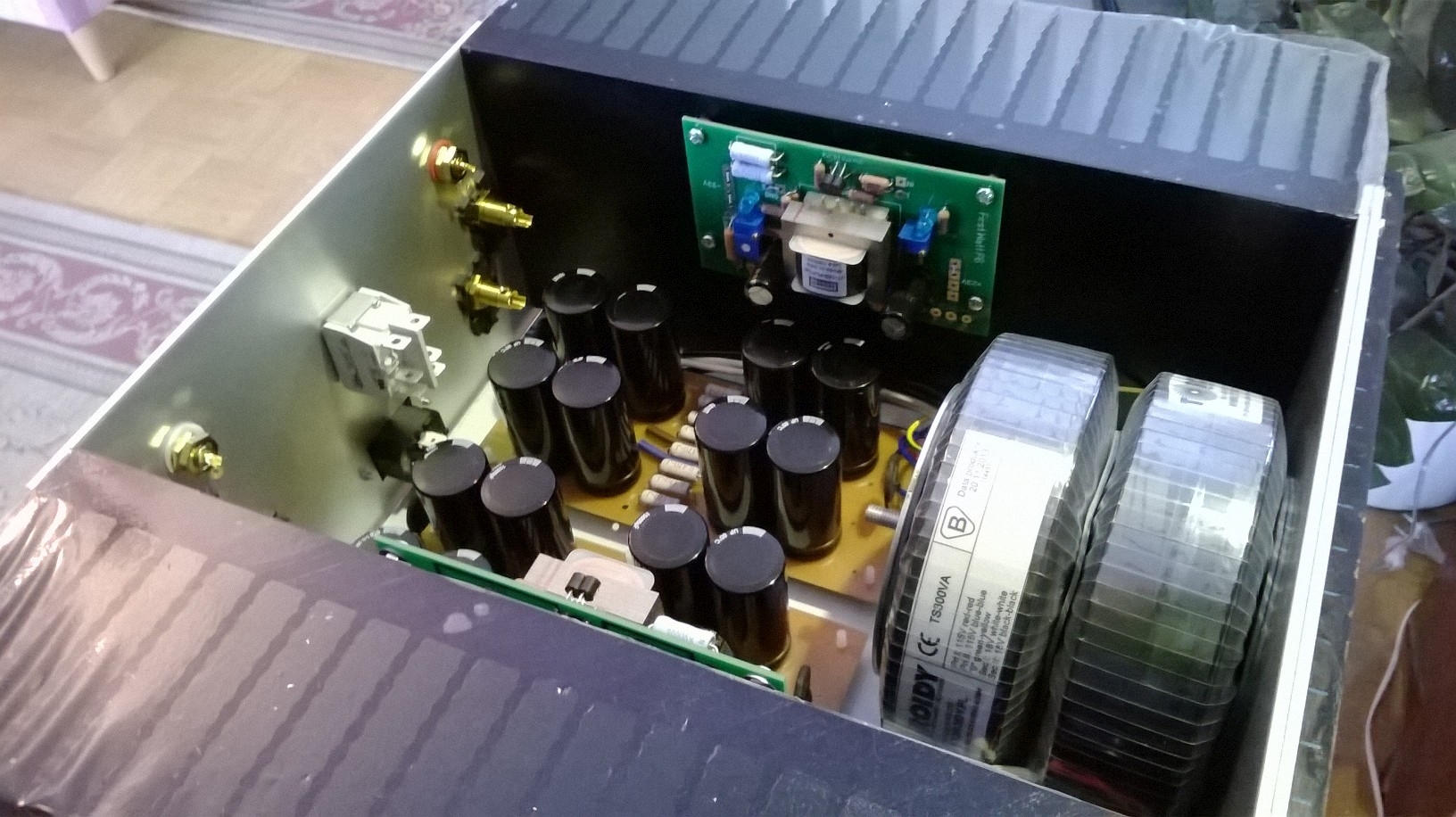

Finally after months of waiting to finish the F6 project, I managed to complete during the Christmas holidays. This is based on Tea-bag's boards, Jensen transformers and Semisouth Power Jfets bought sometime back.
I am using a single blue LED on each side for bias. Also implemented degeneration resistors on input JFets and the FET are at 8.7 mA IDSS rating.
Everything else pretty much as per Papa's buffered circuit. No degeneration resistors on the outputs.
Biased well and stable. Only small hitch is that I am able to push one of the channel's bias current to max of 1.3 Amps and not beyond that. The preset has reached it's wiper end. The second channel has no such problem though and is able to go to 1.5 Amps bias.
Did a basic sound check and there is no hum or any other distortion. Need to do full listening sessions. The chassis and power supply are from an earlier F5 build. Attached are couple of pictures. Excuse me for the wiring, I will tidy up soon.
Thanks to Mr. Pass for this wonderful gift.
Cheers.

Did some listening today with my favourite tracks. Sounds simply amazing. One of the best amps I have heard in all of the amps that I made of Mr. Pass's designs. Has terrific dynamics, amazing clarity and sweet sound. One channel is running slightly lower bias at 1.3 Amps compared to the other channel which is running at 1.5 Amps bias. Cannot make any difference in their sound. The amp is feeding Fostex FE 206E based Back Loaded Horn speakers and they sound wonderful.
I will try and add a second blue LED in series to the first one to increase the Bias voltage to be able to set the other channel to 1.5 Amps bias as well. Am I in the right direction? Any suggestions and help is appreciated.

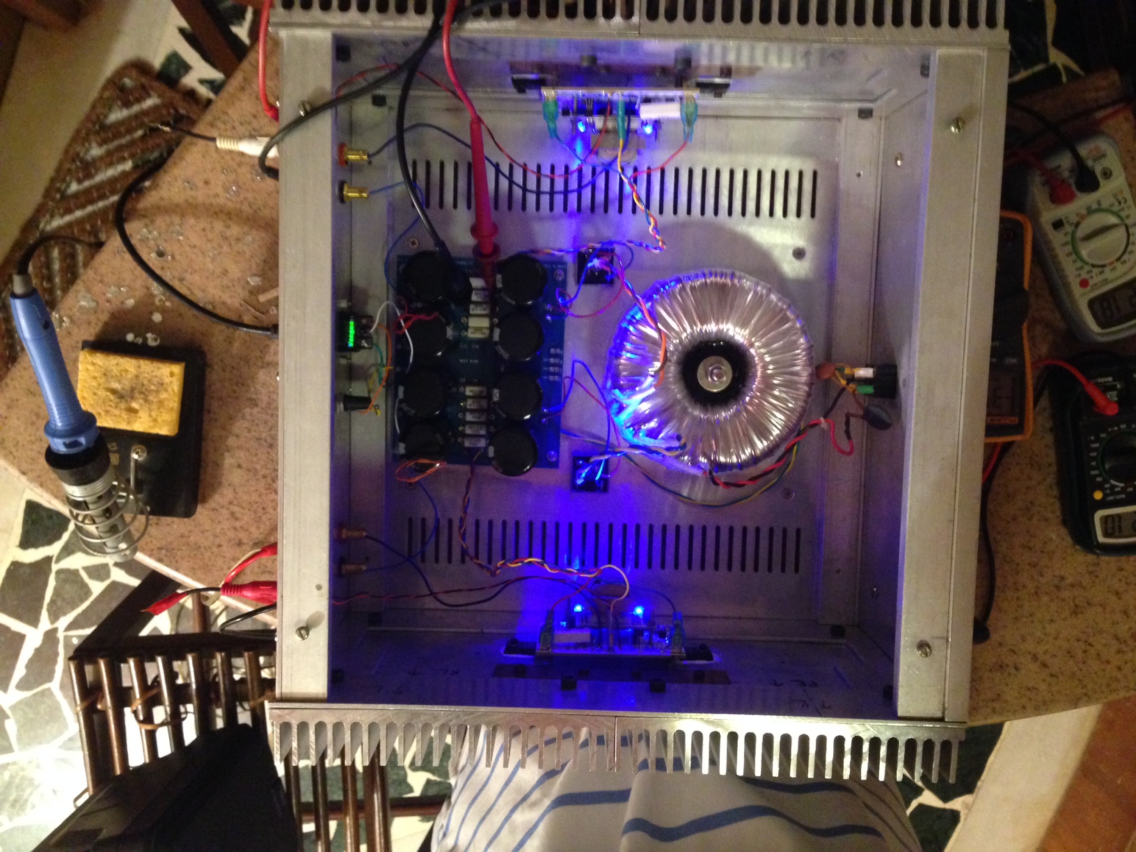

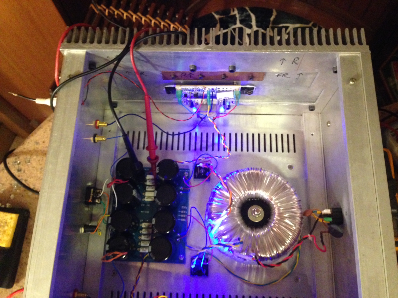

Ready to start this thing up... Power supply tested. Both mono sides give +/-25.8 VDC.
Got one multimeter on the speaker outputs to measure the DC off set. Another multimeter between amp -23V input and power supply to measure the current.
How about the pots? They should be turned 'down' to start with. Would that be anti clock wise or clock wise?
Anything I'm missing or should account for?
She lives! :D
Wow… everything's gone smooth and fine. No problems at all... I'm a little amazed... :cheers:
Biased both cannels up to 1.55 Amps. They will go higher but I’ll stop here for now at least.
Connected my desktop speakers, cellular phone and Chris Jones via Spotify. Sounds pretty deasent already. Especially noteworthy is how deep the soundstage is and how the speakers disapper. Will be interesting to put in the main rig.
I’ll but in a pic or two of the finnished amp once we get enough light for a decent photo here in Finland. Still have to get the front plate done though.
But for now a hugh thanks(!) for all you who have helped me along the way. This is my first propper electric project – appart from some simple kits. Wouldn't have been able without you.
