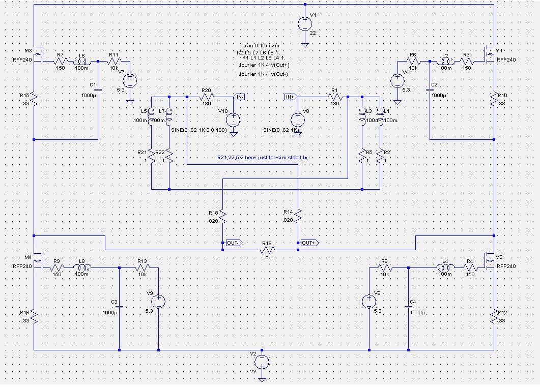

proper arrangement of 6-fillar , to have that funny toob looking feedback , as in original
thd spectra looks scary - only third , 80db bellow
I mean - scary , even if crude sim

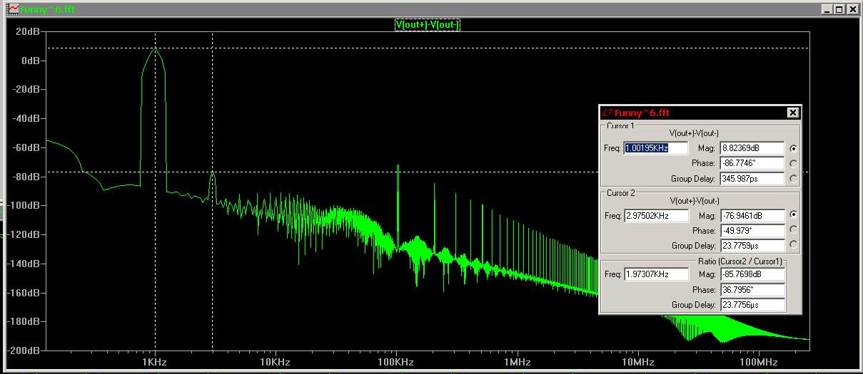

here it is , even if both crude sims (no capacitances in xformer models) , it's probably usable as comparison
will try later with some nF here and there
edit : enclosed what I have as Funny^F6 ;
tried with added parallel capacitance in data for each winding , 470p arbitrary
THD spectra looking practically the same
too late at night to play with sweep
it's indicative that Funny is having neg third .....

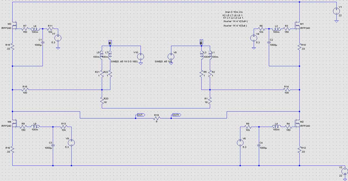

and - food for thought(s) for tomorrow - arranging two quad-filars to have same funny toob looking NFB , as in origigi F6 ....

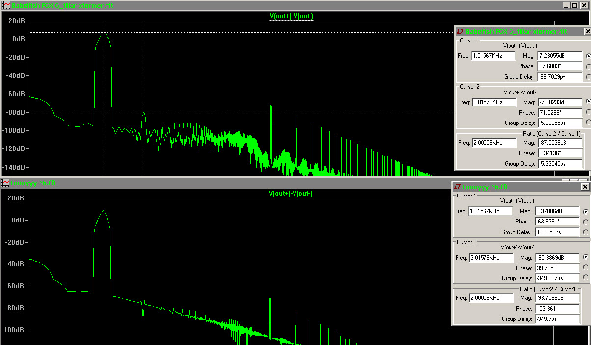

last one before going to sleep - I realized that I made it (sim) , 6 months ago - Funny^F6 , with proper NFB arrangement .......
here is the result (pics )
whatever - main difference between 2 x quad-filar and one 6-filar ....... seems phase difference between origin and third

Something looks wrong with the bottom (maybe both) THD spectrum. I have seen this before in circuits with capacitors. You need to run the simulation for a period of time before capturing data for the FFT, otherwise the caps have not stabilized. The causes the FFT noise floor to have the ramping effect from low to high frequencies. I see 20dB to 40dB reductions in the noise floor by adding a delay.
yup , I didn't include that then (working on/from old files ) but - what I'm interested in is relatively clean - I'm not looking much above , say , 5KHz and only for gross peaks/dips
though , different thing when simulating for freq sweep
anyway , tnx for noticing - always beneficial to share tricks'n'tips
