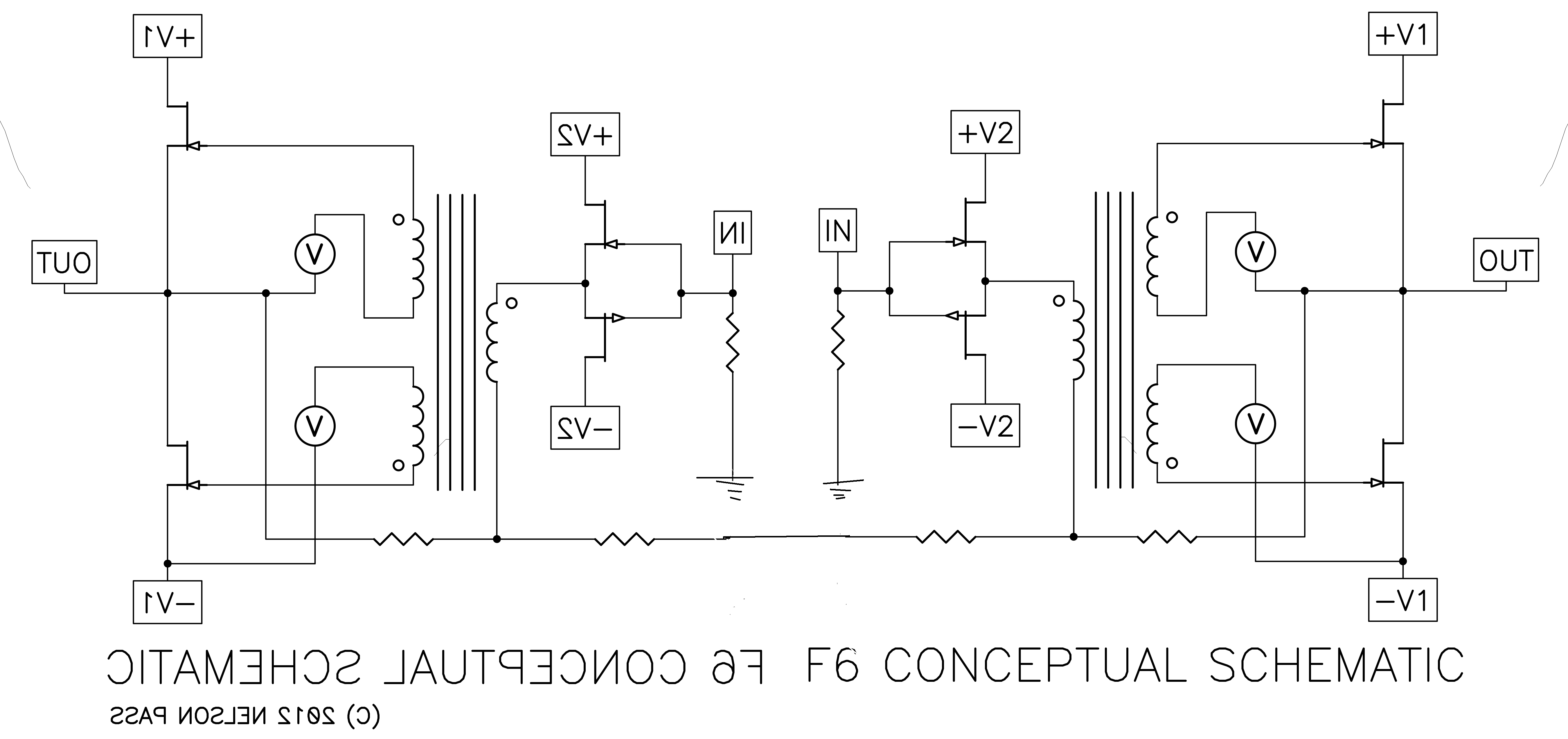

No worry. Your initial objective was to assemble a classical balanced diy F6. Suppose you already have a stereo diyF6 [Franken..]. Both possibilties can be tested; especially the classical diyF6. The other option requires a bit of surgery so as to arrive at the "crosstalk" configuration of your schematic. Need to lift 2 resistors [18 Ohms each?] off ground and tie their free ends together. This maybe an easier/cheaper approach than a whole new assembly.

buzz had that version ( which I referenced as funny mirrored) where he didn't use resistor to gnd
that one will lead to decrease of THD ....... or at least decent THD, even if not in same manner as SUSY
however - decent THD is , as we know , all we are looking for
I think SUSY itself isn't needed as preferring goal
my BF6X circ is having it (everything :rofl: ) , but -beware- I'm not telling that it must sound better than BA3 Bal -like F6 solutions
Zen Mod. Your circuit is unique because of its special error correction mechanism. Zo , % THD, Voltage gain and bandwidth with and without feedback are needed initially for one the two matched amps.
correction - that will be SUSY , without doubt
simple test - either mentally , or in vivo , or in simulation - when decreasing one input's amplitude leads to decreasing both outputs amplitudes ( not necessary in same amount !) , there is fair chance that circ is behaving SUSY
however , BA3 Bal-like stage is having some other characteristics , which I'm not going to address soon
