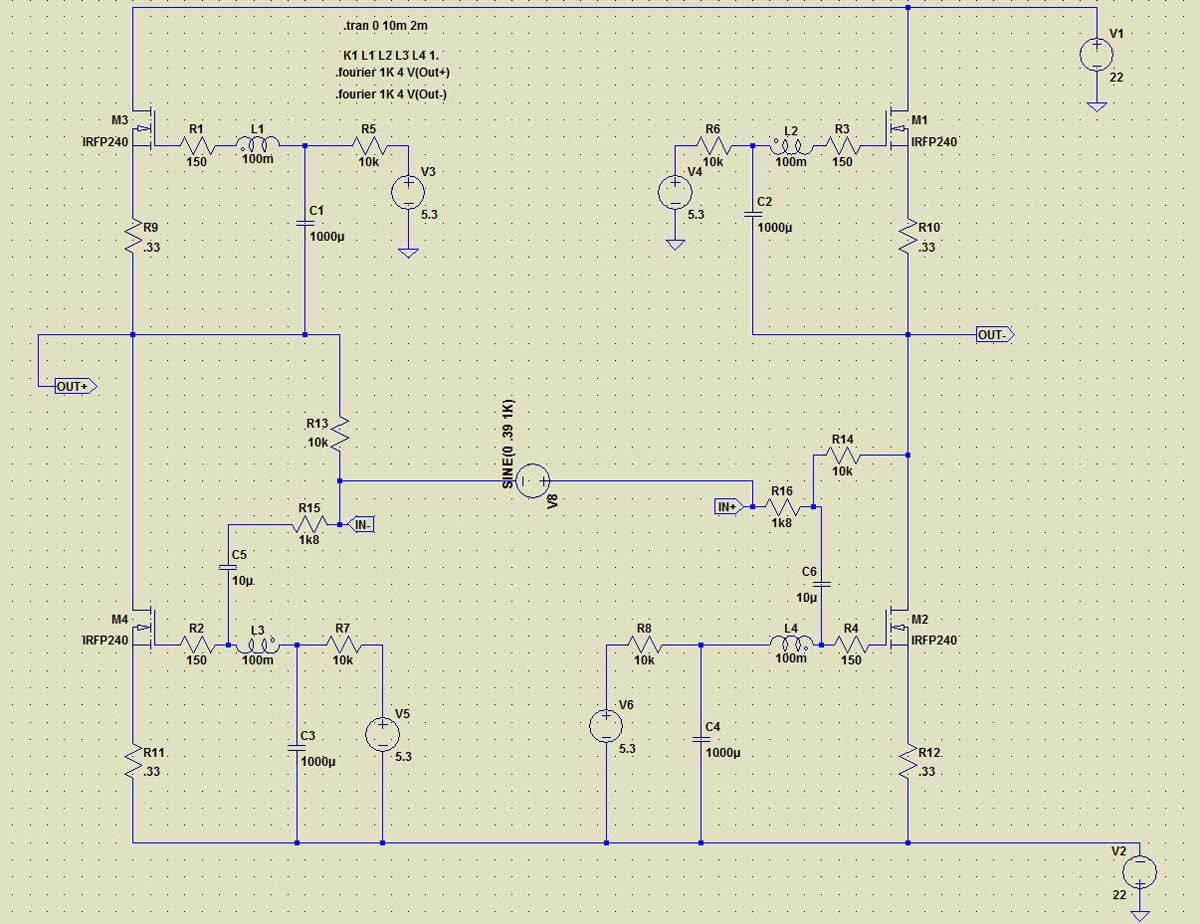

Good chance mine will never work. Main reason went first route, as it made sense.
better wait 'till tonight
will re-check my idea , after daily dose of work ........ and coffee
I'm not used to think at day :rofl:
as I said - first sketch needed proofing ;
here it is , little brushing and , voila! , this will work - as I had glimpse few days ago ; just needed to recollect my gollumgollum memory what that was ..... :rofl: ( that day I had a thought that key is driving just one winding , and left all other details for later thinking)
simmed with IRFP240 just for easiness sake
it seems I'm getting lazier each day ; using LTS for things for which I earlier used just a paper and calc
EDIT : naah ..... ooked something , as always
oomphteenth version will , eventually , work

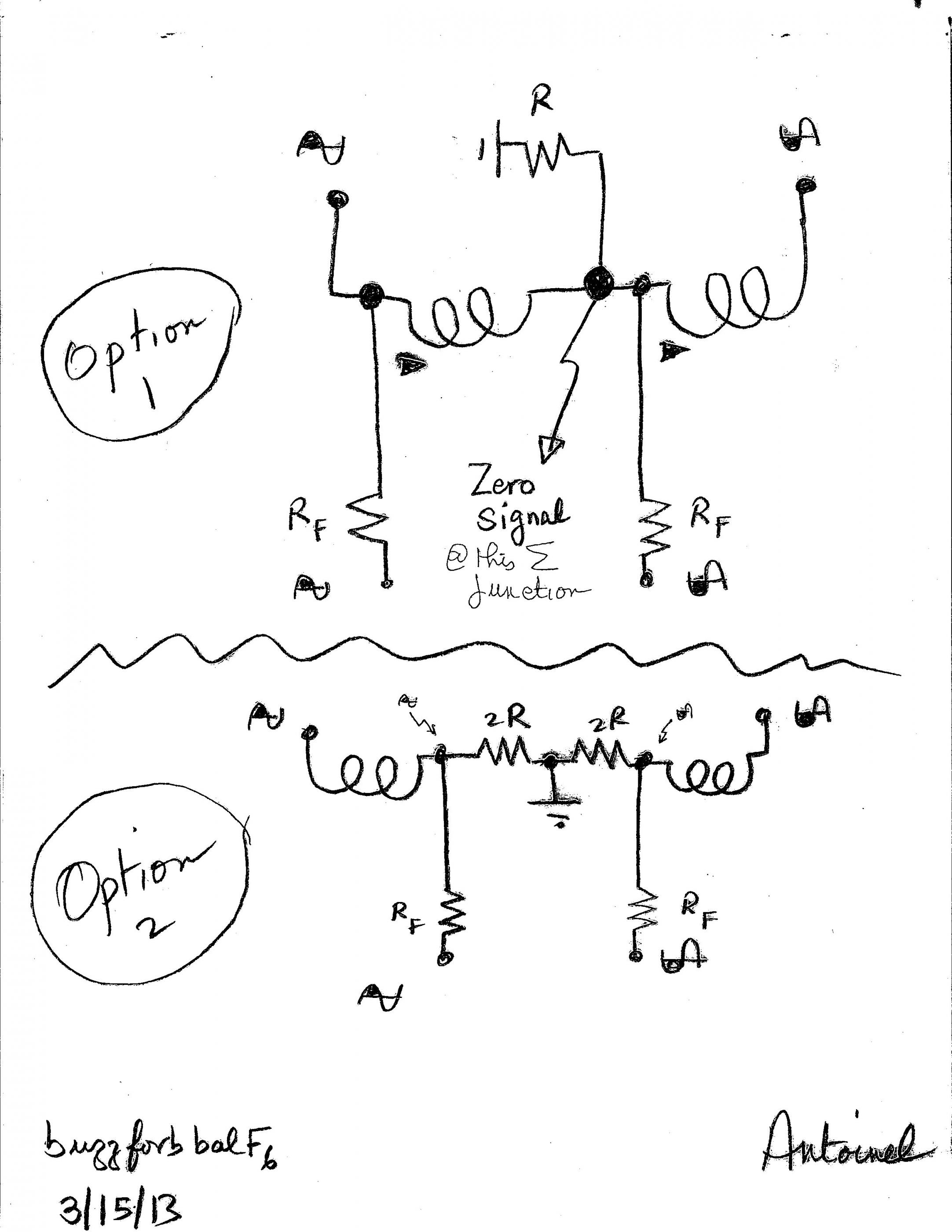

buzzforb. Please see the attachements. My initial focus is to examine the Front End [FE] of your schematic. I show two FE options. Which option meets your objective? Here is what I see in each option.
Option 1.
  • There is Zero Signal at the summing junction due to the superposition of two signals of equal amplitude and 180 degrees out phase.
  • Thus, each primary winding is not "differencing" the input from its attendant output signal like in the primary winding of stand alone diy F6.
  • Thus, the resultant amp may appear to operate open loop. But; I am not sure if this is a correct statement.
Option 2 resolves the potential problems of Option 1; by operating FE like solo diy F6.

I thought I understood what he (ZM) said but, when I looked at the pic, I didn't get it. I think it is possible to cross couple the feedback if the phase is correct. The xfrmr wiring is the key to that phase...
:Pawprint:
flg. you are suggesting to use the power output port of the right-side amp to feedback the left-side amp. And to use the power output port of the left side amp to feedback the right-side amp. Thus the input signal to each buffer and its "bridge" feedback signal are in phase for the purpose of differencing.

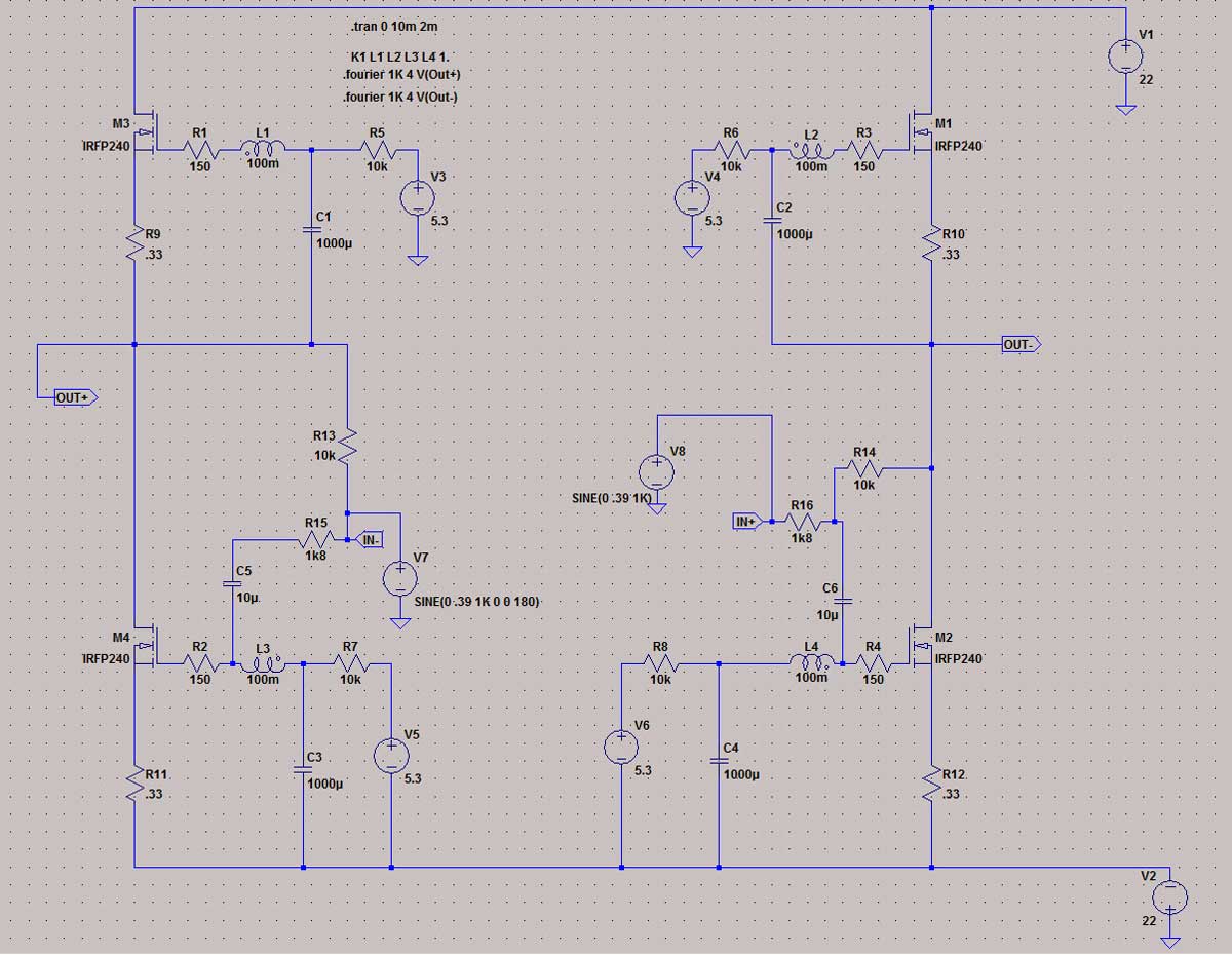

OK . here it is
two facts :
- previous one was perfect as SE input to BAL out ; sort of half SUSY .... half SUSY is same as little pregnant :rofl: :devilr:
- no way that ZM's dream of driving one winding is possible ; whatever , who cares - they're all coupled anyway , so no difference
- this one will work with either SE and Bal input , like intended
I forgot what's fourth fact , but who cares .......... aha - I'm satisfied - my usual brainstorming is usually having much more brainfarts than just two ...... and is lasting longer than just few hours

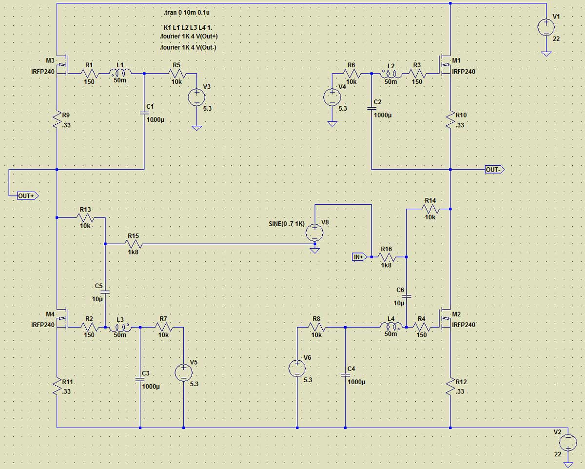

Cheapskate's versions
so - two versions for cheapskate Greedy Boyz
first one - functionally same as previous one with neg leg grounded - for CGB who is lacking in Jfets for input buffer ..... while not needing bal in
second one - for CGB , who is needing bal in , but is lacking some gnd in drawer ........ so - floating input
:devilr:
edit : first one was , essentially and effectively , what I posted in post #3862 , but still with messed up orientation of windings ; that's why I didn't realized that minus leg was redundant where it was .......
nasty redundantsess
