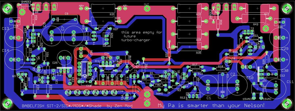

this one will fit even those Pa's Nail Gun Nails , as outputs ...... in every possible combination

Does the PCB pertain to your previous schematic using complementary SITs [TO-247?]. If possible, please show picture of SITs; or cover their name/maker if this info is sensistive. Projected price of this diy kit?
NB. Consider getting a Registered Trademark for BABELFISH.
May also wish to add Complementary Darlingtons in addition to the SIT, SIC etc., and make it more versatile.
Official Court Jester
Joined 2003
Does the PCB pertain to your previous schematic using complementary SITs [TO-247?]........
No ; they're rare beasts in complementary fashion
....... If possible, please show picture of SITs; or cover their name/maker if this info is sensistive........
no need for that - Pass SIT-1 , and pictures of these are well known
.....Projected price of this diy kit?.....
none in near future ; maybe MOS Shade , but that's on long rope ; even Semisouth iteration ( either SJDP or SJEP ) is , as we know , on thin ice - generally speaking
I'm finding at least dozen of things more important than that ; whatever - can you imagine anyone stealing brand Surrogate :rofl:

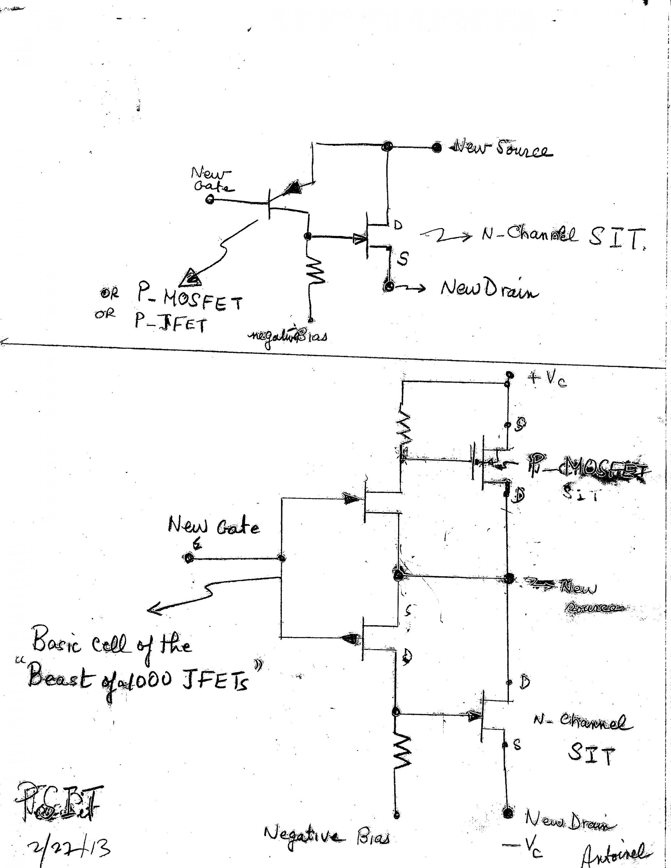

Zen Mod. On a technical note, please find attached options to make a quasi compound P SIT; like a quasi complementary PNP from a 2N3055 NPN BJT. I find the bottom option interesting; inclusive its possible Schade [or Pass] feedback

...... On a technical note, please find attached options to make a quasi compound P SIT; like a quasi complementary PNP from a 2N3055 NPN BJT. I find the bottom option interesting; inclusive its possible Schade [or Pass] feedback
bottom option is no gain no habla , at least how's my peanut brain grasping it;
upper option is an option , but not for Mighty Moi , at least not in Babelfish SIT-2 thingie - goal is to make toaster with sound and joy of GrandMa's toob radio , so no compound jobbie
