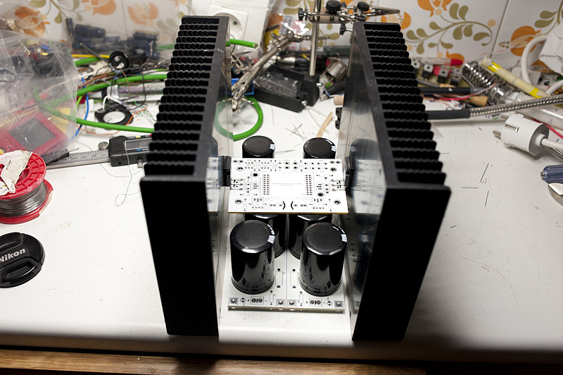

I am using a 3u 300mm deep sink per channel on my f6 build and use the same size on my moskido biased at about 1.2A per device.
I have one channel of the f6 running and biased at 1A per device. Let it sit for about 30 min and it was very warm but I could keep my hand on it. I will take a temp reading today.
Also I have a 4device per channel f5 and use the 4u 300mm deep sinks on it. Bias is set at about .5A per device and the sinks work well.
200mm on the 4u would be pushing it and you would probably struggle to reach 1A per device.

Here is a first attempt of what I will try to build.
The transformer and the rectifier will be on a separate chassis to minimize vibration and e/m interference.
The rest of the chassis will be made out of wood and I will probably add a small separately powered fan on the back to allow good ventilation in the small box.

You putting both channels in there? Seems like too much sink for one Fet, although you can never have too much sink. You will definitely have option of more bias. In truth. Having more space around caps and getting them away from sinks would help, but if you ventilate well, it should not be an issue. They have 85C rating and only improve lifespan below that.

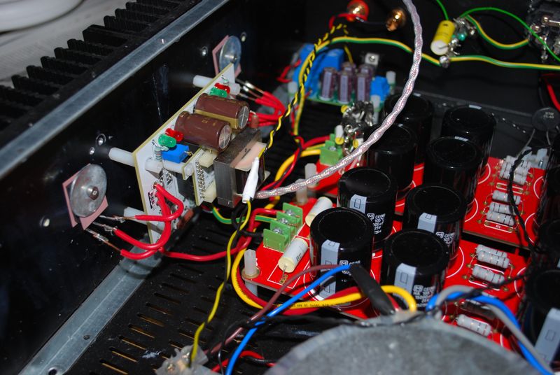

So I recently took delivery of some F6 PCBs from Tea-Bag. Firstly I must say that these are really fabulous boards!
They got stuffed the night that I got them and after a small break from building on Valentines I managed to get them up and running in my old F5/F2J case.
I have a touch of hum, but mainly because of the layout. The CRC boards are very close to the F6 boards which isn't ideal. The CRC boards are from my (long time dismantled) F5. I am going to change the PSU to something more compact so that I can separate the transformer and CRC boards from the F6 boards with some thick aluminium sheet with MuMetal shielding.
I also need to flip the heat sinks over in the case. The JFETs are mounted quite high on the heat sink. The tops of the sinks get pretty hot, while the bottom is only slightly warm. Hopefully flipping them will help dissipate the heat a bit better.
I am running conservative at 1.2A and have 0.05R source resistance in the bottom JFET.
The only problem that I have at the moment is a bit of channel imbalance, I think this is because I have 2 very well run in JFETs (pulled from the F2J) in one channel and 2 JFETs with only a few hours in the the other channel. Worst comes to the worst I can compensate for this.
So how does it sound - apart from the little bit of hum - fabulous. My F2J was warm and rich, maybe a bit too warm. The F6 is a little less voluptuous but (for now) my favourite so far....
I have attached a couple of pics, you can see how close the rectifiers are to the Cinemag xformers. This will be resolved!
